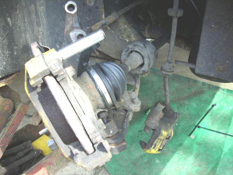

2. undo the nut securing the steering rack [track rod end] to the hub carrier
3. Undo the two bolts holding the suspension strut, I undid the strut at the top and took it off the car for better access

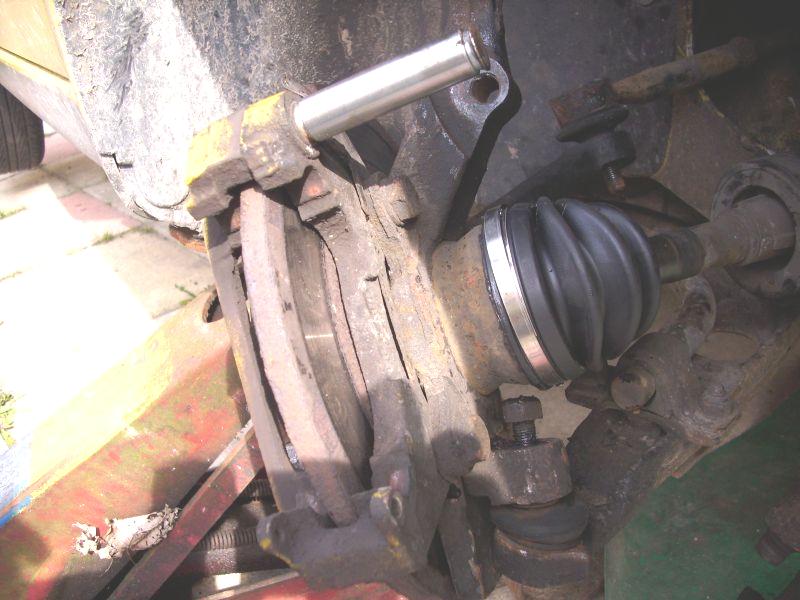

4. undo the brake caliper, either at its mountings or via the pin that would be removed for pad change
5. Undo bottom ball joint nut, the hub carrier and shaft will now be loose
6. Go under the car and undo/cut the clip off the inner cv boot large end
7. Pull entire hub carrier with shaft off car and take to bench

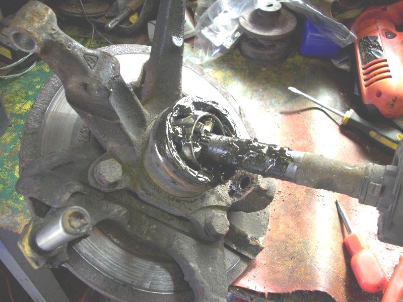

9. Clean away some of the grease to reveal a small circlip at the end of the splined shaft

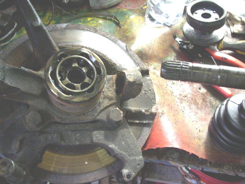

10. pop the circlip and the shaft will come free of the outer joint
11. clean up as much of the old grease now and make sure no dirt gets in, you can check the smoothness of the bearings by inserting a small bar into where the splined shaft came from, and wiggle it around a bit

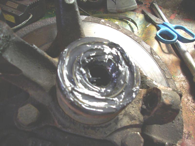

12. Put some of the new grease supplied with boot over the outer cv joint bearings

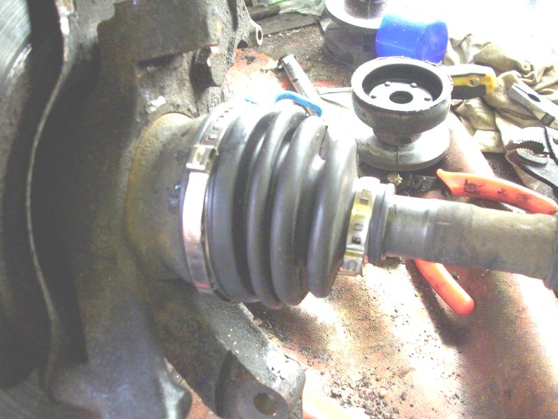

16. pull the boot back and slide the large end over the large part of the cv joint
17. Attach the clips, wrap round and pull one end with some pliers, you will see how they work they are quite simple, there is part on the clip that needs squeezing with some pliers [I used small mole grips] to allow the clip to tighten

9, Remove the old CV boot clips, remove the old boot parts then clean as much grease away from the joint as you can.
10, Remove the circlip from the end of the small shaft, and pull the outer CV joint away from the inner shaft
11, Slide the small end of the new boot over the small shaft, then use the grease included in the kit to cover the CV joint bearings etc
12, Push the small shaft back into the cv joint, and refit the circlip, make sure the grease is evenly distributed then pull the large part of the boot over the joint
13, Fit the new boot clips tightly
