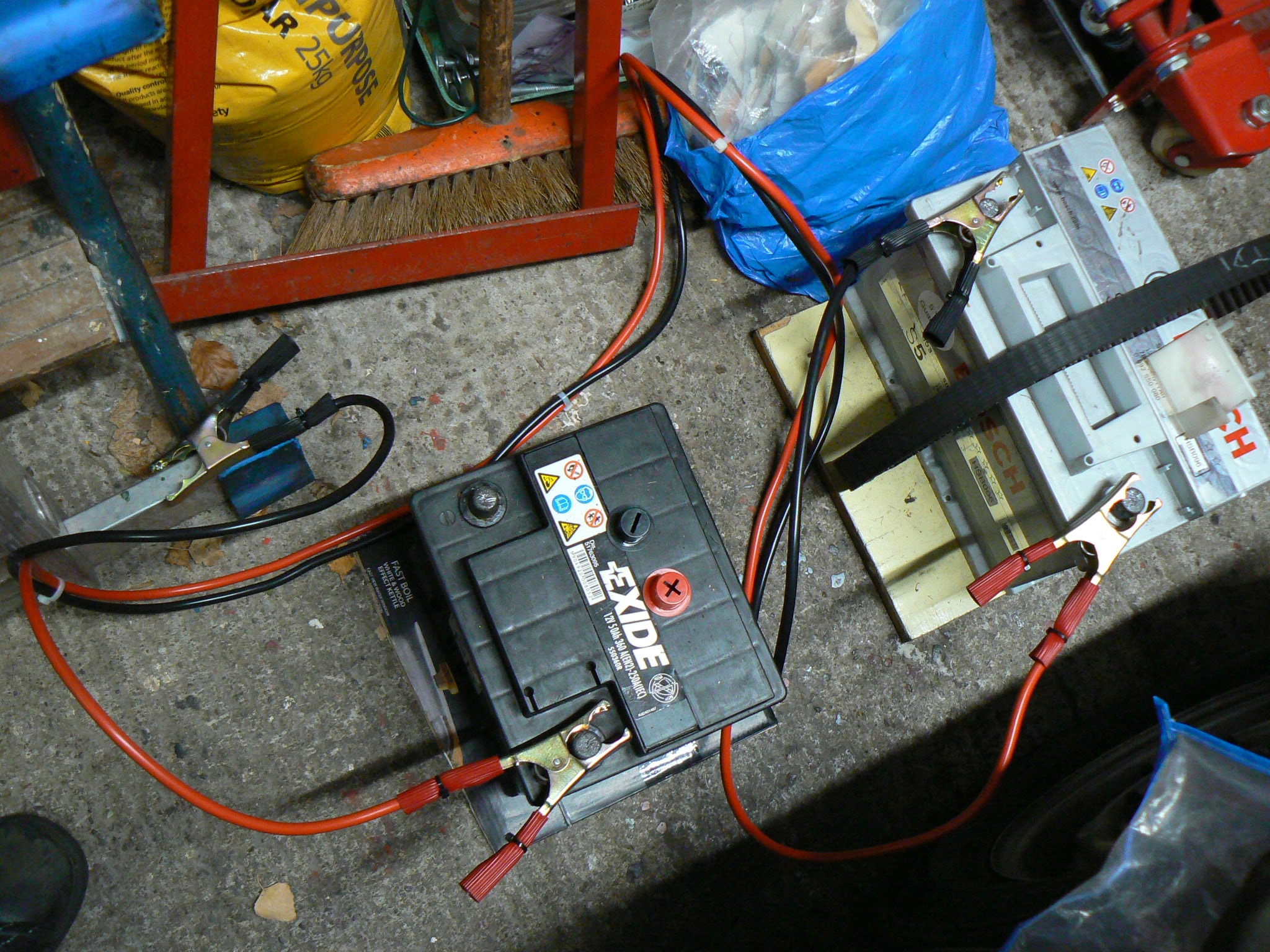

So how to make the connections? Well, let's imagine the the smaller black battery is actually in the car and is the "flat" battery. The larger battery is the fully charged Jump battery - but could as easily be a jump pack or other.
So, first thing is to connect the positive terminal on one battery to the positive terminal on the other using the red lead:
Take great care as you fit the first clamp not to let the clamp on the other end of the cable come into contact with anything metal. Give the clamps a slight "wiggle" as you fit them to make sure the connection is good electrically. Of course the battery in the car will have the car's cables connected and it's normal to just clamp over the connectors. If you do this carefully there's very little that can go wrong.
Next take one of the black cable clamps and connect it to the negative terminal of the jump (fully charged) battery but again be very careful to keep the clamp on the other end isolated:
Now you might think the next thing to do is connect the other end of the black lead to the negative terminal on the car's battery? But DON'T! Instead look for an exposed metal part of the engine or gearbox (some cars will have a dedicated earthing point specifically for this purpose so take a look in your manual. However earthing this clamp to the engine block or gearbox casing will be just as good a connecting point. Making this connection here does two things. Firstly, if there is a small spark as you make the connection, then it's away from the battery which may be emitting flammable gas. (batteries produce hydrogen and oxygen when charging and discharging) They have been known to explode with very unpleasant results! A spark is always possible because you're connecting a fully charged battery to a discharged one so current will flow. Secondly, connecting in this way will. in most cases, include the Battery Condition Monitor ( a small electronic sensor on the negative battery terminal usually) in the system created by connecting the jump battery - which protects it from damage.
Now you've got the two systems connected. Imagine the earth clamp on the left of this next picture is actually connected to the engine block/gearbox case or dedicated earth on the vehicle:
and, of course that neg terminal on the black battery would have the car's negative cable still connected to it. So the black battery, in the car, would have the car's original cables still connected to both positive and negative terminal posts.
Now, because I use that nice big jump battery which has considerable capacity, I like to leave the two connected together like this for a few minutes, around 3 or 4 is probably enough. What this does is uses the charge in the big jump battery to put a surface charge on the plates in the flat battery. This brief charging doesn't deplete the jump battery by very much but it does greatly reduce the draw of the flat battery on the jump battery so when you finally hit the starter motor, which is what you do now, there's going to be plenty of "juice" for the starter to "lunch" on. If it starts, which it now has every chance of doing if all that's wrong is that the vehicle's own battery is depleted, DON'T immediately disconnect the jump battery. Let it run with the jump battery connected for about 5 minutes. Whatever you do DON'T immediately disconnect the jump battery. If the car's own battery is very flat then suddenly letting the car's charging system "see" the flat battery might make it "spike" it's output in an effort to compensate for this sudden drop in what it's seeing from the battery and this might blow something electronic.
