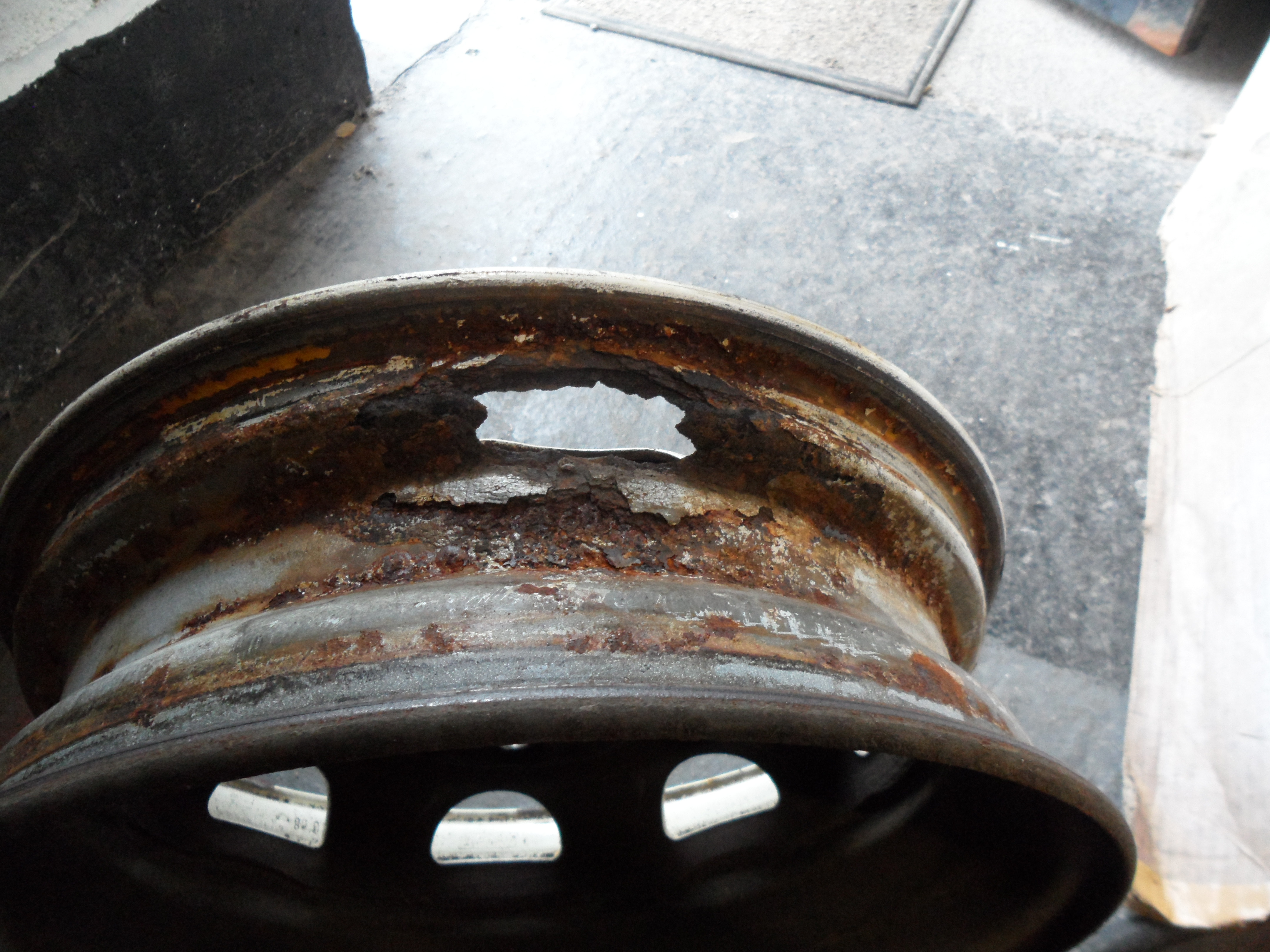

It came to me fitted with 165/80/13's, how they didn't foul anything I don't know. The tread was great but the side walls were badly cracked so they all had to be renewed. Gavin went for the same Nankang M&S's I used for Barbara's 4x4 (165/70/13's) as I found they were great around Scotland. The surprise came when I removed one of the old tyres. All wheels had tubes in bye the way......
As the valve pulled out of it's hole the wheel just crumbled!!!
The spare had the same problem but on a much much smaller scale. I was able to weld up and remake the hole on that one.
