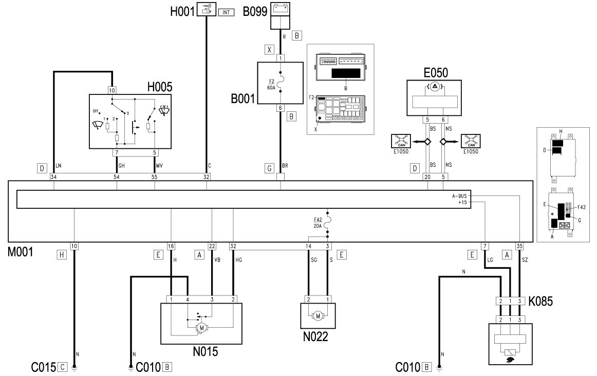

The "relay box" You're talking about is actually the Body Control Module (aka BCM) and is located under the dashboard behind/under the fuse board...
Crawl under you wheel, warp/wry yourself and you'll eventually get at it after loosing a couple of finger on sharpies steel parts, be careful! Disconnect the plugs and inspect for corrosion/moisture/pulled pin etc.
BRs, Bernie

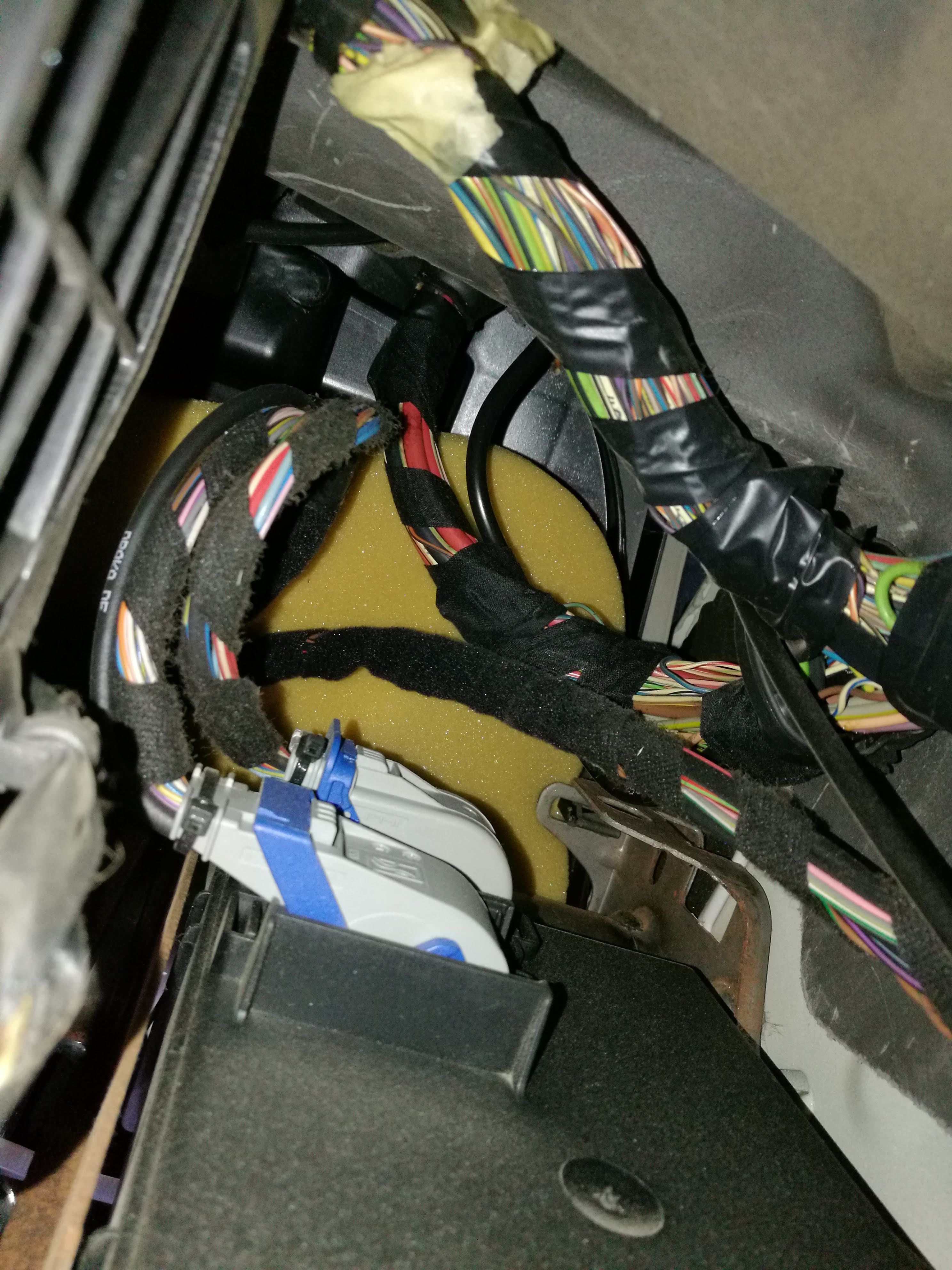

I went down under and I'm sad to say I didn't find anything. Behind the fuses is empty space (IMG1). When I engage the washer fluid squirt I can hear the relay in the fuse box (IMG2). Since that the only thing there am I to assume that this is the BCM? Googling the serial number does say that this is a "Comfort Control Module"
Am I on the right tack to diagnose the issue? Could it actually be the problem with the BCM? Because my car mechanic claims that the problem is the control handle that and wants almost 250 euros to fix it (which is almost 10% of what I paid for the whole car, seems a bit much) but my testing shows that the wiper speed control switch does indeed "switch". Could I be mistaken with testing?

I checked continuity and resistance measurements on the 3-pin connector coming out of the handle on the control unit as well as on the output pins on the control unit. Checked the continuity on the PCB traces.
I just got home so I'm going to disassemble and take out the control unit and check the voltage on those pins and see if I can possibly trigger the wipers manually.
Very good idea, mimic the stalk with a set of resistor/switches and see how the bcm respond ...
