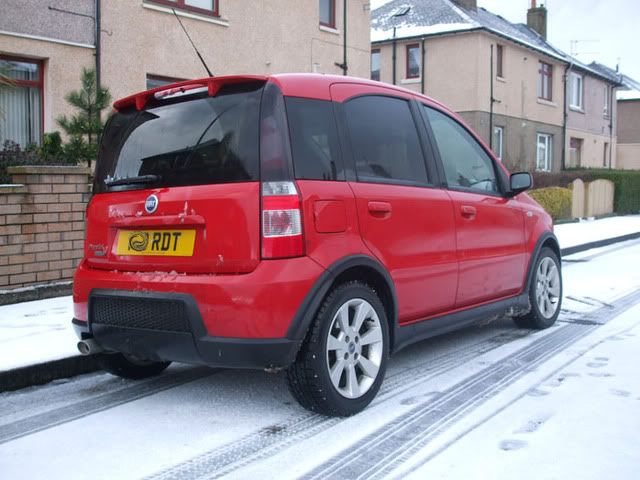

Further to the above post, I've now covered the best part of 1000 miles on the Snow Proxy's, and thought I'd post some impressions, especially given the icy conditions we've been experiencing over the past few weeks...
Firstly, they've massively improved the ride of the car - The car soaks up potholes and bumps far better...It's hardly Lexus-like in ride quality, but it makes it less tiring to drive long distances...
More importantly, in sub zero tempratures, the grip seems vastly improved over the Eagle F1's- I had noticed that if you were hamfisted with the throttle at low speeds, in cold / wet conditions, it would easily spin up an unloaded wheel...This trait seems less prevalent now...
Of course, there is a downside...The handling suffers in the dry...I drove 'enthusiastically' down a lightly traffic'd back road, I know well - It's either soft sidewalls, or tread block shift, but the car isn't as sure footed as before...I'm running them at 30PSI, so might bump that up a bit...No great shakes, and it was easy enough to adapt to the change...
Also, the car loses its 'squat' sporty stance, as the Snow Proxys are higher profile...Just spoils the looks ever so slightly...
I'll keep an eye on wear rate, but they'll be coming off in March, so hopefully get a few years out of them...Are they necessary? Hmmm - If the Panda had a good treaded summer tyre as standard, I probably wouldn't have bothered...But the Eagle F1's have no radial tread, and are pretty poor in the snow and ice...It's my only car at the moment, and I depend on it to get me to Aberdeen for work etc...
With that in mind, a £160 investment isn't too bad, given I've spent much more on track day tyres for previous cars, which have lasted a couple of thousand miles... :D

Came in handy today...:D
Fluoxtine, have you tinted the top half of your rear lights?
Hmmm...I hadn't noticed till you pointed that out, but they do seem to be tinted...:confused:
(Had noticed that the front indicator bulbs had been changed to the 'non orange' variety...)
Not me - I bought the car from a main dealer secondhand...
