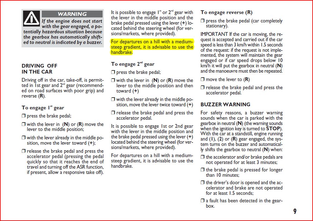

It's not an Auto, it's a "Robotised manual" with all the traits of a manual gearbox- clutch and H-pattern gearbox components, all operated by hydraulics which provide a semi-auto action.
The 500 Dualogic Owner's guide even states the handbrake should be used where necessary on steeper gradients. Many people complain that the Hill Holder 2 sec delay is too long already, so extending it would cause Fiat Technical/Bosch more grief. :)
