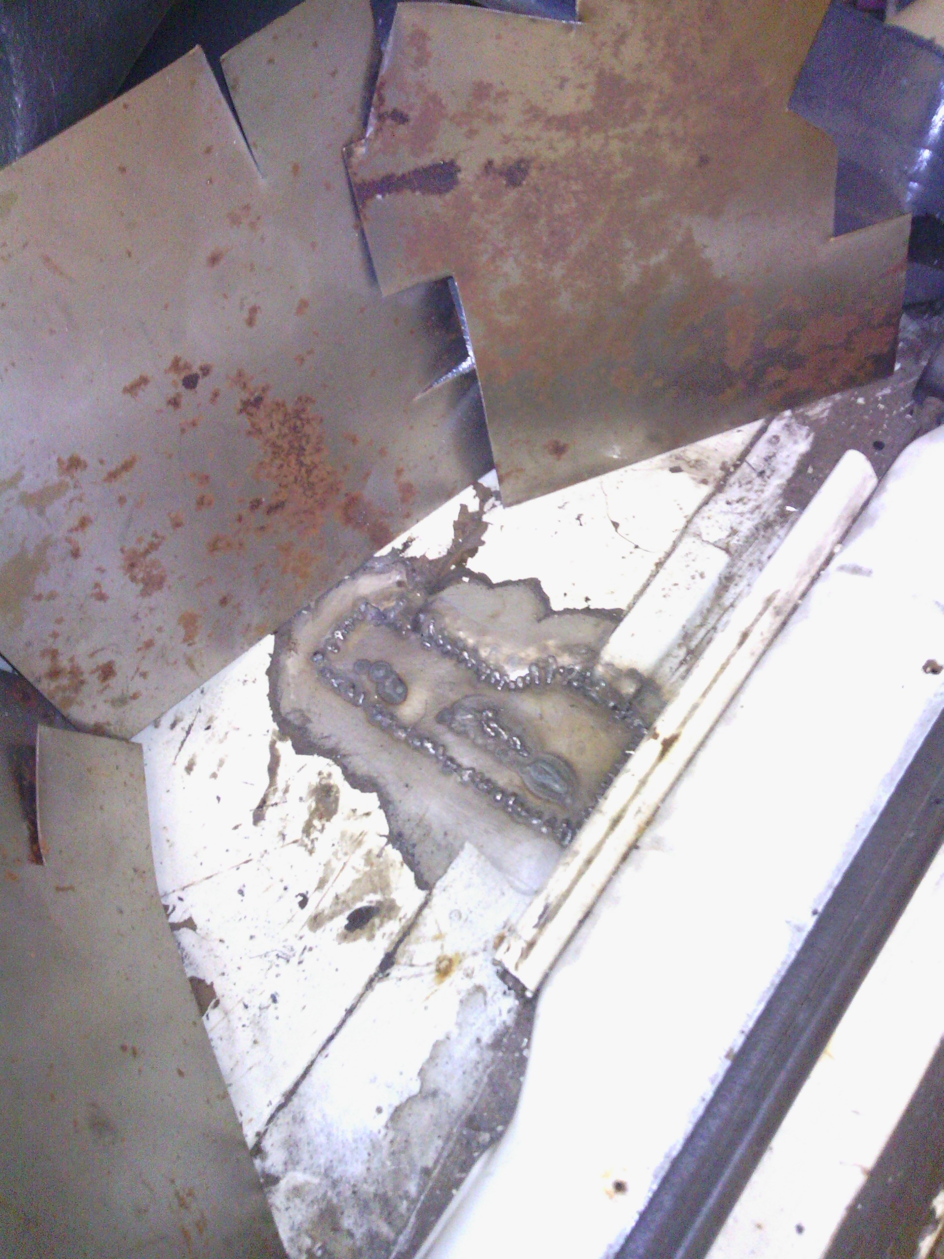

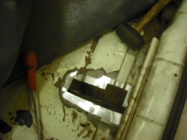

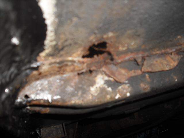

More cutty cutty / weldy weldy as they say on Retro Rides. Got it an MOT pass :D and 15 advisories :shrug:

Another year then. Plenty welding practice you're getting there! Anything major on the advisory list?
Its good fun welding. Id be bored if it had none to do! lol. Advisories were mostly boring stuff lke "sills painted and sealed" & brake pedal rubber worn. One odd thing was "front seats insecure" I think that something I missed a fail on by a matter of days as the new rules about front seats were about to stop being advisory. But I cant figure out what they are on about. They dont 'move' if you just try to force them backwards and forwards unless you use the pull up bar under the seat. The backs of the seats will flex back a bit I suppose if you force yourself back against them but no more than usual. I should have asked but i was overjoyed just to get a pass.

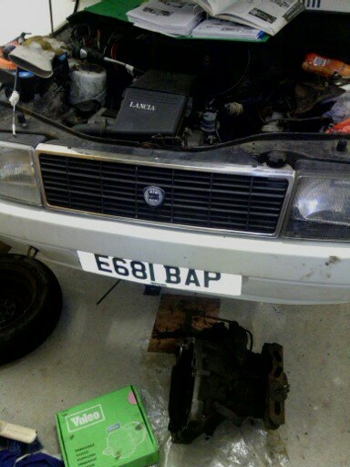

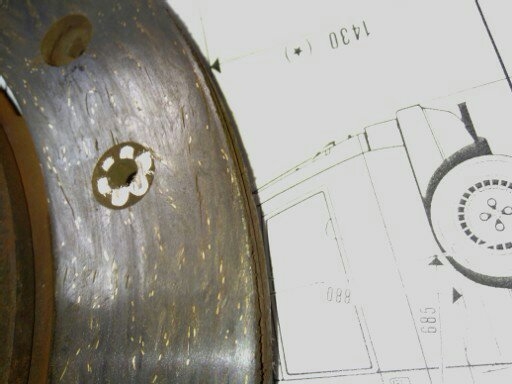

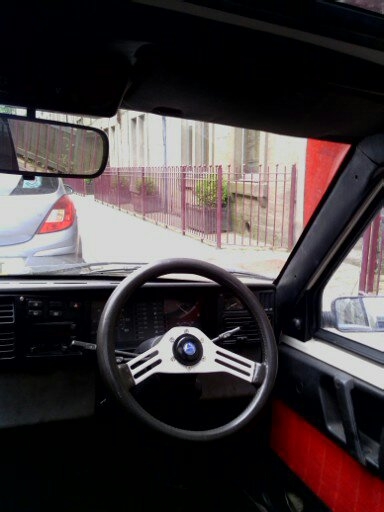

No worries, Novas have done Iron Oxide Harikiri now. Done a bit more work. A new clutch which was 'interesting' to fit, and a new steering wheel. As one of the pics shows the old clutch was pretty gazeboed. Down to the rivets.

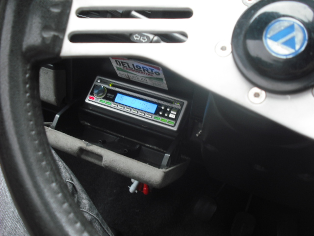

Also fitted a Head Unit. The Hen has picked up the hilariously entertaining trick of flashing its handbrake warning light in time to the music.
