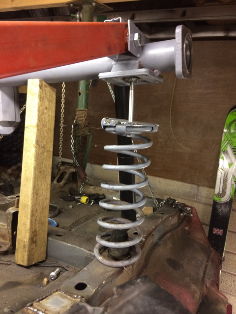

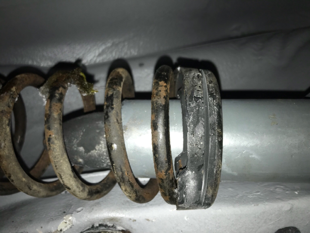

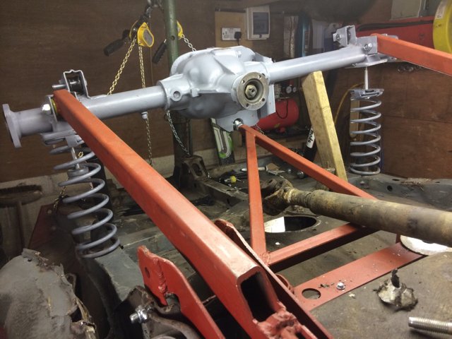

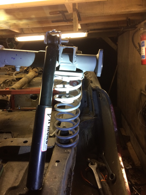

Finalised how it all works shocks now fitted 13” -22” shockers fitted used, cut down front springs. With telescopic spring locators to give 80mm extra Axel travel. IMG_9689.JPG

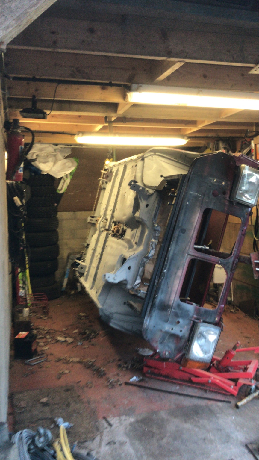

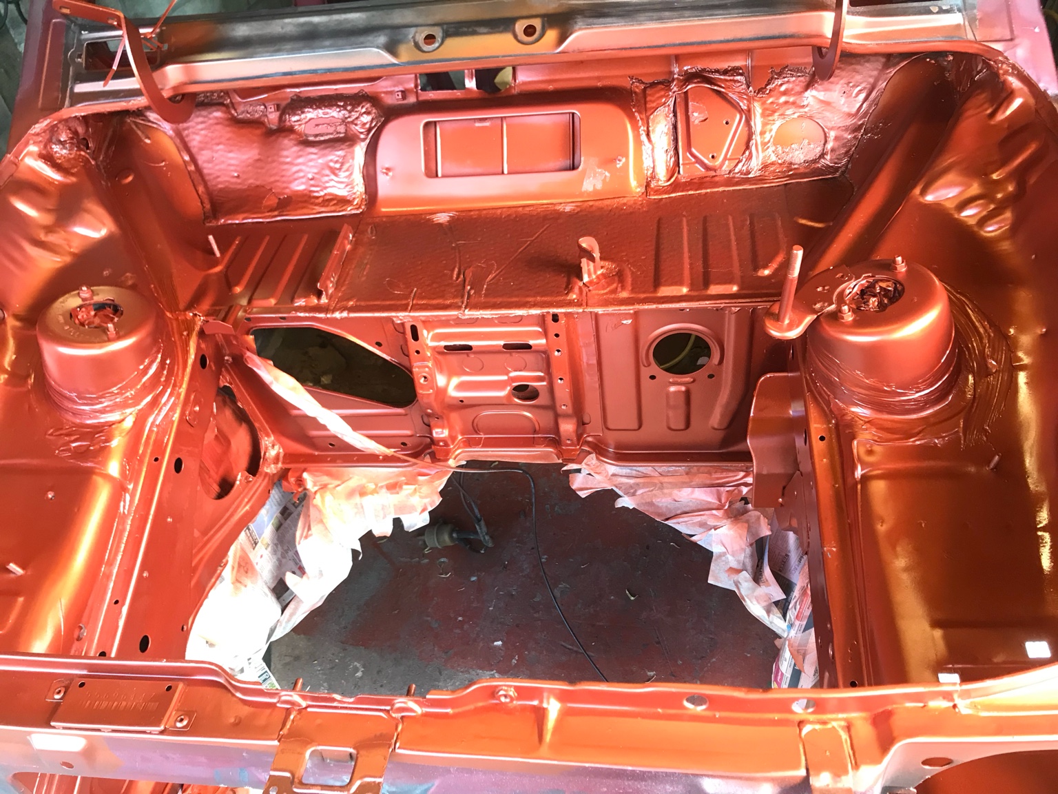

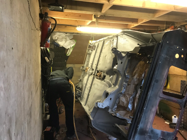

Floor pan completed welding

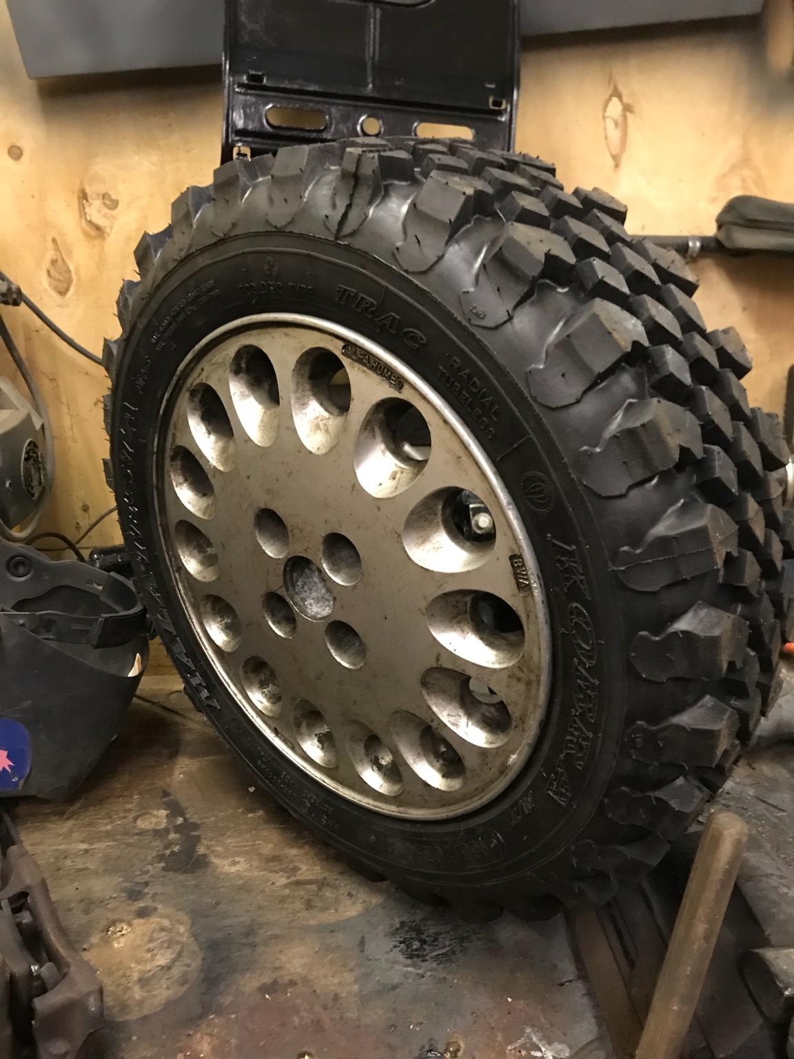

Tyre and wheel combo built up tonight. Tyre iron and fairy. Liquid Image1517776871.978952.jpg

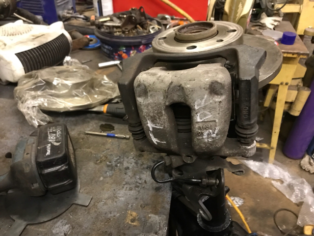

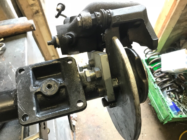

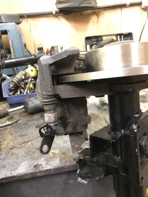

Interface plates. Have now been fitted with home made backing plates.
Awaiting. M12x1.5 bolts. Then on to the spring hangers/ cups / bases

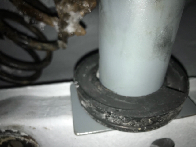

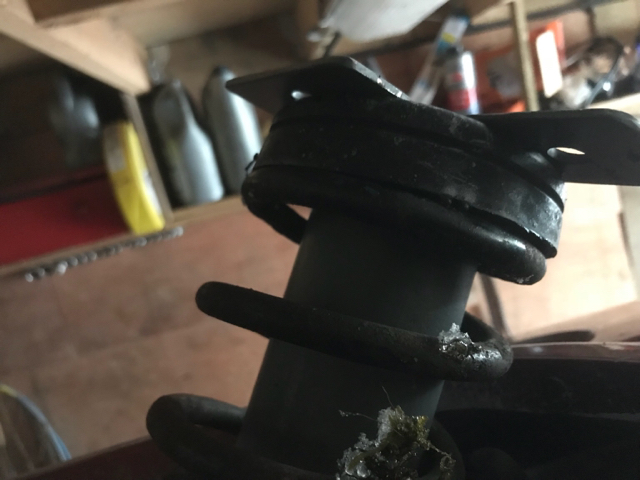

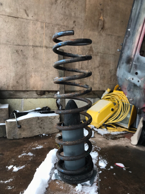

Spring locators now made up the rubber bump coil. Is a febi 170800 £4.50 each and a perfect fit

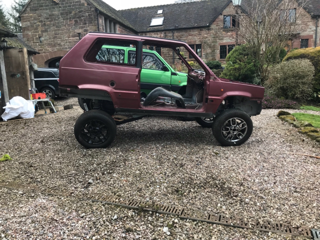

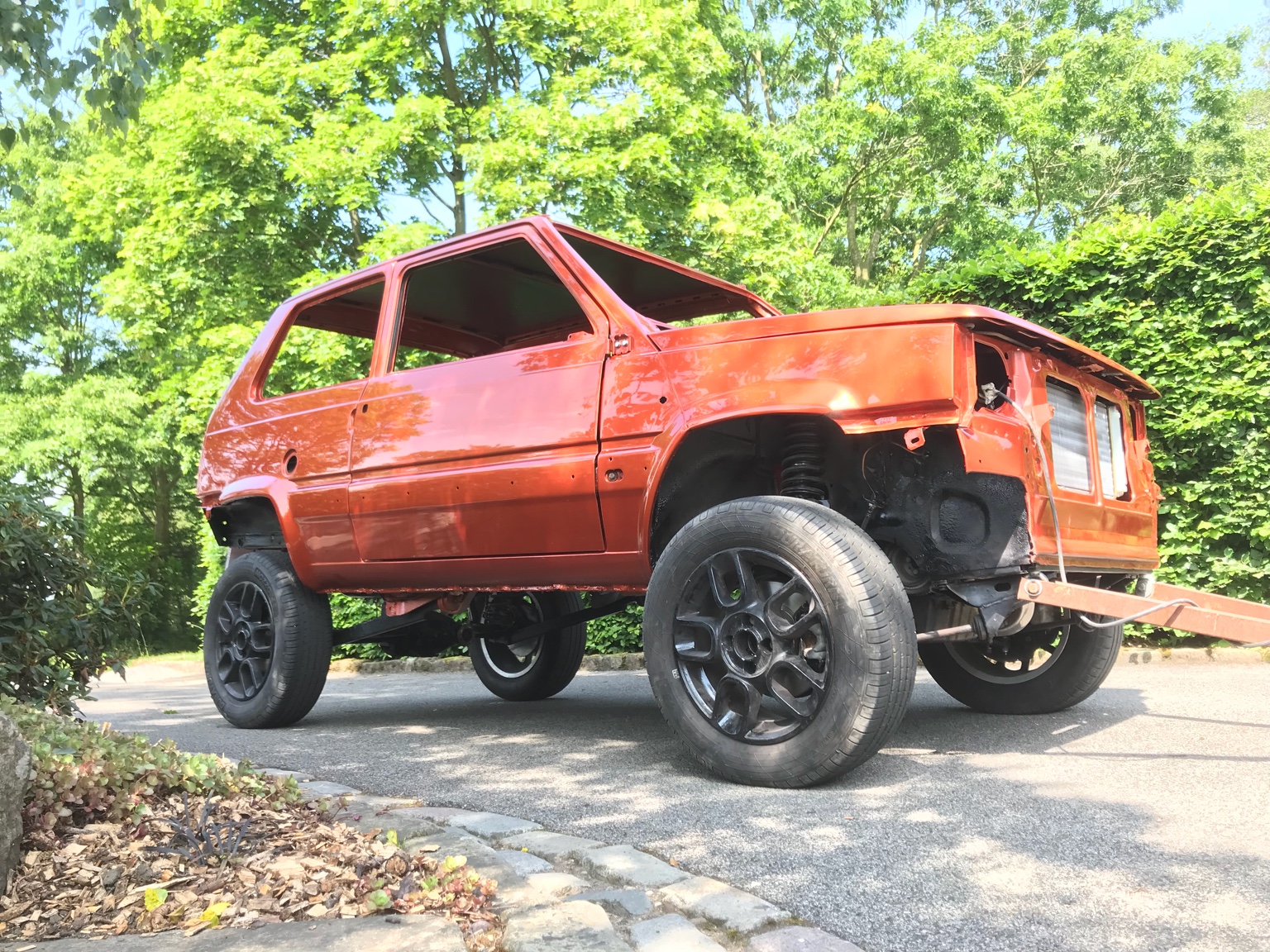

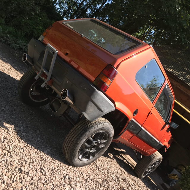

On the wheels today. It’s looking good too

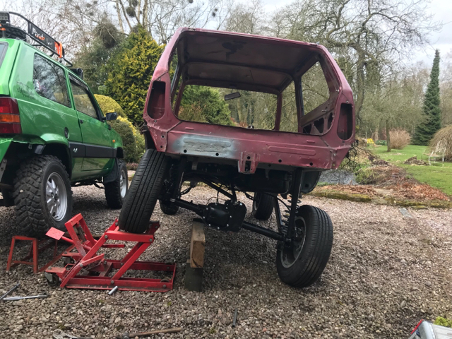

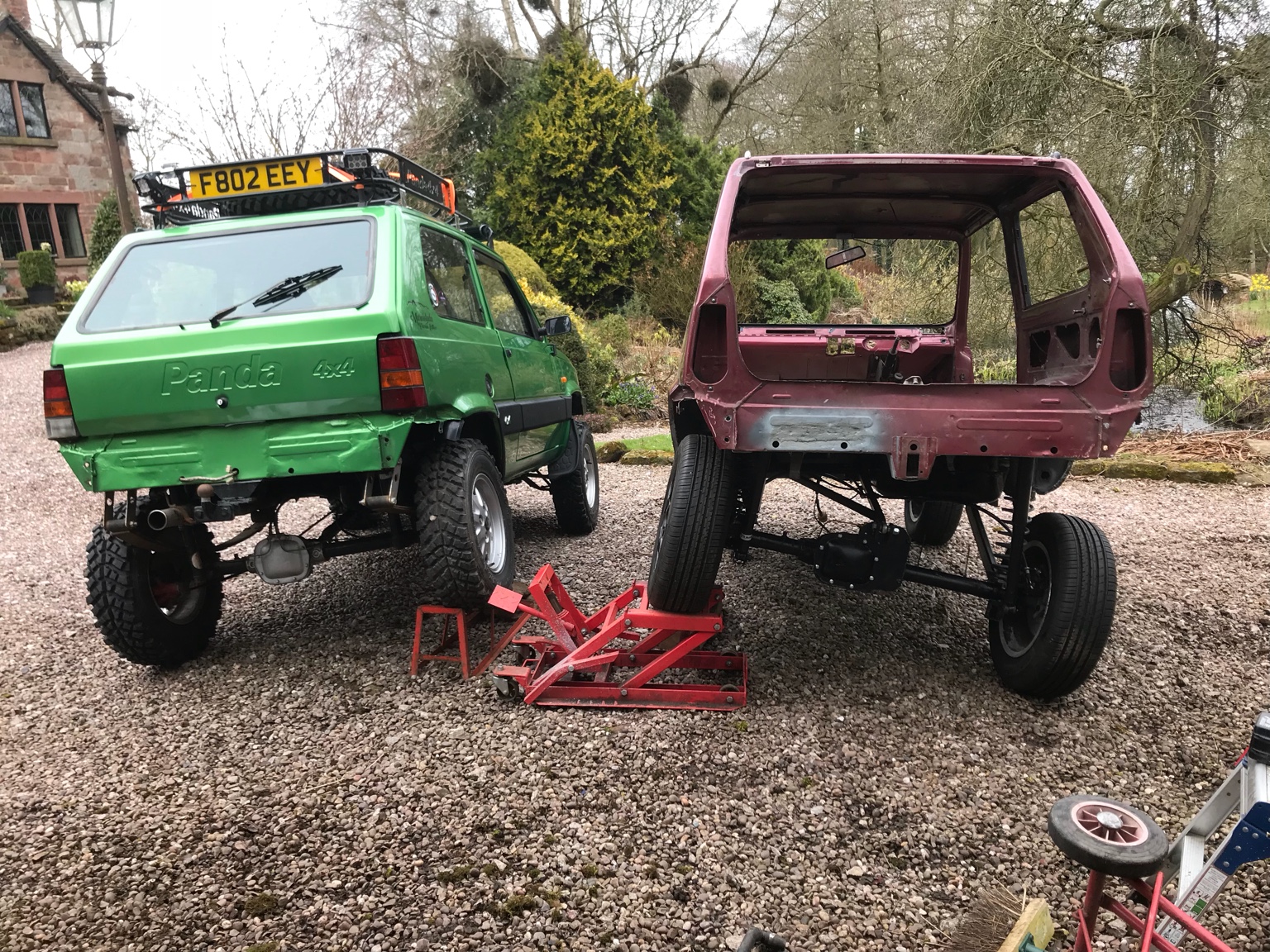

loads of articulation the. Green pandas wheel has no traction but magenta at a far greater height still has both wheels on the ground.
Note how magenta is level at the rear tail gate
Then Brian is twisting towards the lower wheel (Result far less body stress )

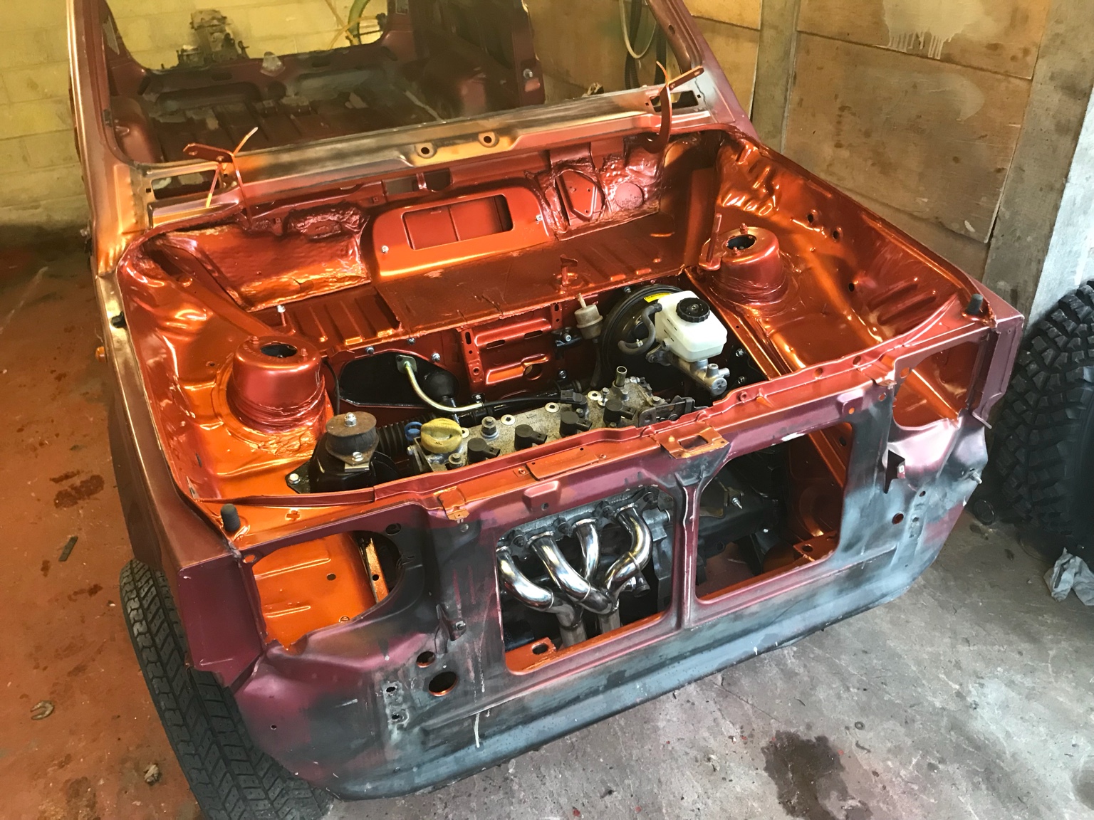

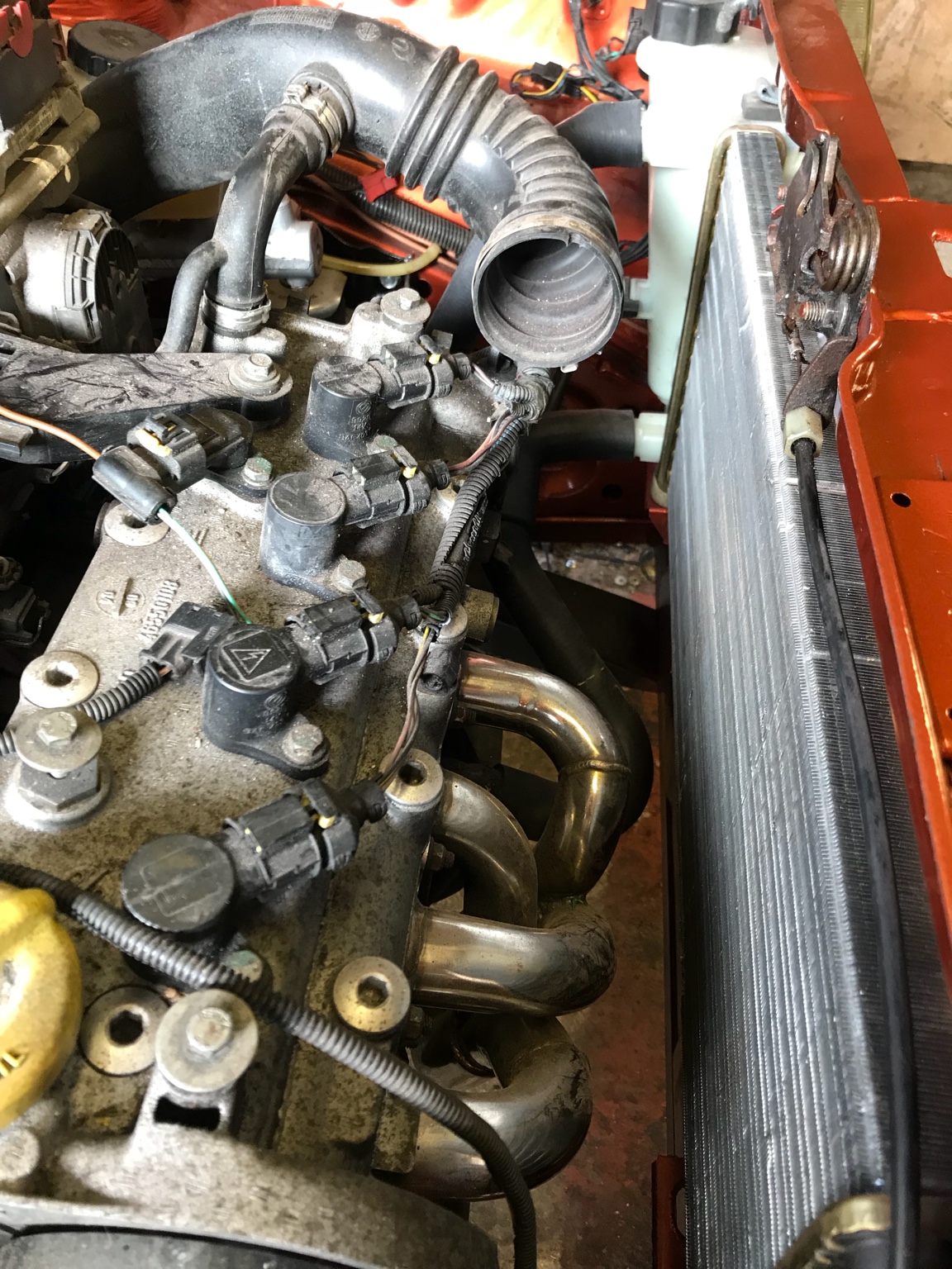

Engine 1.4 -16v Punto sporting. Lexus 11” servo. Now fitted looking. Let’s say different

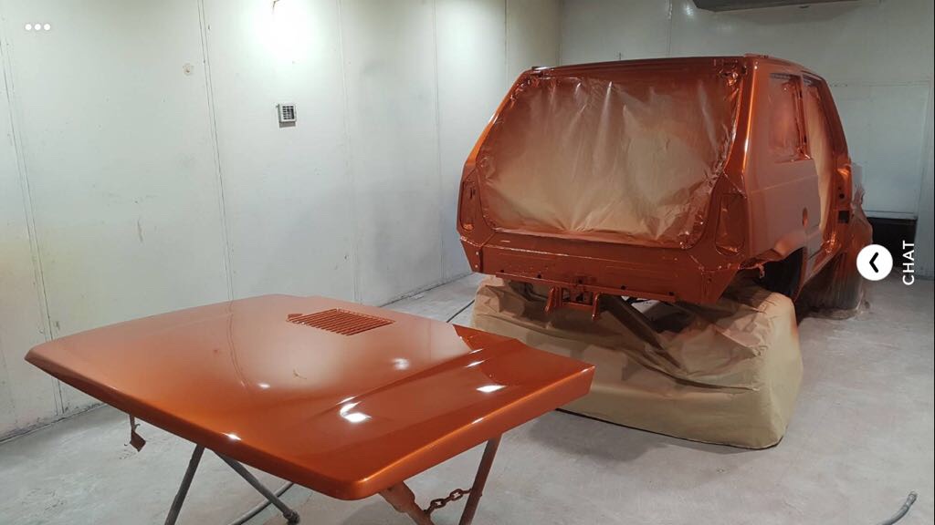

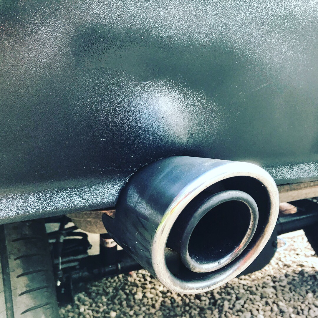

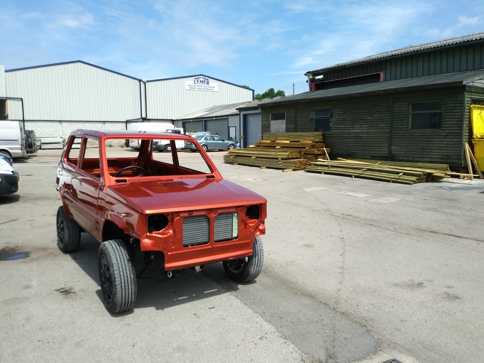

Slow progress I’ve had a holiday. Now Adams away for 3 weeks. But working from the rear most things are done engine test and the bumpers fit and some bling stuff to do. Decide to give Magenta the type and model
Sisley4x4 GT 100
Few photos below.
