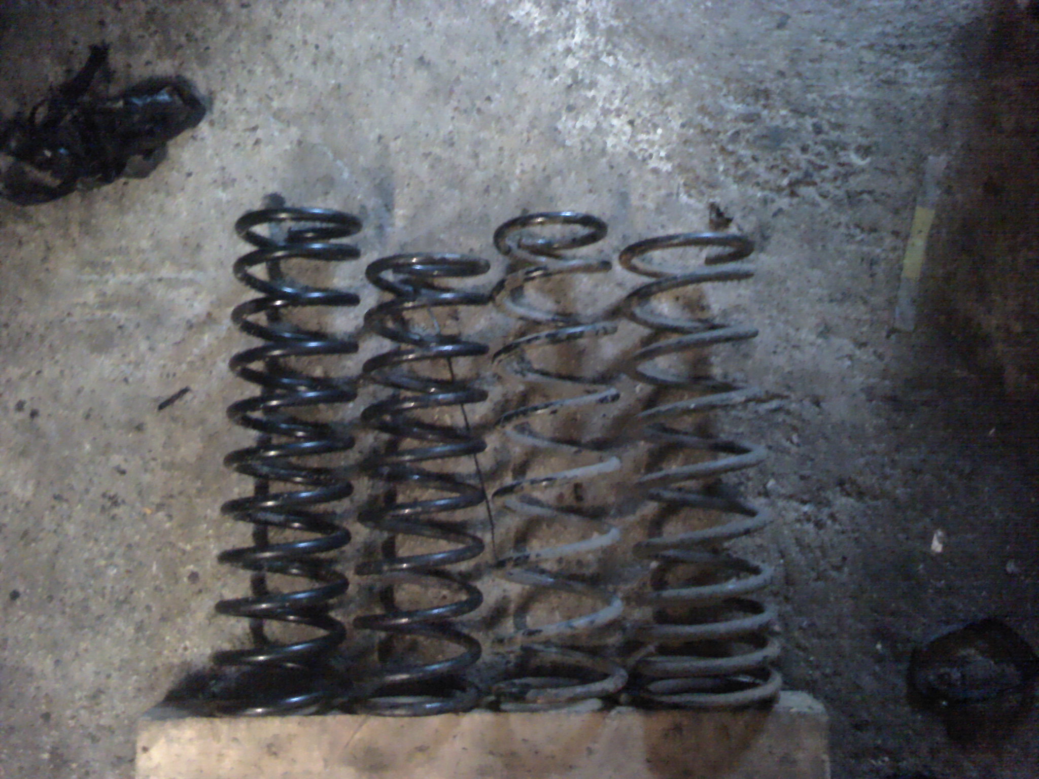

CityRover rear coils are 114mm OD iirc, first from right vs. front 4x4 coils second from left.
They are dual rate sprong which might be even better for your application.
Where chopped to suit 2wd rear, clearly can see that the softer rate section is almost closed .

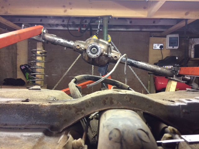

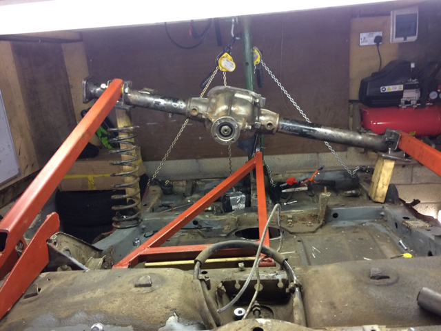

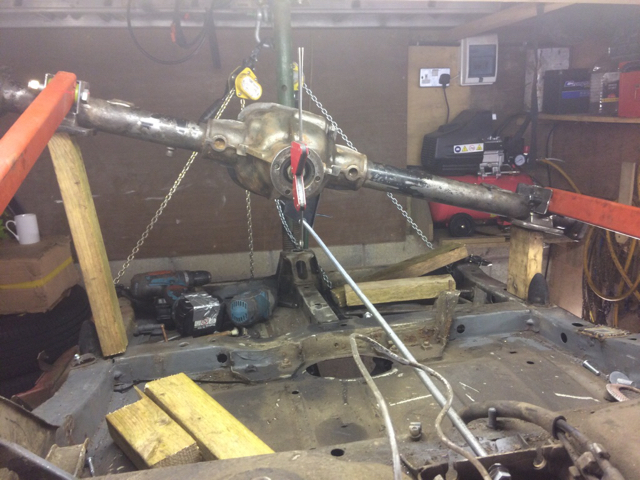

Today got on with the rear suspension set
Up both trailing arms now complete and connection made to the rear Axel

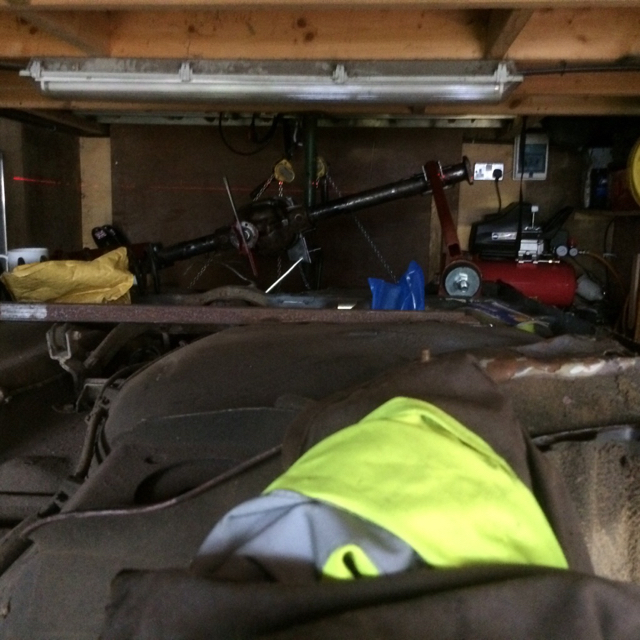

To judge the extent of travel in all positions and effects on IMG_1507993503.263614.jpgthe U.J. Connection blocks of wood cut
1 fully compressed spring
2 spring @ 80% preload
3 at full extent + 50mm overtavel

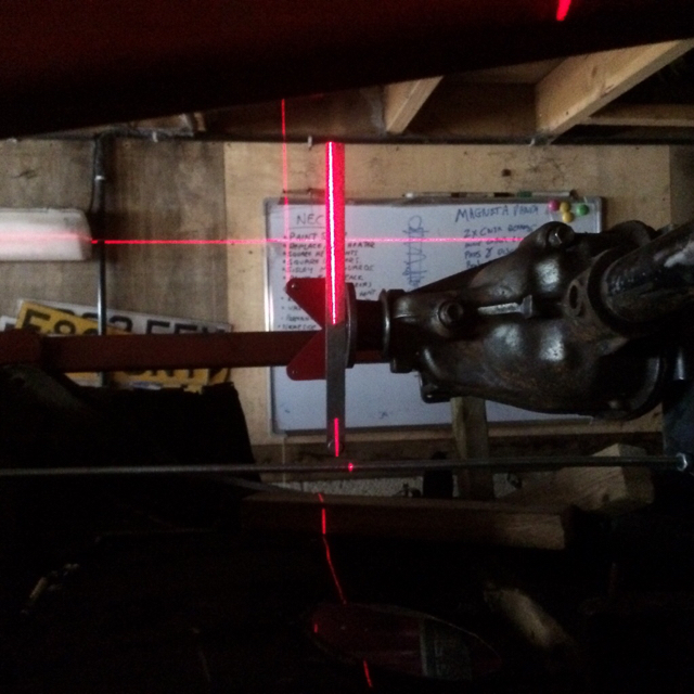

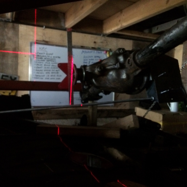

A laser was set up to read the effect on the flange
IMG_1507993535.618766.jpgIMG_1507993547.079721.jpgIMG_1507993558.200678.jpgIMG_1507993569.447719.jpgIMG_1507993633.027729.jpg
Looking good on articulation now but
Practical test will show up problems
Third link now made up ready for fitting .
To judge the extent of travel in all positions and effects on View attachment 185057the U.J. Connection blocks of wood cut
View attachment 185058View attachment 185059View attachment 185060View attachment 185061View attachment 185062

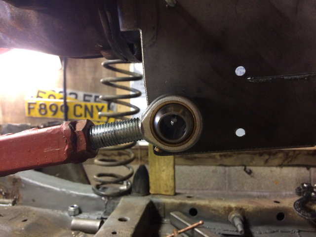

Here shown the fourth link. In placeyIMG_1507996872.967745.jpgIMG_1507996890.131940.jpgIMG_1507996913.156753.jpgIMG_1507996942.743288.jpg
Connections to be desgined then made up and fitted Brian set up to be used.at the front

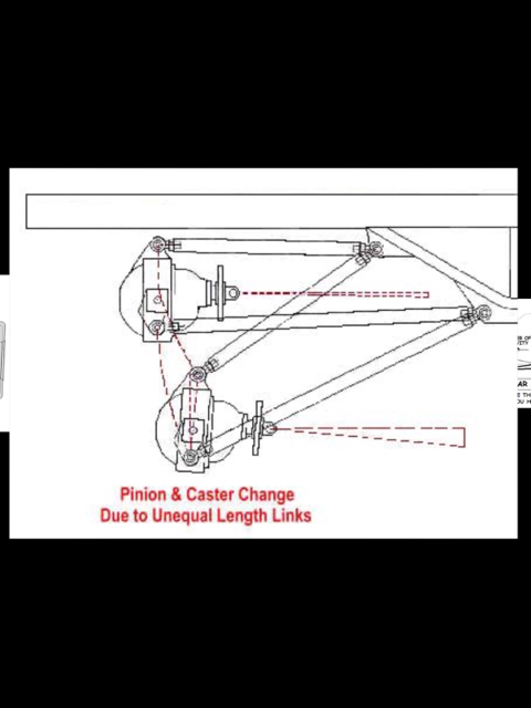

Now I am no engineer but does the central location of the read diff not cause problems? And I know that for the travel you are after and the width of a panda a panhard rod is out. What about some variant of a Peaucellier–Lipkin linkage
Well that’s a big name
I will have to google that. Liam when the attachments are fitted all problems may show themselves at the present it’s pretty favourable with the present set up But who knows ???? Google now !

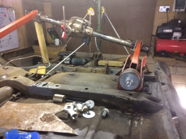

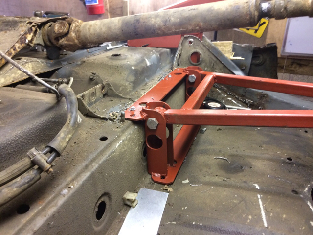

Links have now been made up and the body connection IMG_1508083439.928204.jpg
Temporary position seems to be spot on at the diff IMG_1508083488.167742.jpg
Articulation of 300 mm wheel centre to the wheel arch bottomed one side to furthest travel opposite wheel 700mm
Not sure wether this would be the maximum possible but pretty happy with it. The prop shaft turns freely in all positions except
Both wheels at full spring length and an additional 70mm of over travel This occurrence would only occur if fully airborne or body see sawing on a obstruction. Rare I guess .

Links have now been made up and the body connection View attachment 185082
Temporary position seems to be spot on at the diff View attachment 185083

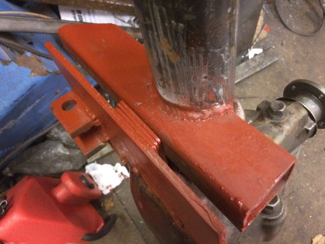

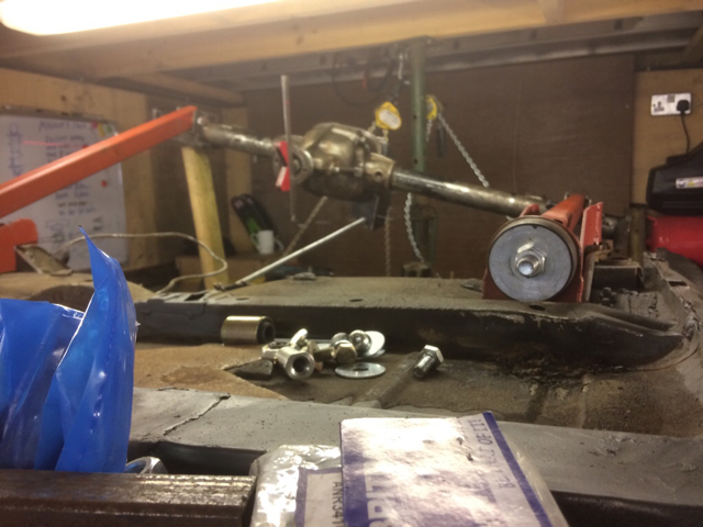

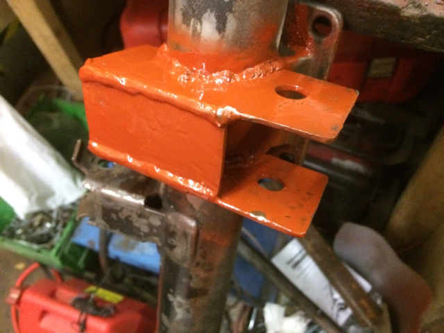

Fabricating the fulcrum point today for the rear Axel bolted to the diff bolts and then welded a bracket to the tube of the Axel
50 hrs
Here’s the pics
IMG_1508784316.710980.jpgIMG_1508784337.929167.jpgfulcrum point attachment plate for the rose joint
Connections for the swing arms

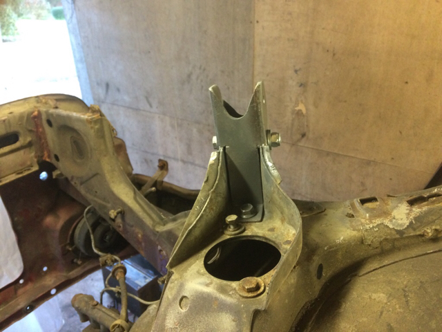

It’s been a little slow this weekend a bit of garden work and fixes around the house ,
but have managed to fit the swing arm lowering adaptor stuck with the 50 mm lift here the same as BFG
Next job will be to make the longer engine mounts -50mm
Longer gear box mount _50mm
Rear gearbox. Mount -50mm
Add 25 x50 box section to the

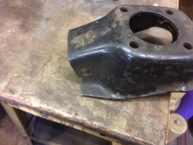

Had a rethink on the shock mods as we did to panda Brian BFG thread 3 sisley s
Instead of making parts to bolt around and clamp this time decided to add a cut off section from an old ball joint housing then weld in place
Note 2wd & 4wd housings are identical except for the holes 12 mm not 10mm IMG_9582.JPG
