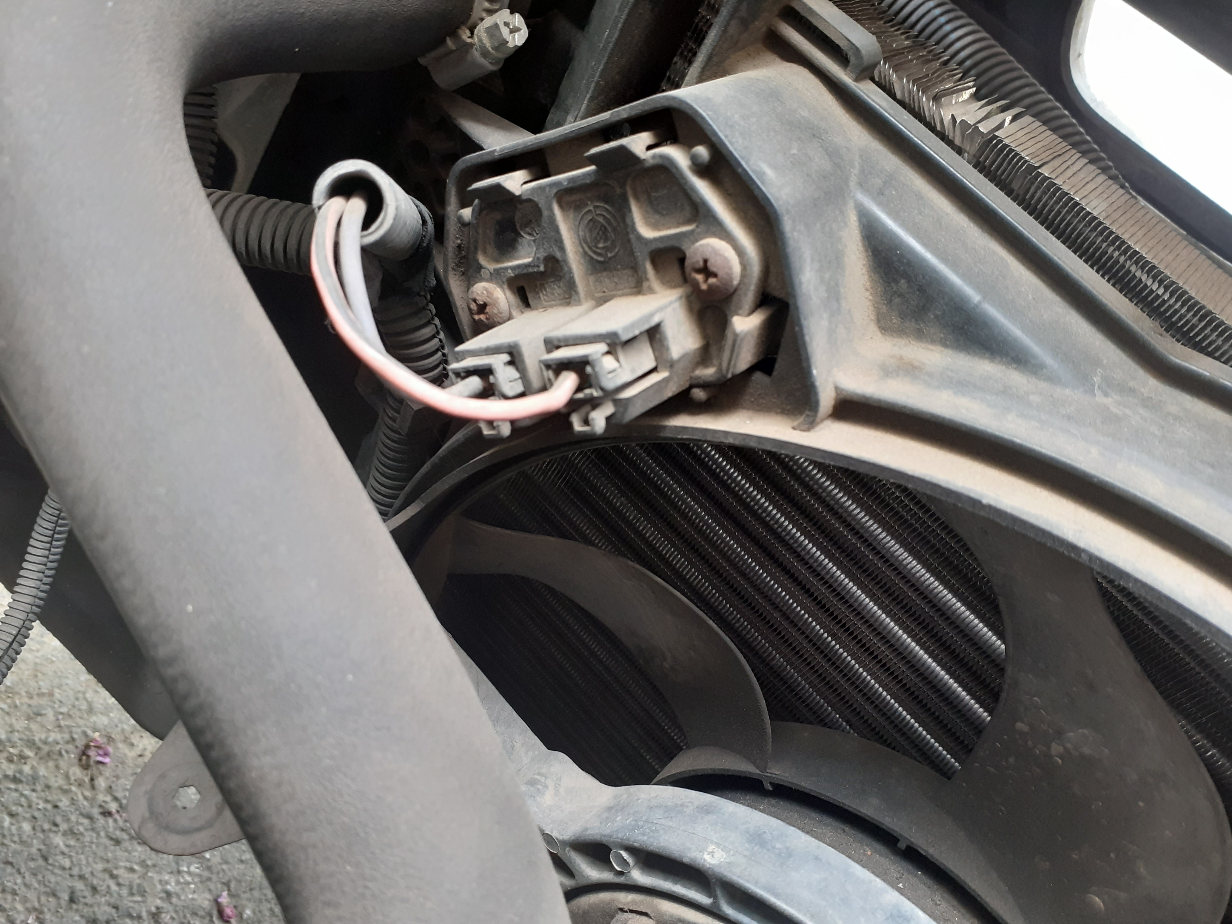

Have you solved it? The thermic resistance with the fan could be burned. If so, the fan only kicks in on 2nd gear when the engine temperature and the cooling system pressure are a little bit over normal values. The fan working on 2nd gear is louder and it runs for little periods of time, keeps going on for a little bit then off again.
The thermic resistance is located on the fan right under where electrical cables are connected. I put a pic, you have to take out those 2 screws and you can access it.
Kind of, so I took the fan out and cleaned it with brake cleaner, even cleaned the plugs. For a few weeks it was fine but the noise came back but quieter compared to what was in the video. So possibly just need a new fan.
The resistance that you showed, I don't have that, it's just a block of plastic which I would of assumed would of been where that should have been located there.
