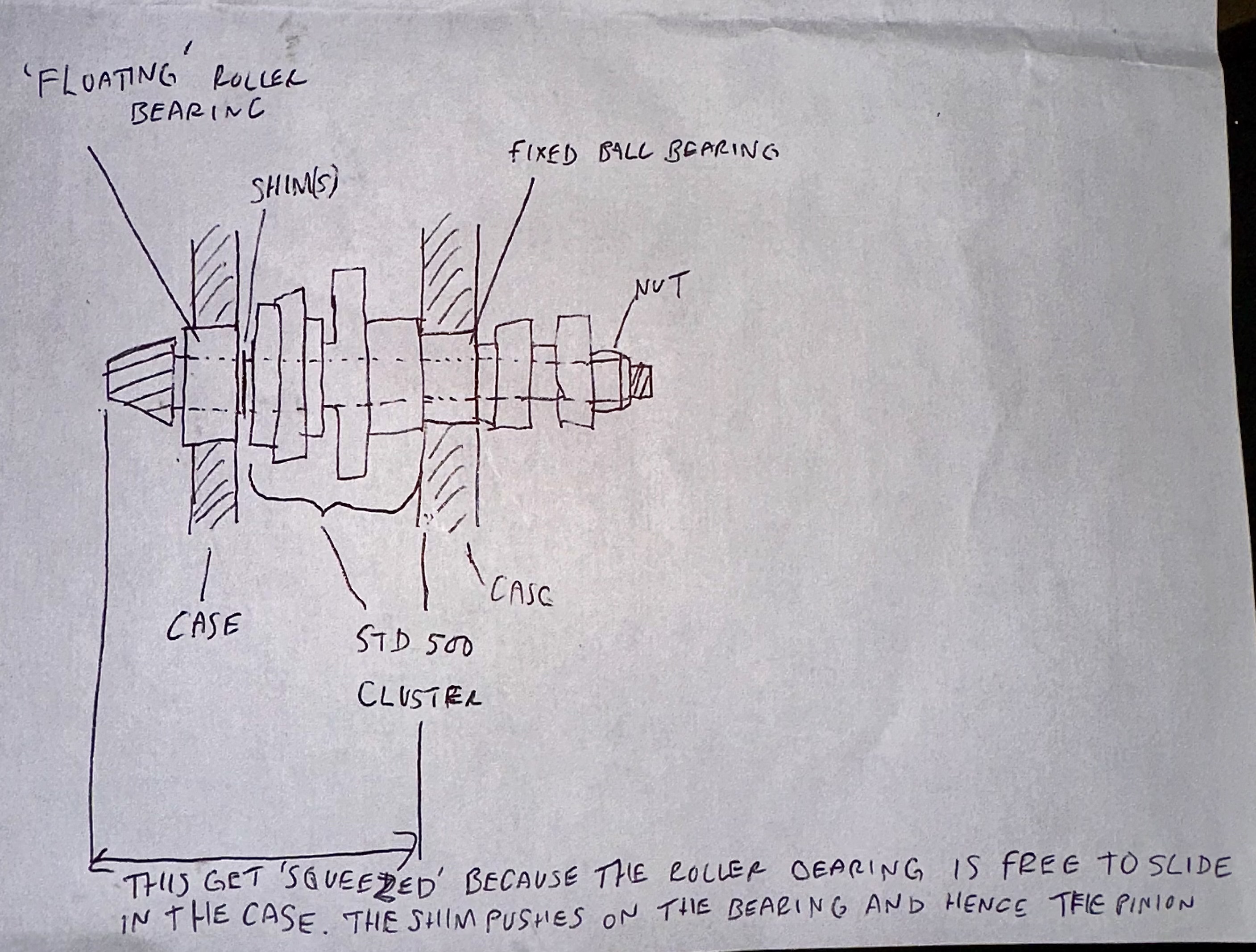

I have attached a quick sketch of the principle I'm working from. Once the shaft is assembled and the locknut is tight, and trapping the gears and bushing on the external part of the box, the shaft can't move backwards because it is tight up to the centre race of the ball bearing, and a screwplate locates that bearing. It can't move forwards because of the lip recess machined in the box casing.
Therefore, the as the distance occupied by those gears etc increases, the pinion gear is pulled further away from the crownwheel centreline. As the distance decreases, the pinion is pushed nearer to the centreline. It doesn't alter the fact that with the internal gears being a fixed length, something would have to fit the gap created behind the pinion.

Thanks for this stuff, really great as it got me thinking. As the thing is in front of me I can see the nuances, so also with a sketch I’ll try to explain what’s going on as it is a devil to get your head around.
What happens with the components right hand side of the case isn’t relevant. The floating bearing has no lip in the casing so the protrusion of the pinion is dictated by the bearing, shim and cluster as a single block. But the cluster always stays locked against the ball bearing on the right hand side.
By adding a shim between the cluster and the roller bearing, it pushes the roller bearing and hence the pinion further to the left.

So, if you put a (say) 6mm shim behind the roller bearing, the pinion would move out 6mm. But when tightened, the nut would be 6mm further towards the end of the thread, and maybe beyond alignment with the split pin.
Equally, if 6mm was removed from somewhere on the end cluster, and the nut tightened, the plnion would move out by the same amount. But there would then be a gap allowing the roller bearing to move back and forth.

Correct on the spacer behind the roller bearing, but although the pinion would be where it needs to be in relation to the crown, the bearing housing would be half way out the alloy casing ….. unless I deployed my (crazy?!) idea of putting the spacer between the pinion gear and bearing.
You’re equally right about the split pin, I’d need to drill a new hole as per Andrew’s experience with this spacer either way. Because my split pin is fine where it is it does beg some questions vs Andrew’s install, but my kit is by a different manufacturer.

Correct principles in all respects, but not all the details match the gearbox of the 500/126.; I would use the Haynes or similar.
If the positions of the rings that adjust the mesh of the crownwheel/pinion have not been moved, and if you trust them having been correct at the start, I would leave it alone. Setting that up is very fiddly,and you do need a dial gauge. and probably a metal frame or jig to hold the box.
The principle is simple, but operation hard. You wll be using the castellated rings by tightening one,and loosening the other by the same amount repeatedly until the mesh is correct. Then you will be tightening or loosening both of them equally until the correct preload has been achieved.

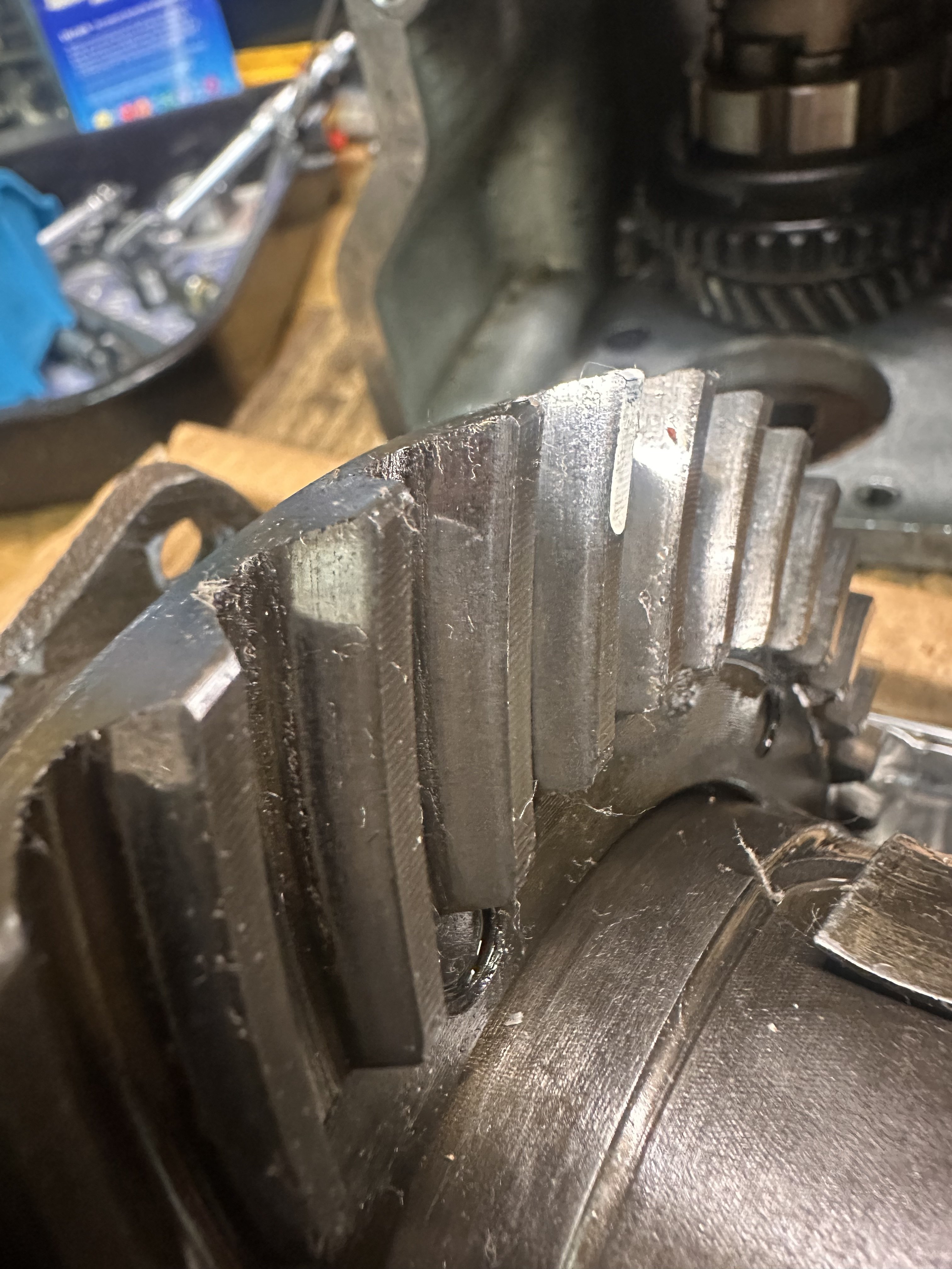

The crownwheel has suffered a bit but this wasn’t just by the lockup this has been over a bit of time (see pic). The pinion doesn’t have any corresponding markings though.
I’ve determined what pinion shims I need, with none inserted the pinion needs to come out by 1.25mm to have a central contact position with the crownwheel so I’ve ordered plenty of shims to add to the few I’ve got as I expect there to be some fine tuning to that figure.

Blimey that’s a turn up isn’t it, a spacer behind the pinion?! I thought it was a bit matto because I hadn’t seen it done before but there you go, thanks for sharing. If I do end up further inwards with the pinion that it currently appears one thing I noticed with my test washer was it was larger on the OD and would restrict oil flow, so if I do go down that route it needs to be the std 32mm OD. Wish I had a lathe, so many little projects on the go where I need to turn parts, oh well, no space or funds🥺
