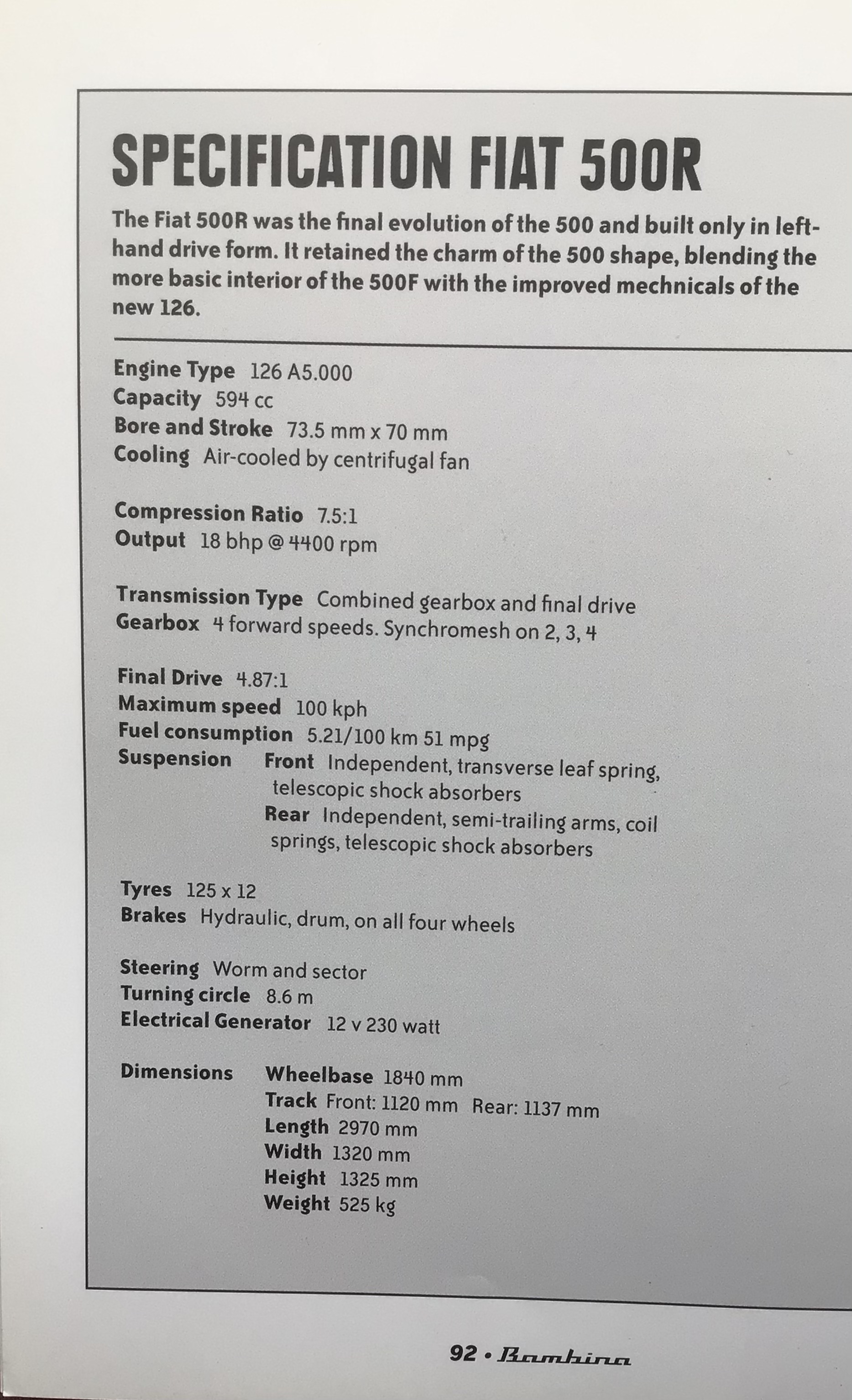

Not a lot of written evidence about the 500R with the absence of a dedicated manual of any sort. I looked in my copy of Todd Niall’s NZ Bambina book and he shows this spec.
Maybe cars for NZ had the 126 box. It's not uncommon for different territories to get different specs of car.
Yes that may be possible but unlikely I would think as only a little over 100 Fiat 500R cars made it to NZ as opposed to the earlier models that were part assembled there and all had the original non synchro box.

Looking for other details in the book, "La Guida", that was given to me some years ao by a generous forum member, I came across the sentence, "The 500R remained quick-engaging, but not yet synchronized".
But that was over fifty years ago and anything could have happened since.
