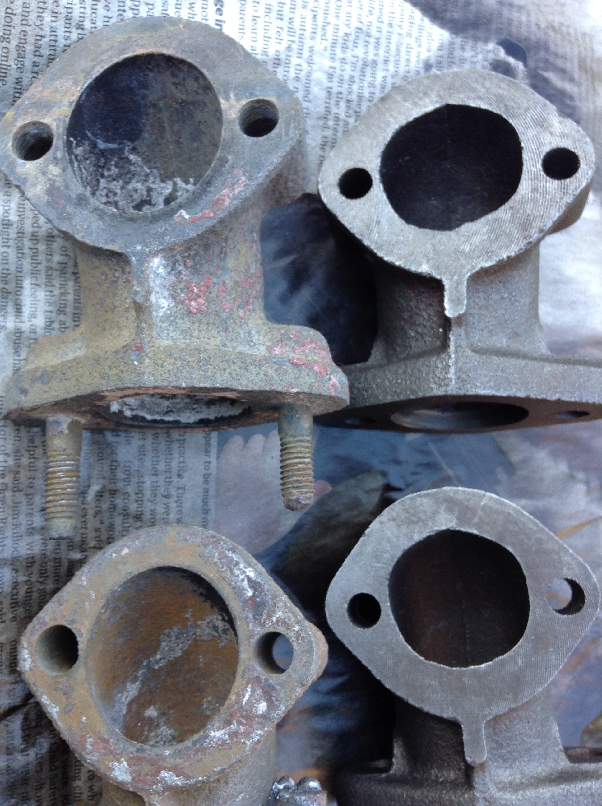

Why new exhaust elbows? Some of the new ones are very poor quality.
Is it just the one or both? The studs tend to be peened over at the back so tricky to remove. I have probably got a good used one in my spares.
Thanks Toshi. I've persevered with mine and they've cleaned up alright. Despite grinding the back of the studs, they would not come out. The other stud snapped rather than turn. One drilled out OK but the other just took chunks out of my drill bits. I slowly filed it out from 5mm ID to 8mm. It's probably cost me more in drill bits than replacing an elbow, but I've got there in the end.

A good way to replace the suds with is to use the special "lop-sided" exhaust bolts that a number of people sell (e.g. Motobambino---p/n EX003D). You may have to fettle 500 exhaust elbows to make them fit, but I personally think that they are a lot better than studs (which have a tendency to---snap off). I will concede tgat are actually designed for 126'elbows', but at the price that a set of 4 styds and nuts are, they might be worth trying.
