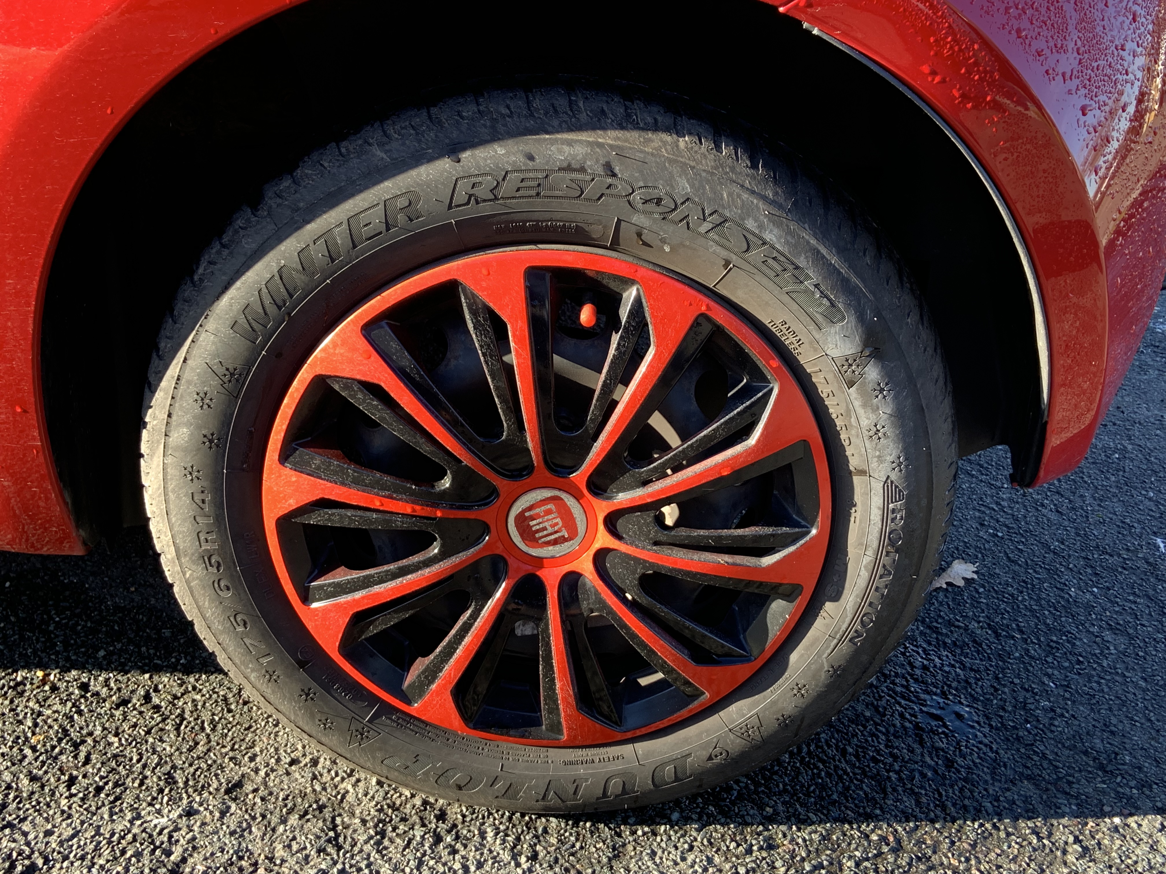

I’m still on the winter tyres.
Weather has turned cold again, but it’s the saving the alloys from all the potholes that really makes them worthwhile.
Weather has turned cold again, but it’s the saving the alloys from all the potholes that really makes them worthwhile. View attachment 419659
I usually keep my winter wheels on till around Easter depending on how early Easter falls. Needed 2 new tyres a couple of weeks ago. Bought 2 Michelin Alpin 6 on the back and swapped the rears to become the fronts.
