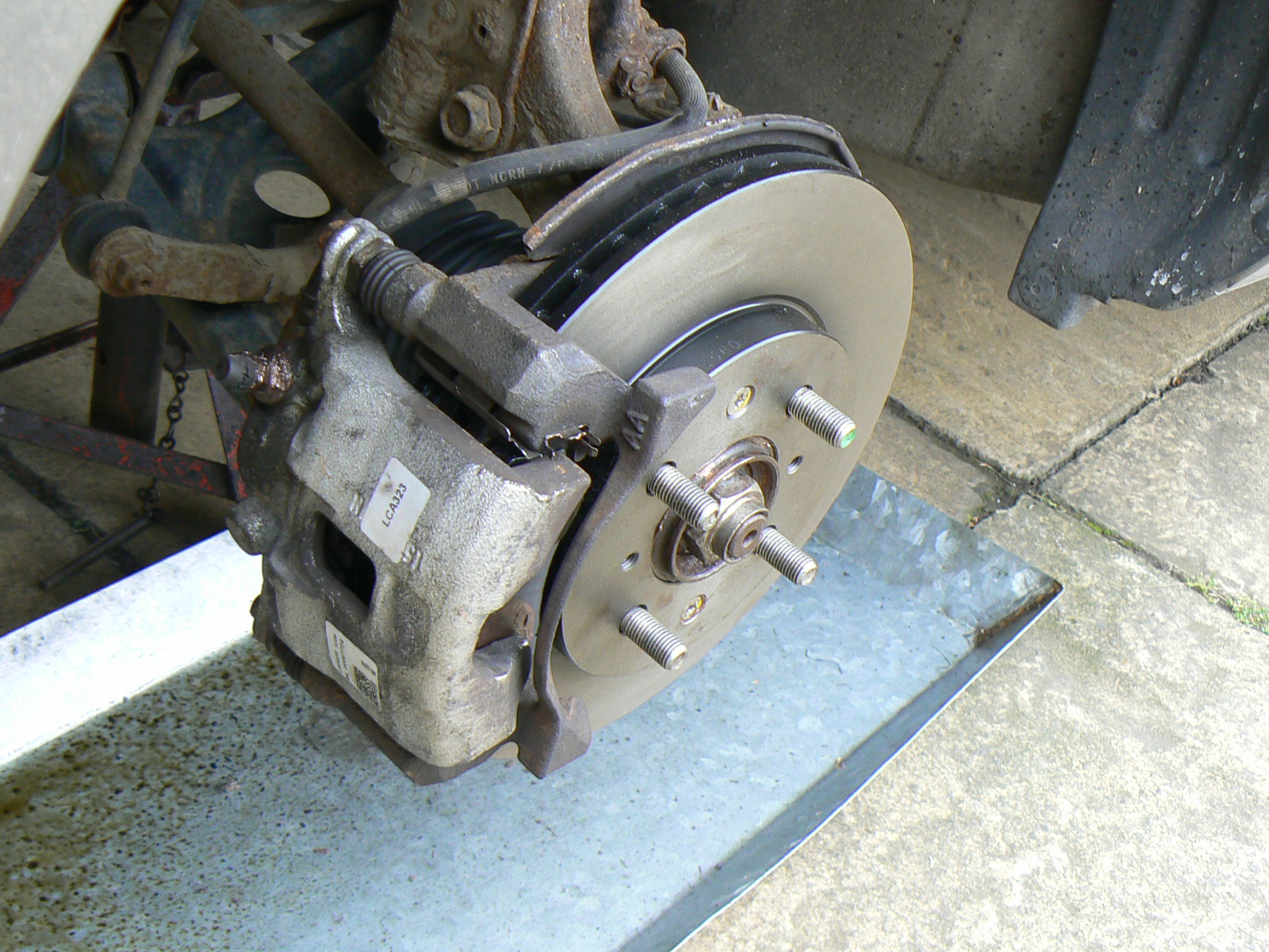

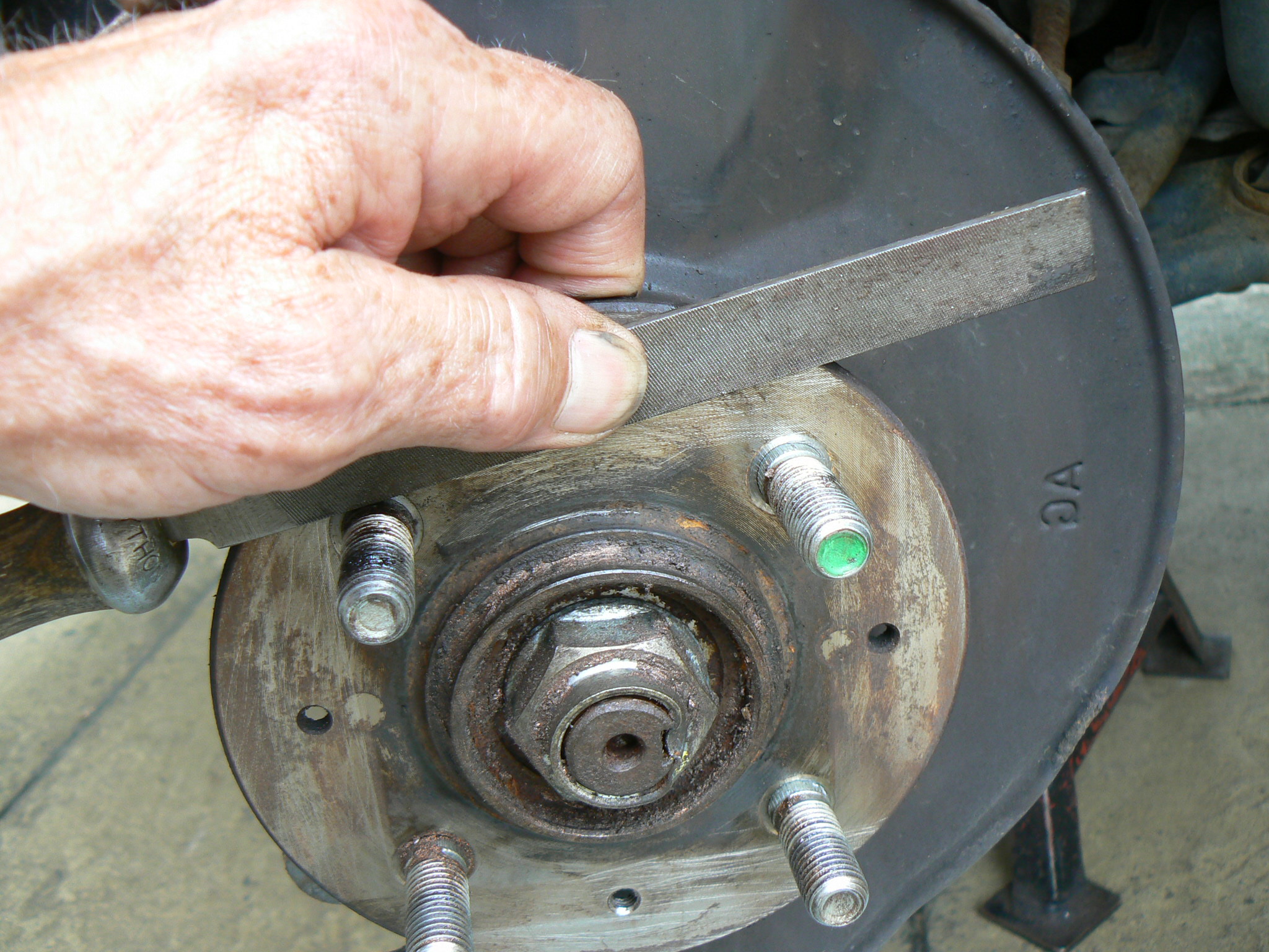

All four are the same! I scraped the outside of the nuts with a small screwdriver and, after some time, managed to get the tool on and the nuts removed. I buffed them up with some emery to remove the rust and gave them a light coating of grease - I'll have to keep an eye on them though.
Then the next shock. Because this car doesn't cover a lot of miles each year it's brakes wear pretty slowly - I believe it's still on it's original discs and 2nd set of pads. I had in mind that the brakes were going to be Ok for some time yet so got a bit of a surprise to find the front pads down to barely 2 mm. Last year the N/S front caliper seized and I fitted a rebuilt unit, noting on my record book that the pads were "Ok". This car is an '08 (one of the last of the Mk1 models) with 54,000 miles on the clock so I decided to treat her to both discs and pads. In fact the old discs might have stood another set of pads but were definitely past their best.

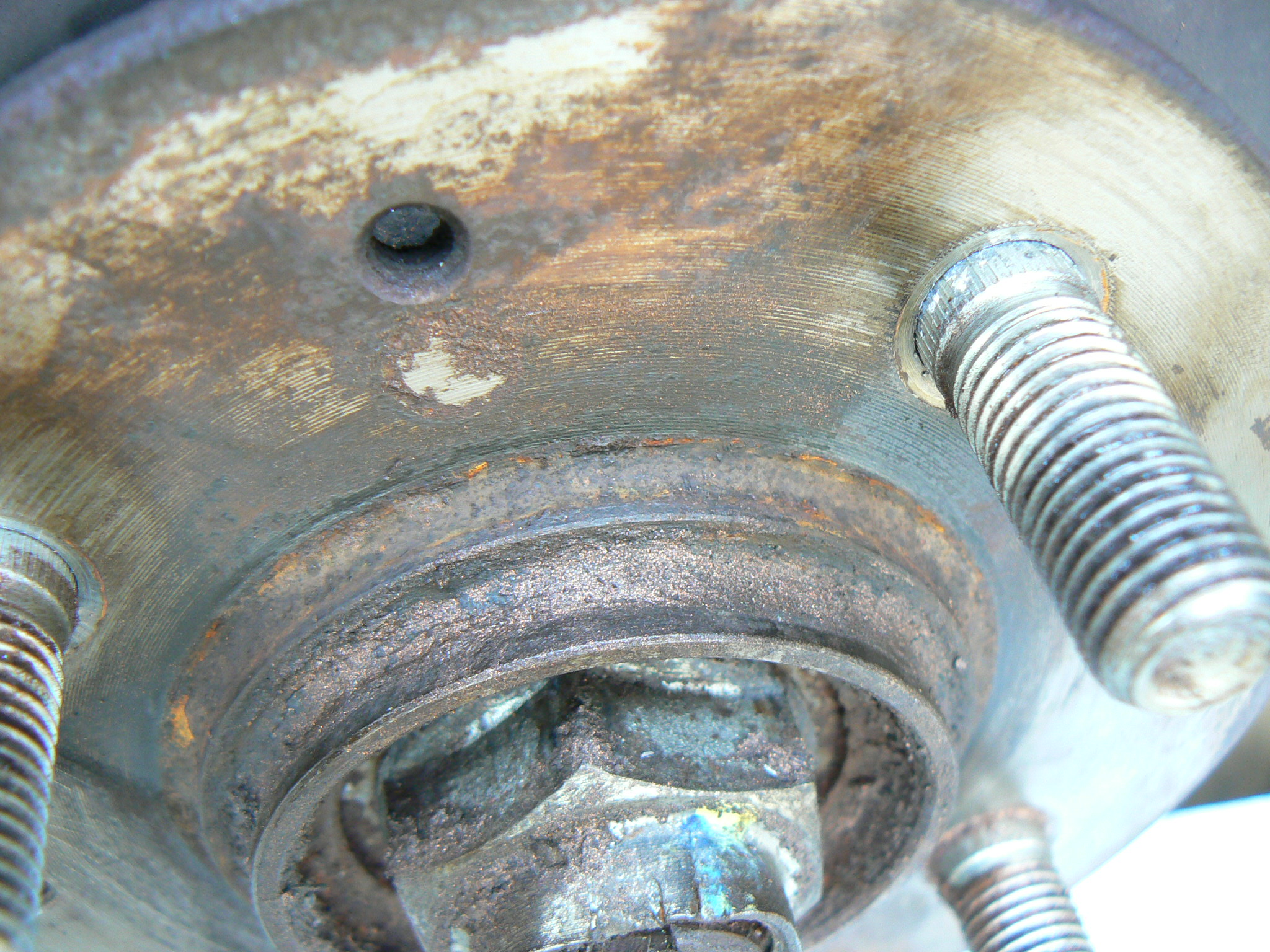

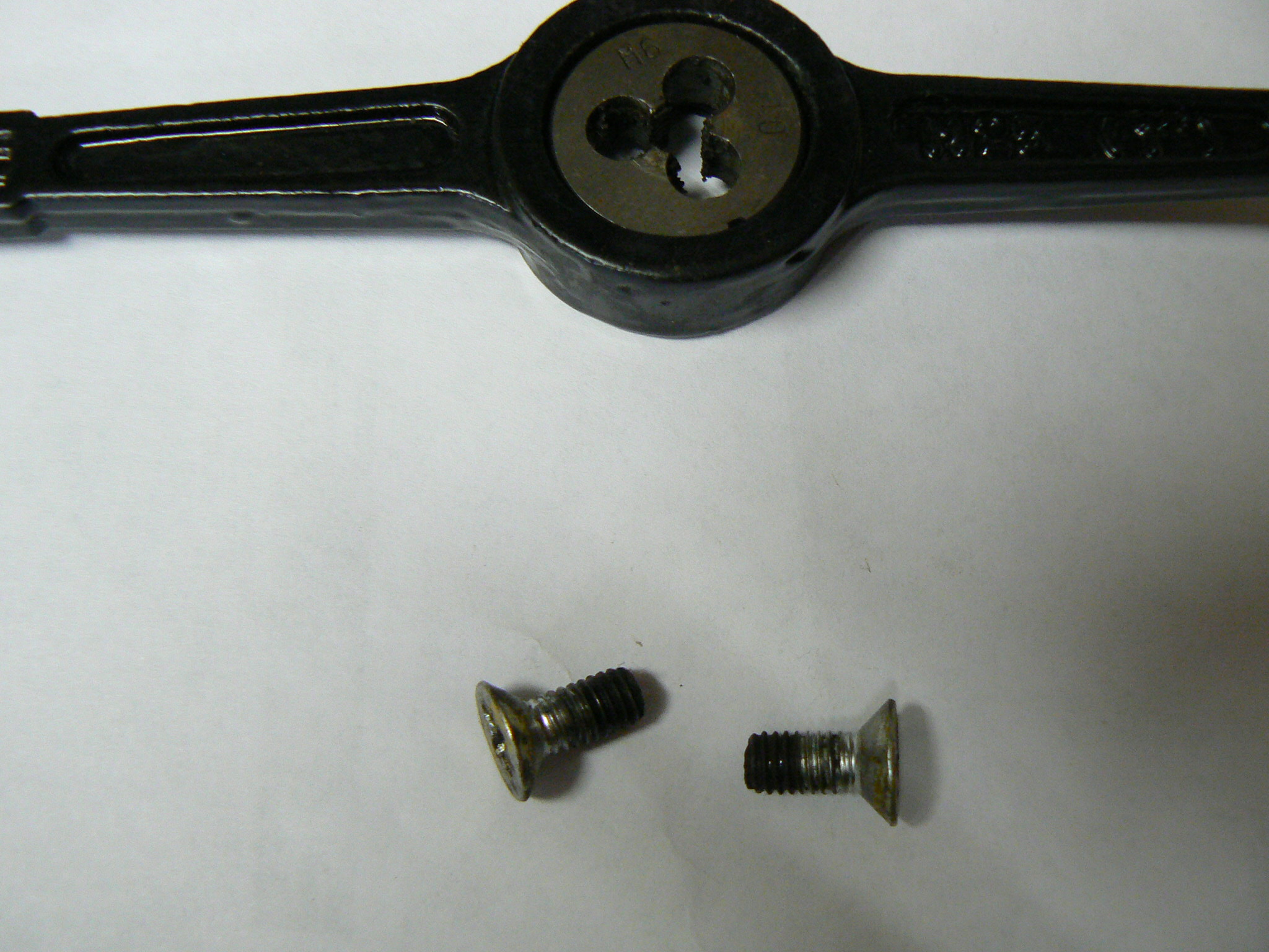

The discs are retained by two wee crossheaded set screws - as are many others - which can be difficult to remove. So I was delighted when these ones surrendered to a light tap of my hand held impact screwdriver. My delight was short lived though as they then tightened up within about three quarters of a turn. I did get them all out - and all 4 were as bad as the next - with lots of plus gas and tooing and froing with my electric drill/driver. Once out the cause of the problem is easy to see:
The screws project through the hub by about half their length. This means the back of the screw thread is exposed and so rusts! How Silly! I'm disappointed with Honda over this as I've come to regard the engineering in this car with high esteem. I think it's generally much better screwed together than many others I've worked on.

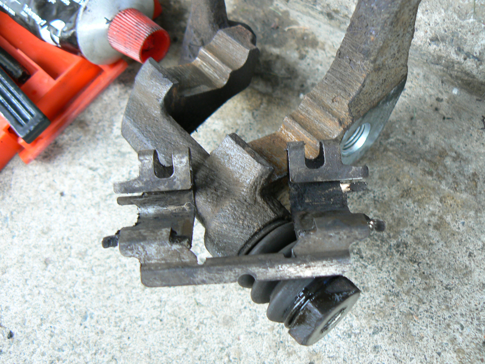

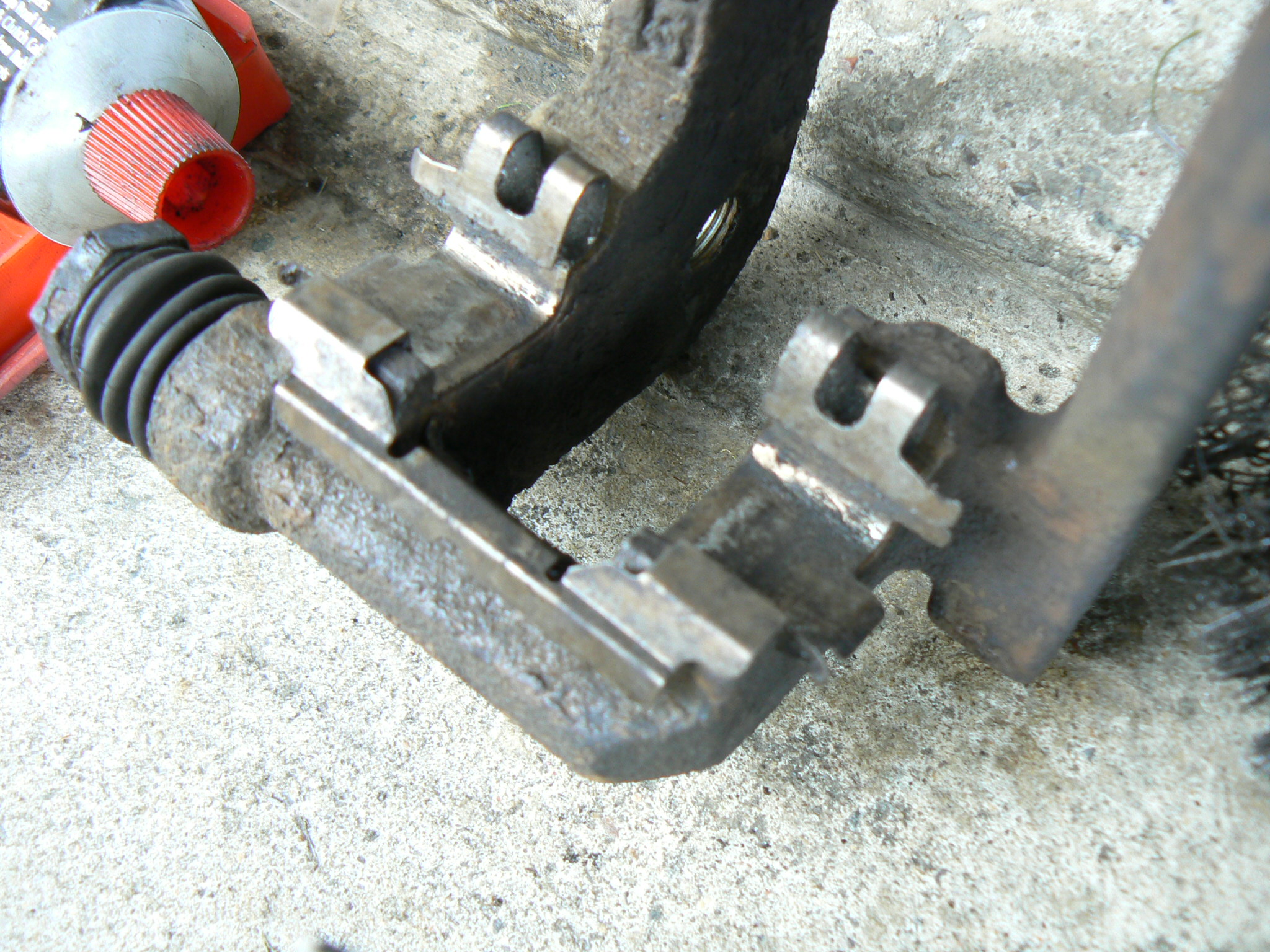

Have to say I like the design of caliper used. Nice slide pin design with easy to work with retaining set screws holding the caliper to the caliper slides. I slipped the pins out of their rubber boots and gave them a wee coating of silicon grease. The main carrier bolts came out without a fight and, once these wee screws were removed the discs themselves just fell off. I always pay a lot of attention to cleaning up the face of the hub flange so the disc runs "true" when installed. On this one there was a little corrosion on the hub which I cleaned up with a file.
The carriers cleaned up nicely too:

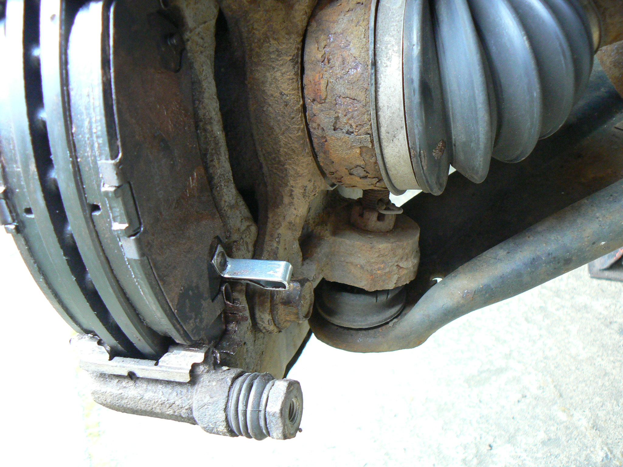

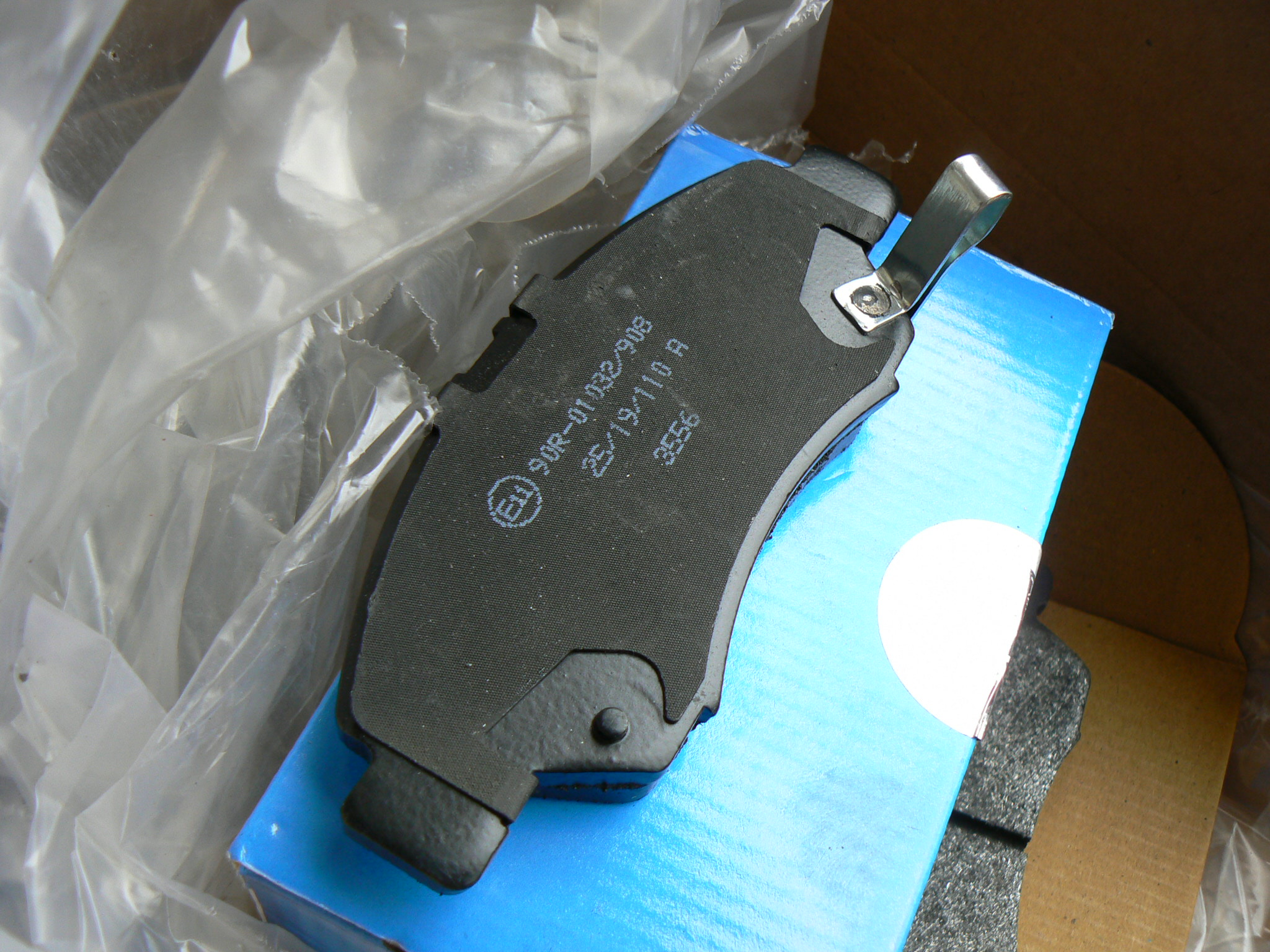

Can anyone explain what this projecting "tab" does?
when fitted to the carrier it looks like this - and I checked, this is fitted correctly
I've seen pads with wear "squeelers" on them which touch the disc when the pad is nearly worn out, but they are on the other side of the pad of course so they can touch the disc. It's all a mystery to me!

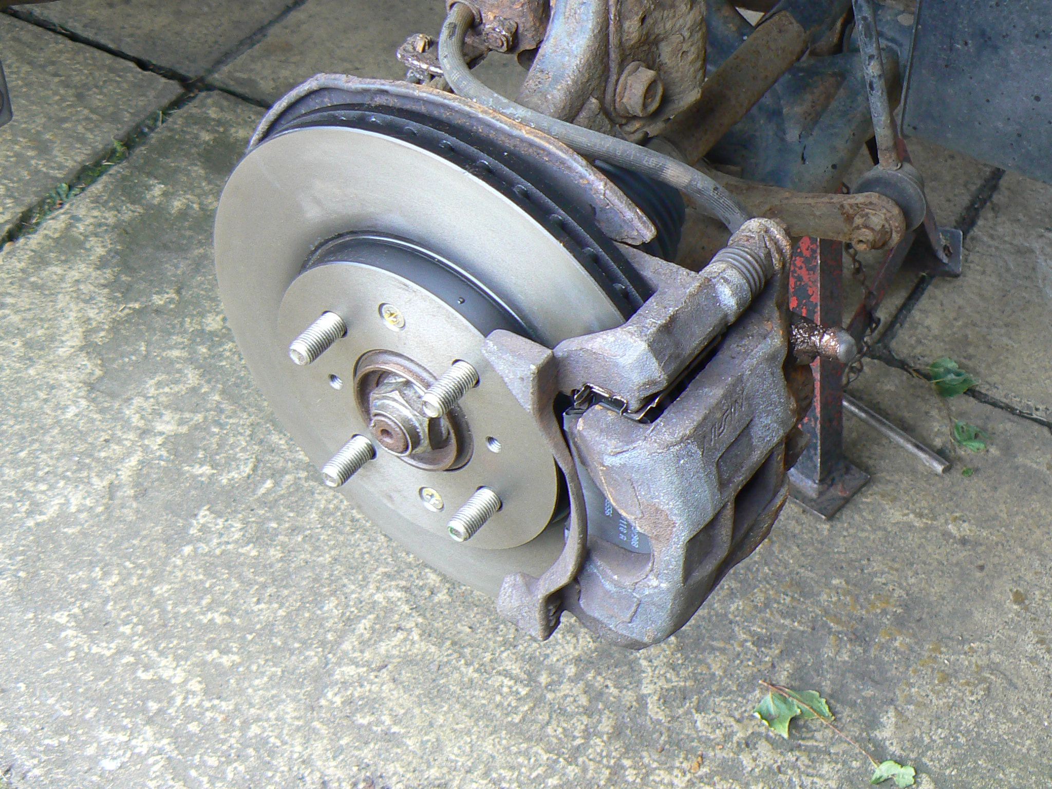

Nice when you see it all back together again though isn't it?
The N/S one still has it's stickers on from when it was replaced last year!
Audible wear indicator.
The tab is normally like a trombone, doubling back on itself, so the unattached end passes the pad and should protrude further than the backing plate, but only a little further. When the pad wears to this, the spring clip will vibrate and squeal horribly. The doubled length allows it to flex and vibrate without significant disc damage. Cheap and cheerful, until it squeals.
I've seen a lot where the rivet corrodes, the spring falls off, then the worn pad destroys the disc, so not reliable unless wear rates are high.
Ok folks, just me being stupid and unobservant! These are indeed "squealer strips" I just took a wheel off and had a good look at the pad in situ and I realize now what fooled me is that the end which will contact the disc when the pad is almost worn out has been oversprayed with the same black paint as the pad backing, but only the small section which lies against the side of the pad. The rest, as you can see from my 'photo, is bright plated:
So the bit which extends down the side of the pad - unfortunately hidden from view in my photo - tends to blend visually into the pad. I just didn't look at it closely when fitting.
By the way, many pads can be fitted either way round as their metal back plates are symmetrical. Because of this you can get confused as to whether the pad should be installed with the "squealer strip" on the leading or trailing edge. I've looked at a number of installation instructions and they all show the strip on the trailing edge (when the vehicle is moving forward). As you can see I've done here:
This makes a lot of sense as it will tend to pull the end of the strip away from the edge of the pad and let it "squeal" to maximum effect. If it's on the leading edge the disc will be pushing it towards the pad so the "squeel" will be damped as the strip is pushed into the pad matterial. I decided to just mention this as many aftermarket pad sets don't include this info and if you've taken the pads off both hubs you can't check - anyway, who's to say the last person put them on the right way round?. Most will work Ok the "wrong" way round, just the "Squealer" won't work so well and may gouge a bit of a groove in the disc - which would be annoying if you were intending to only change the pads!
