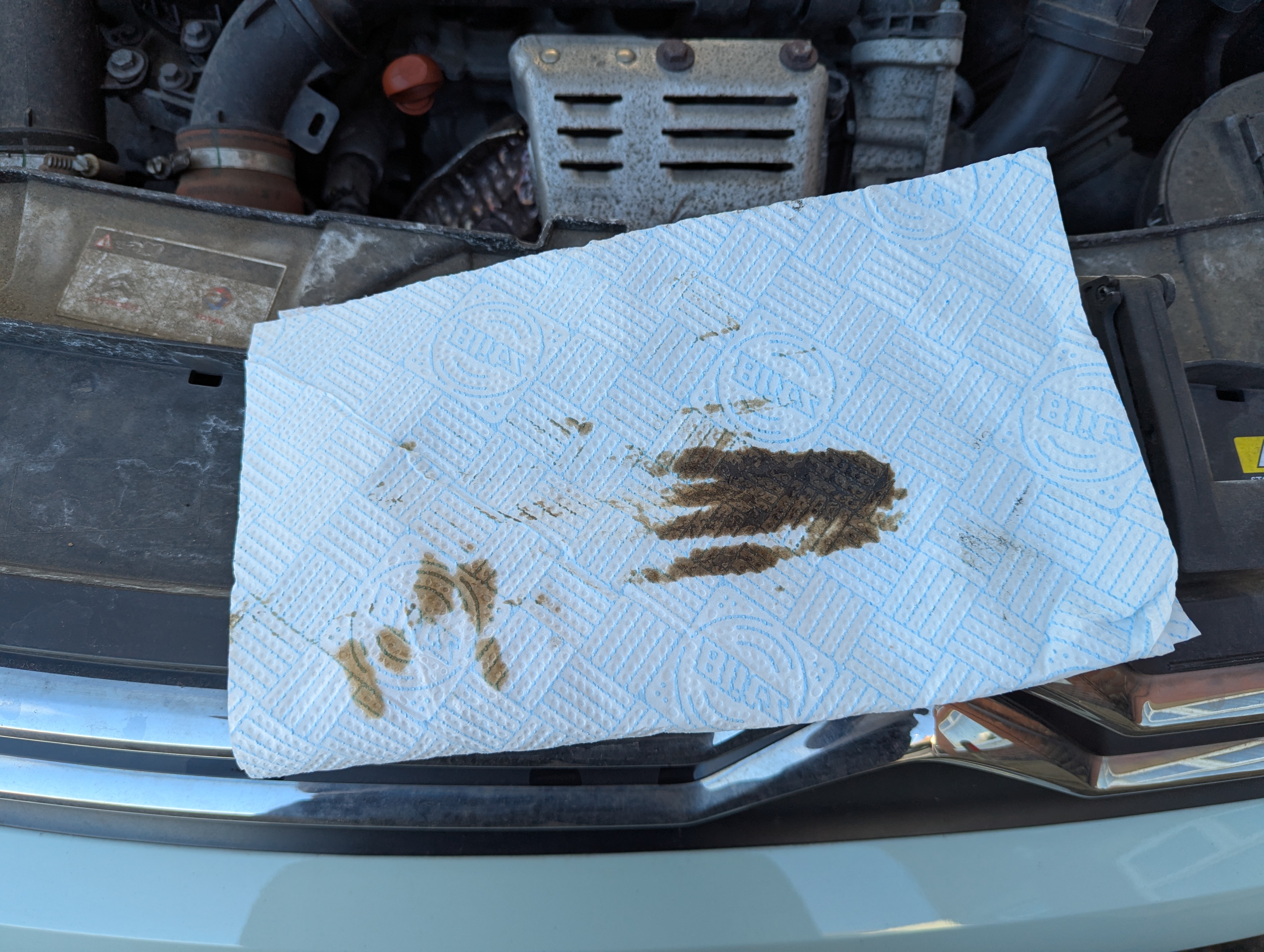

Walk around checks this morning...
Both cars have done 2k miles since last oil change both of which were done in late September
So let's play a game... identify which oil is from which.
Left or right? Toyota or Citroën?

I'm thinking Toyota is lower mileage overall, so that is the cleaner oil, on the left.
Correct... although for entirely the wrong reason. The Toyota is 800 miles short of 80k the Citroën just over 51k.
And that folks is why Puretechs are very sensitive to bad servicing.
Weird really given the engine the Citroën has been serviced every 6k it's entire life and has a lot less weight to move and is a similar spec and power output, almost like it's not built as well.
