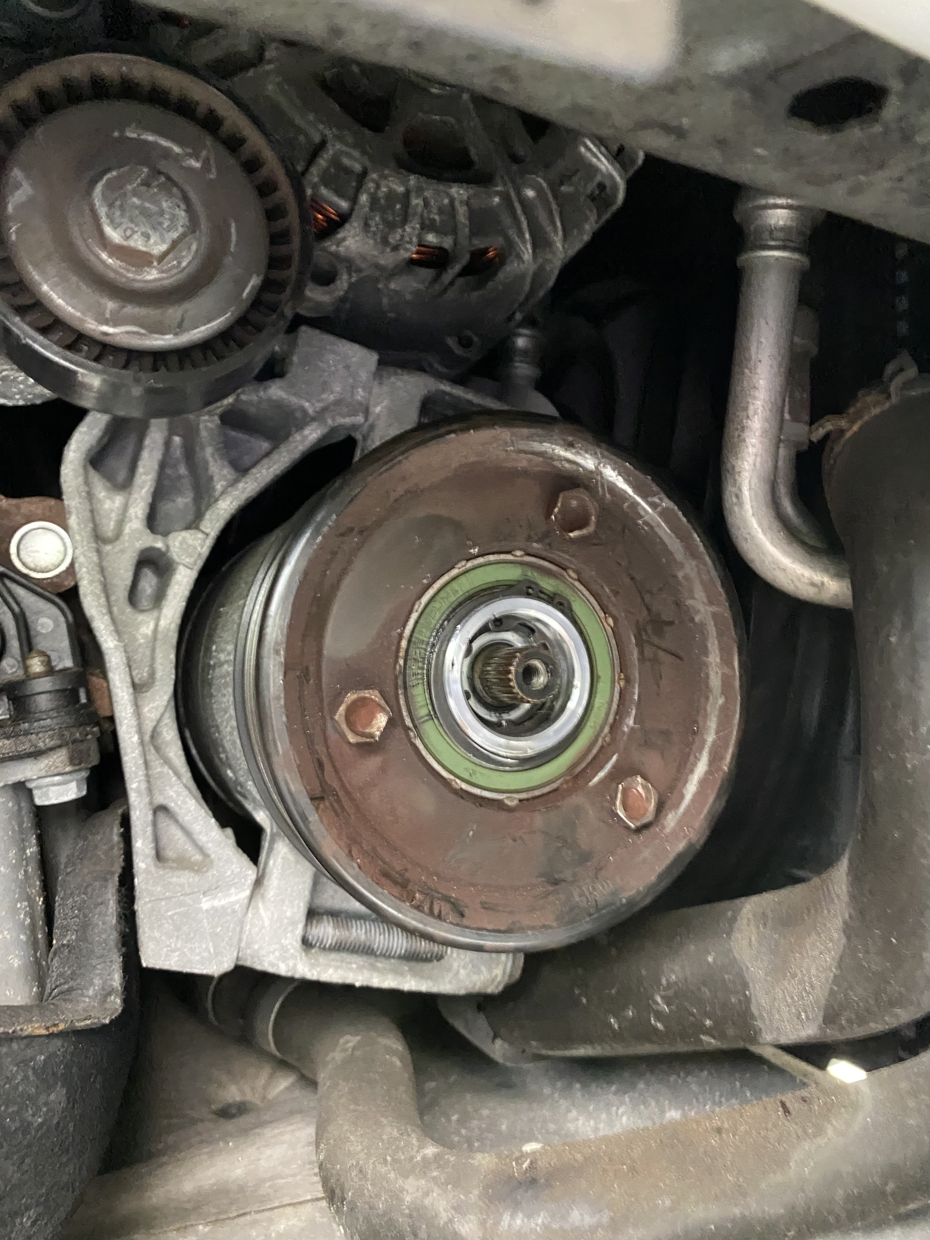

TA DA !

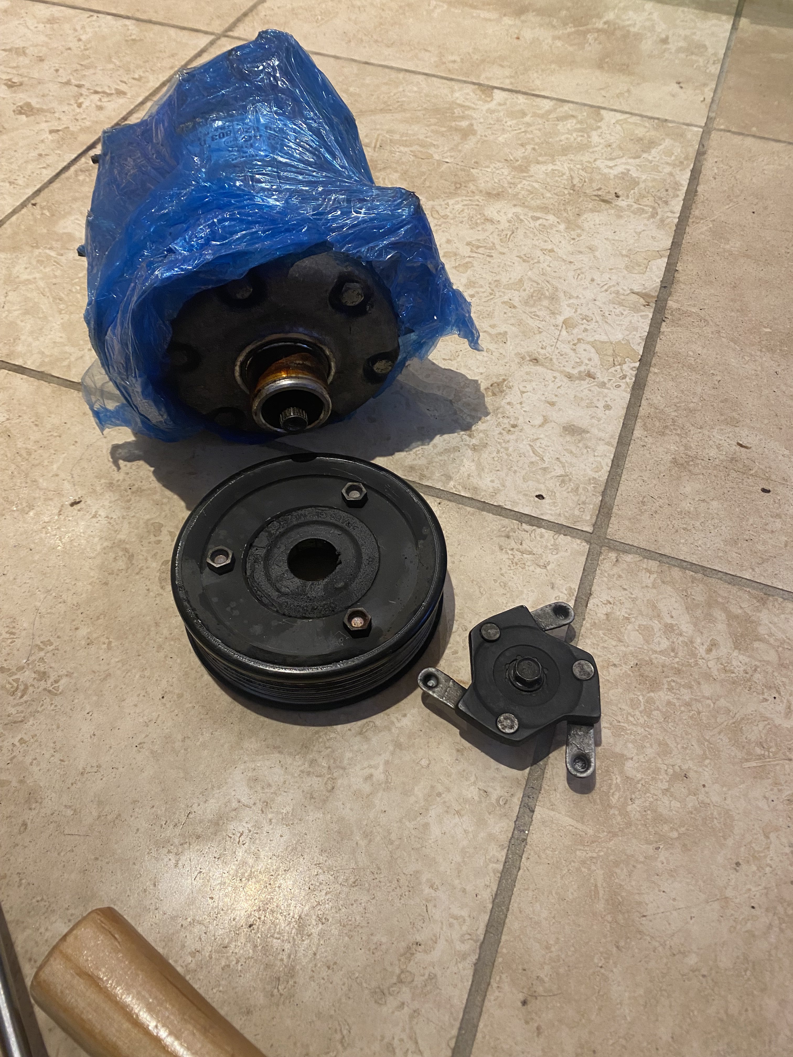

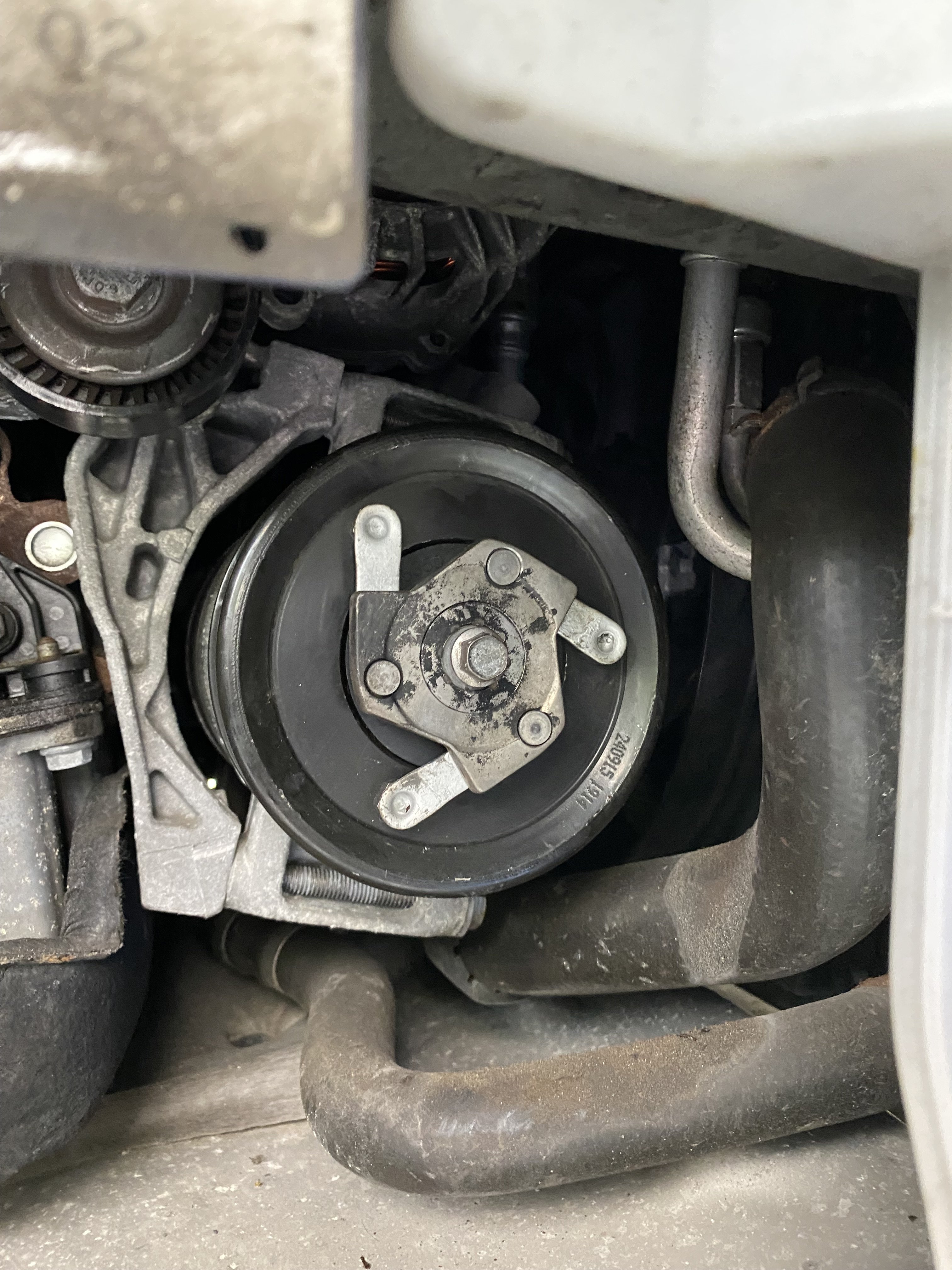

All fixed and air con super cold again.

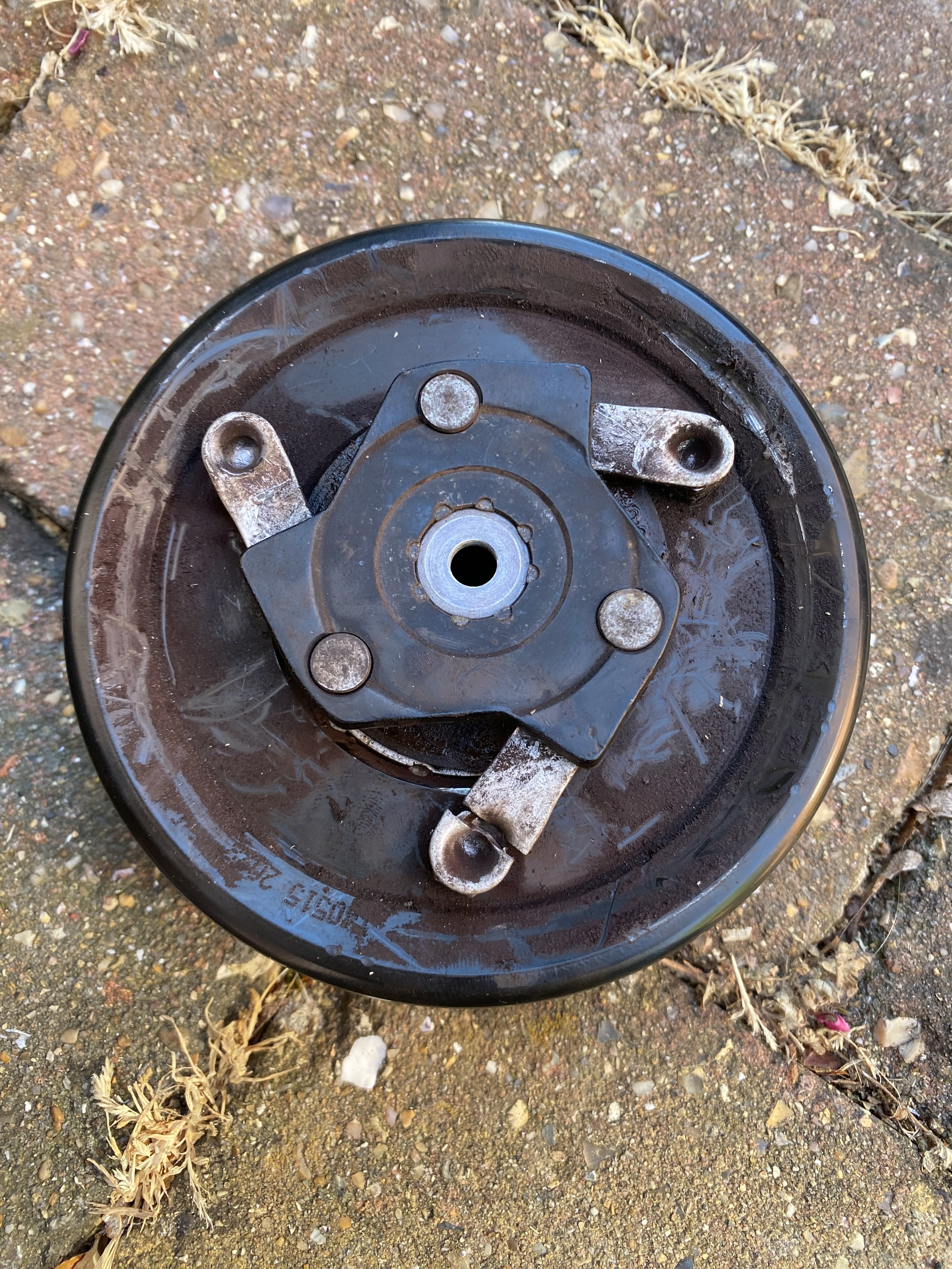

Looks like the metal on the old part just fractured and broke away, the engine bay is so enclosed on this car that the broken part was sat neatly in the under tray.
I’m guessing the imbalance and the extra pressure on the other two arms caused the others to also break away from their locating holes in the pulley
You can see the damage done to the three nuts (for want if a better word) that located the arms of the centre piece.

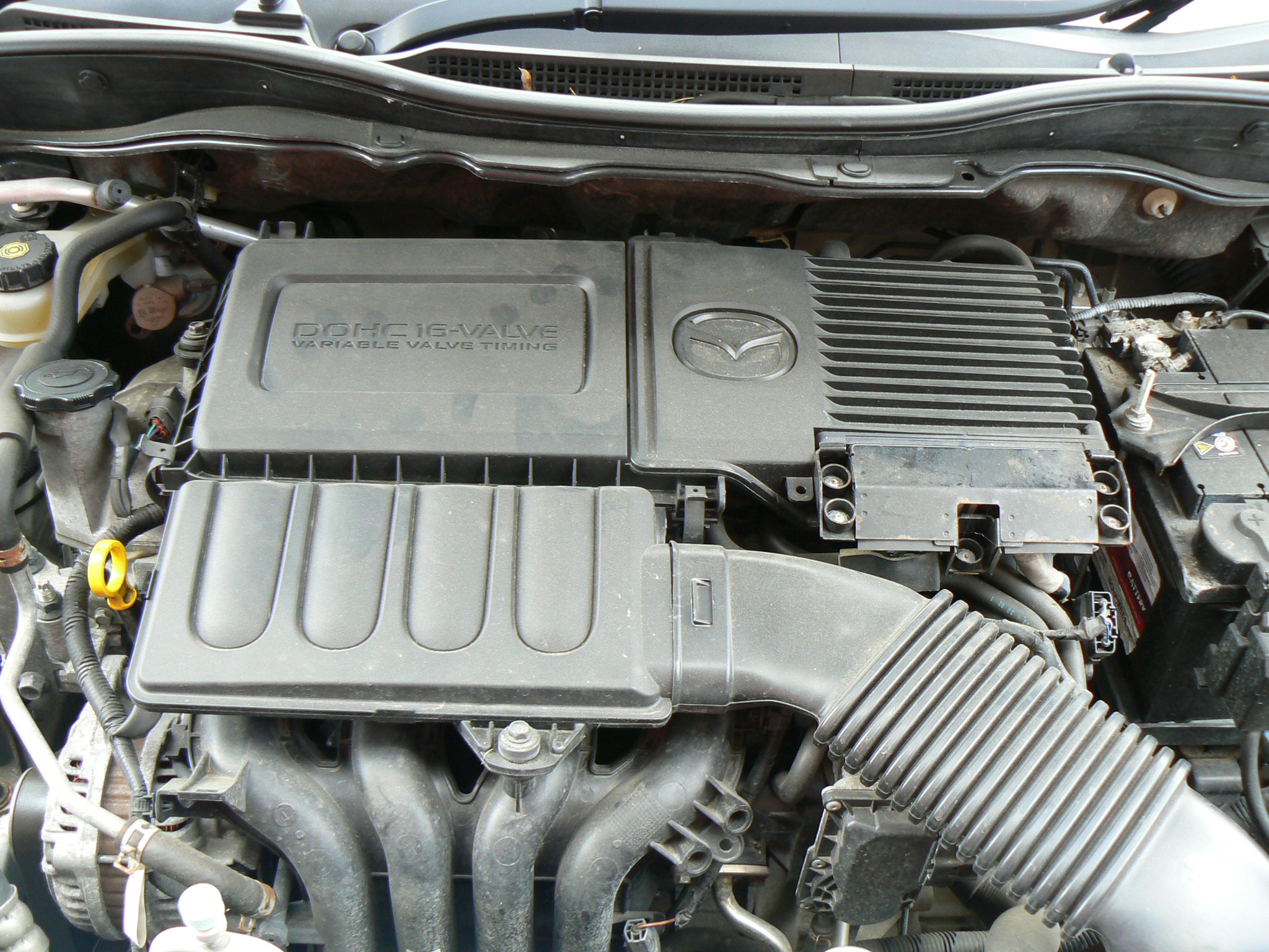

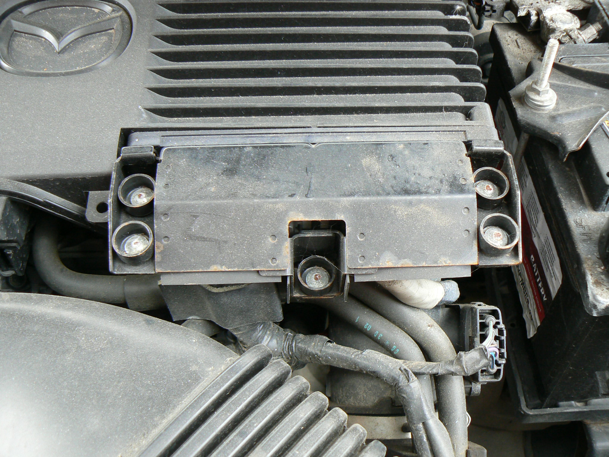

The straight ribbed bit to the right - not the air duct at the front right - is the ECU and to it's left is the air filter box (with the writing on top) It's all one unit. If you look closely you can see, at the front, one of the securing bolts. There's another just visible at the back left and there's one right behind the casing which you can't see (and is going to be a wee bit awkward to get at. If these three are removed and the air duct removed (it's a simple push fit) then if you release the intake trunking (rubber hose hidden under all this) the whole unit will lift off and then you can spring the clips - look carefully, they're standard finger type clips, you can see one in the middle and one on the left - and the bottom of the filter casing will drop off revealing the filter element. One problem though. I suspect, and have seen You tube videos, that the ECU multiplugs need to be released to allow the filter/ECU unit to be lifted off and they - two of them - are "hiding" under here:

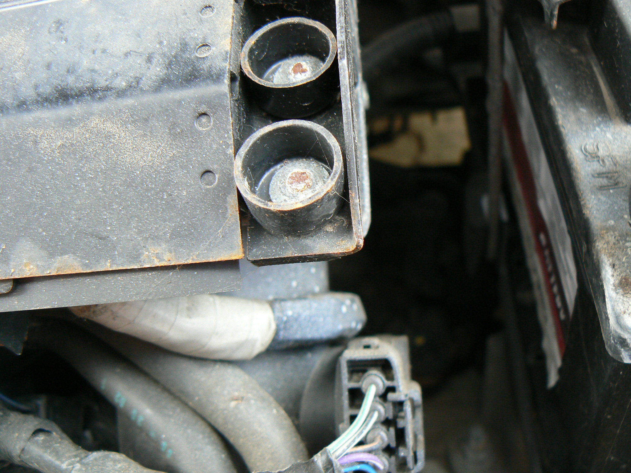

The problem is compounded by the fact that those round headed fixings are not rivets, they are the heads of shear nuts:
You can see the threaded portion on the underside with a mirror.
Have to say I'd rather not undo the multiplugs anyway so I'll see if I can gently lift the case far enough to release the filter. Don't know what I'm going to do about the plugs yet because they are under all that lot, hiding down deep holes! At 47,000 miles they are way under maximum mileage recommendation but considerably over the age recommendation so I'd like to pull them for a look see. I suspect a wee clean up of the insulators and reinstall might be Ok. Just depends on what the business ends and gaps look like.

If memory serves, undoing the 3 visible clips gets you about 30 degrees of movement and enough to slide the new filter in/old one out from the drivers side. But my scuttle panel may have been further away..
