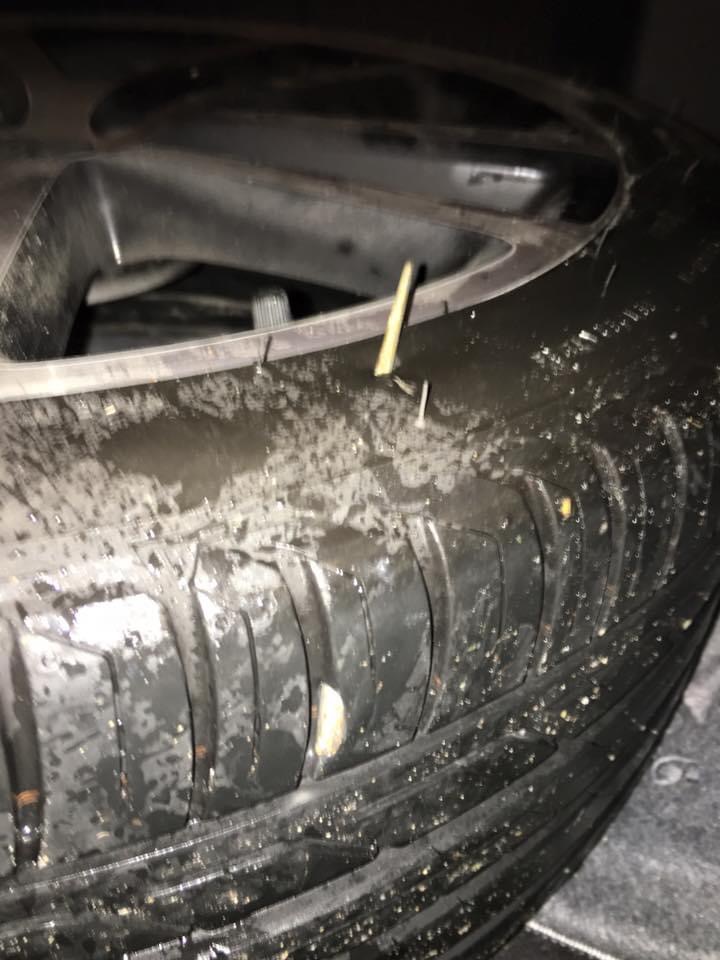

The first time my wife borrowed my car to get to work, 2 months old and she found the biggest nail in the world.

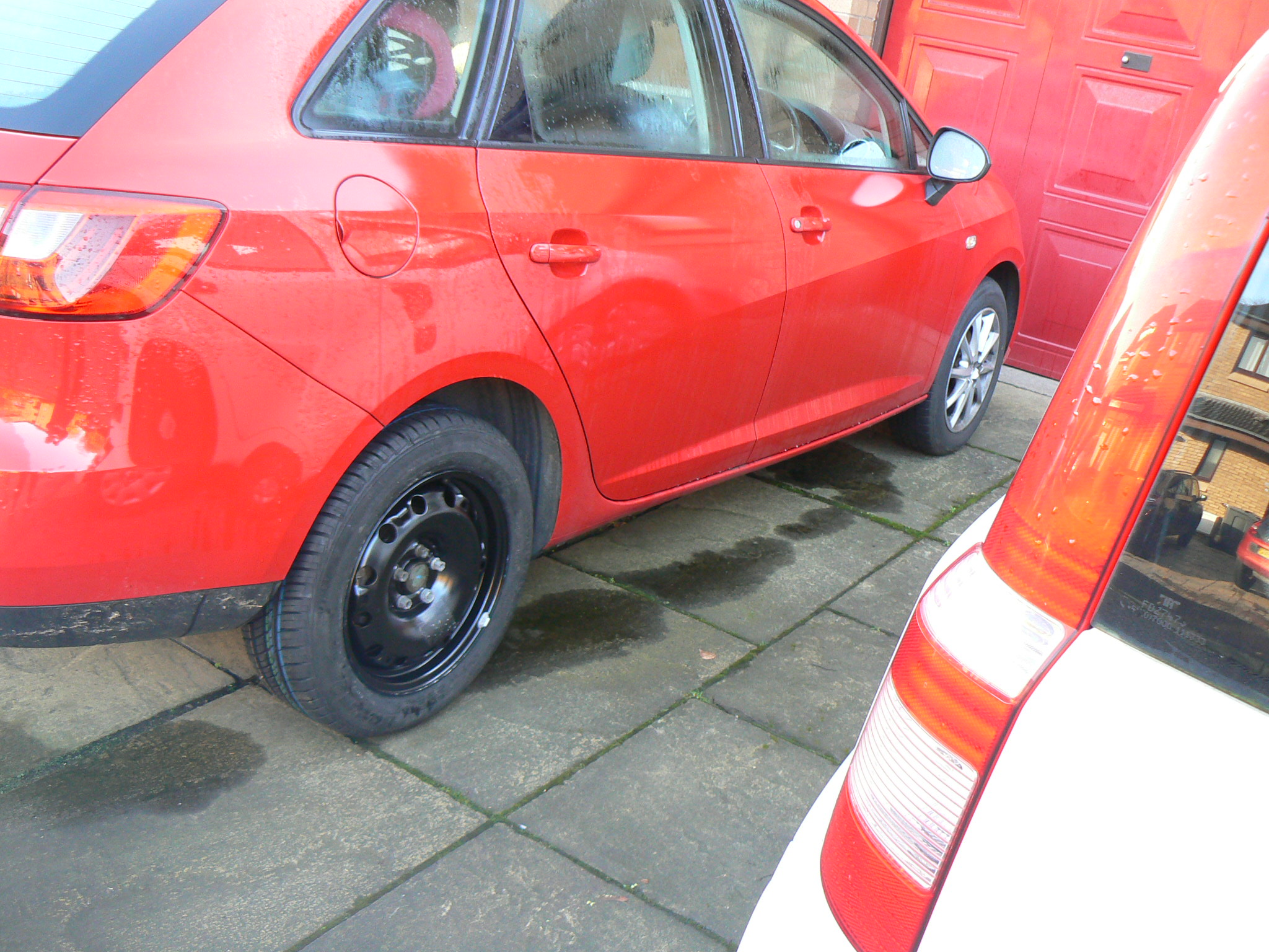

Now here's a thought. As the Ibiza came with just a bottle of gunge, I bought a standard steel rim - genuine VAG product as fitted standard to the base version of my vehicle. The base model uses the same 185/60R15 size tyre as mine and the wheel width and offset of the steel wheel is the same as the alloys which came with my vehicle. So from the point of view of dimensions and tyre speed rating etc the steel wheel is identical to my alloy - and, of course the base model comes on these steel wheels. So, with the steel fitted, as it is right now:
can I just drive at normal speeds or should I be limiting progress to 30mph - or whatever - due to the wheel not being an alloy?

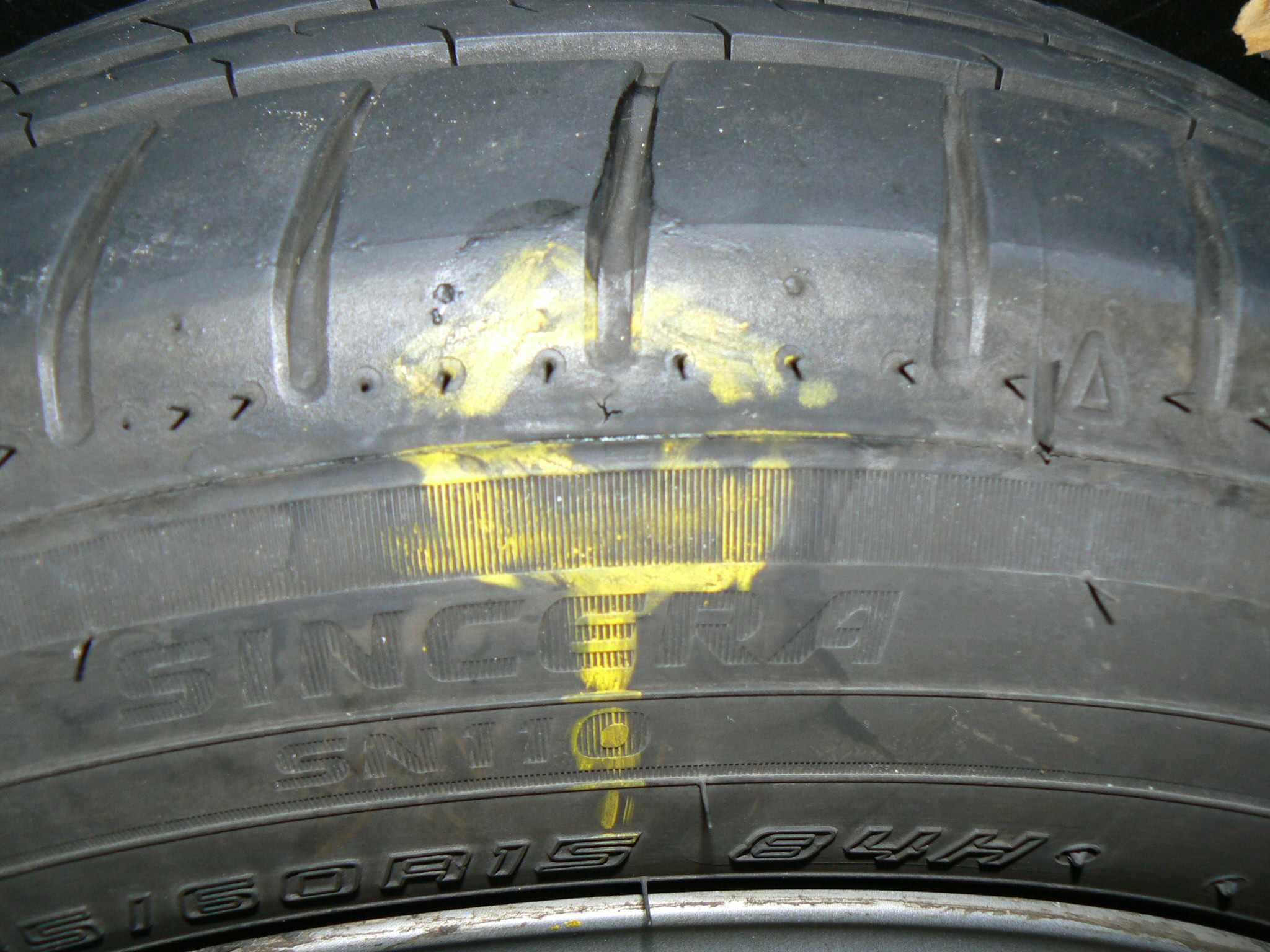

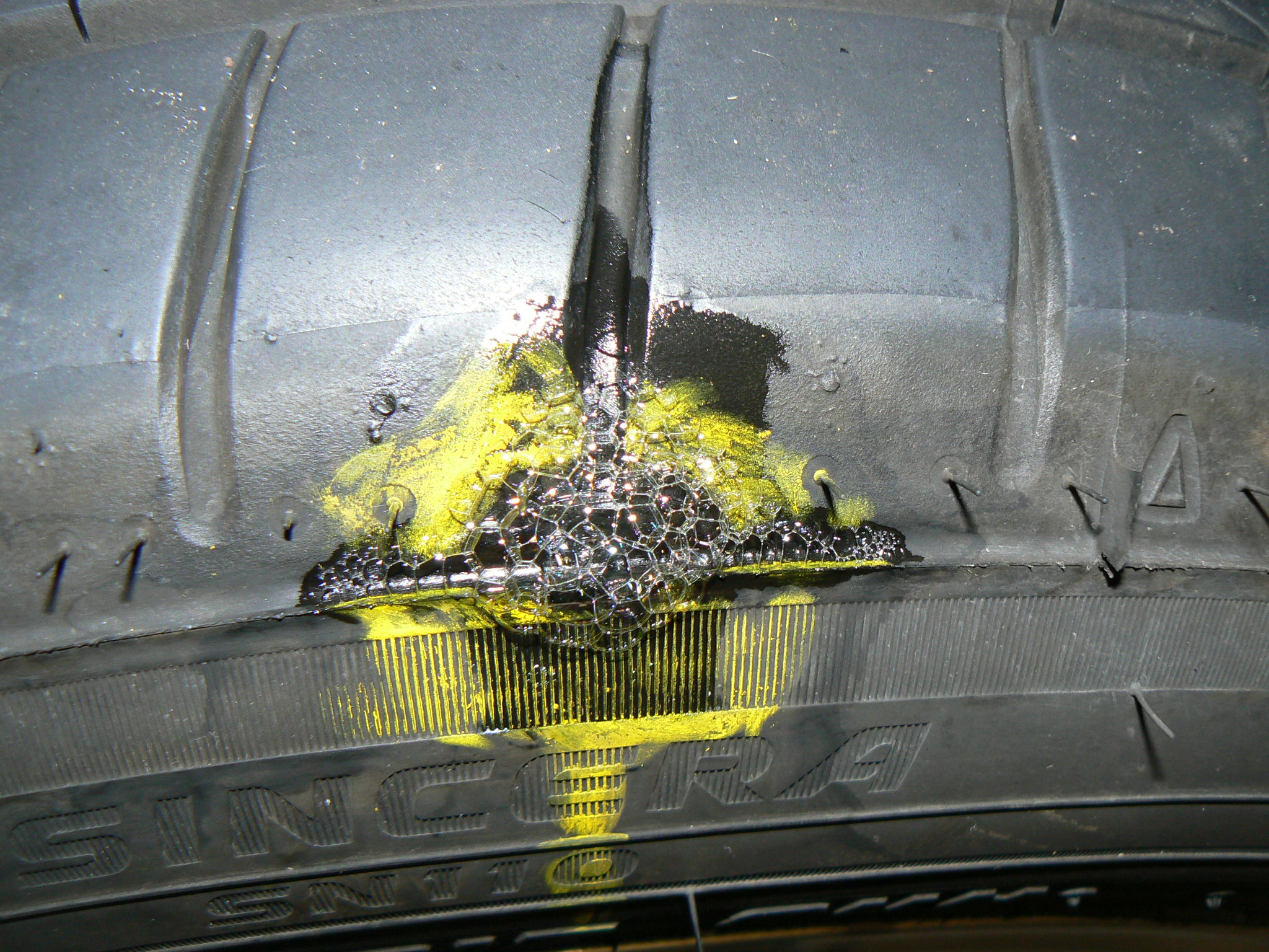

Here's the puncture:
It's just at the end of that tread groove, almost impossible to see unless you look really carefully. However slaister a wee bit of soapy solution on it and you can see the bubbles.

Think this would be one of those things that makes a difference in theory rather than practice.
In theory the wheels have a different rotational mass so braking may be different across the axle..in practice whether you'd notice that over say braking on the camber of the road is probably unlikely.
Only thing for me would be the bolts. We've got a steel spare and alloy wheels, as they were a factory option the bolts are designed to work with both. Slightly odd in that the alloys are hub centric...but the steels are not.
As result there's a flair half way up the bolt that centres and holds the steel wheel on that the alloy does not utilise at all as the bolt holes are bigger and they get held by a captive washer at the end. Slightly odd as fully tightened up..half the bolt hangs out the steel wheel.

You can drive at normal speeds, as it is effectively the same wheel/tyre.
These are probably the same wheels as on my Fabia. The base Fabia has steels, and the SE, which I have, had alloys, but identical dimensions and tyre size. When I bought it, the dealer happily swapped my alloys for steels from a base model, as steels make more sense for learners, where kerbs have a tendency to jump out at them. I bought a new wheel for a spare, and a toolkit (from an Ibiza) via eBay.
