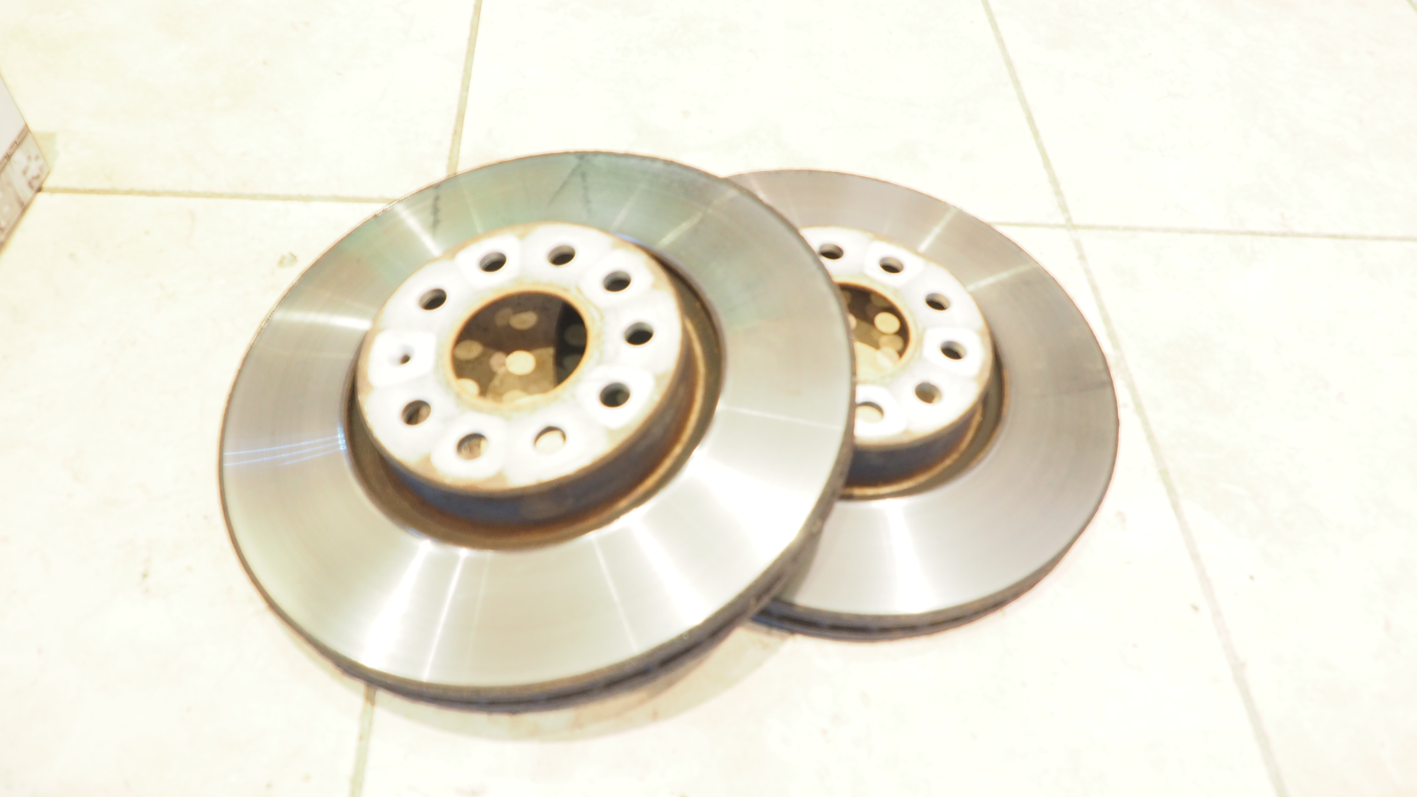

Final service of my VW service package today, and because of more than a couple of screwups on their part in the past, they threw in a free brake discs and pads change, given they had been claiming since 20,000 miles the pads where worn, and the car is now on 60k miles, I thought what the hell, and let them do the work, now that said I had looked at the brakes and they all looked fine to me....
“When you’ve change the brakes can you put the old parts in the boot”
“Yes” they agreed..
Well
If you see both the pads and the discs you’d not think they had done 10k miles. I’ll post a picture up tomorrow, but basically they look hardly used and I’m seriously considering putting them back on and saving the new parts till they actually are needed.
Considering I’ve now done 60k miles it’s amazing how little wear their is, although the car does have regenerative brakes and I’m very good at driving very long distances without needing the brakes, to me it’s no surprise how well they have lasted. To my wife who can burn through brake pads in 30k miles, it’s a bloody miracle.
Got me wondering how many people are changing their brakes on the recommendation of the dealership when the parts are not even 25% worn. The waste this generates and the expense not only to customers but the environment as well must be huge.
I wonder if stuff like this is why VW dealers keep getting a hammering in customer satisfaction surveys? Who knows?
I would imagine they are targeted on out of warranty services performed. So free brakes would be an attempt to win back a bit of good will before you are no longer obligated to go to them.

A main dealer will recommend replacement brakes if they believe the items currently on the car won't last until the next scheduled service.
For many people, on 20k intervals, they'll recommend replacement every service - because customers shout even more loudly about cars needing stuff like brake pads between services - 'why didn't you do it when you serviced it'.

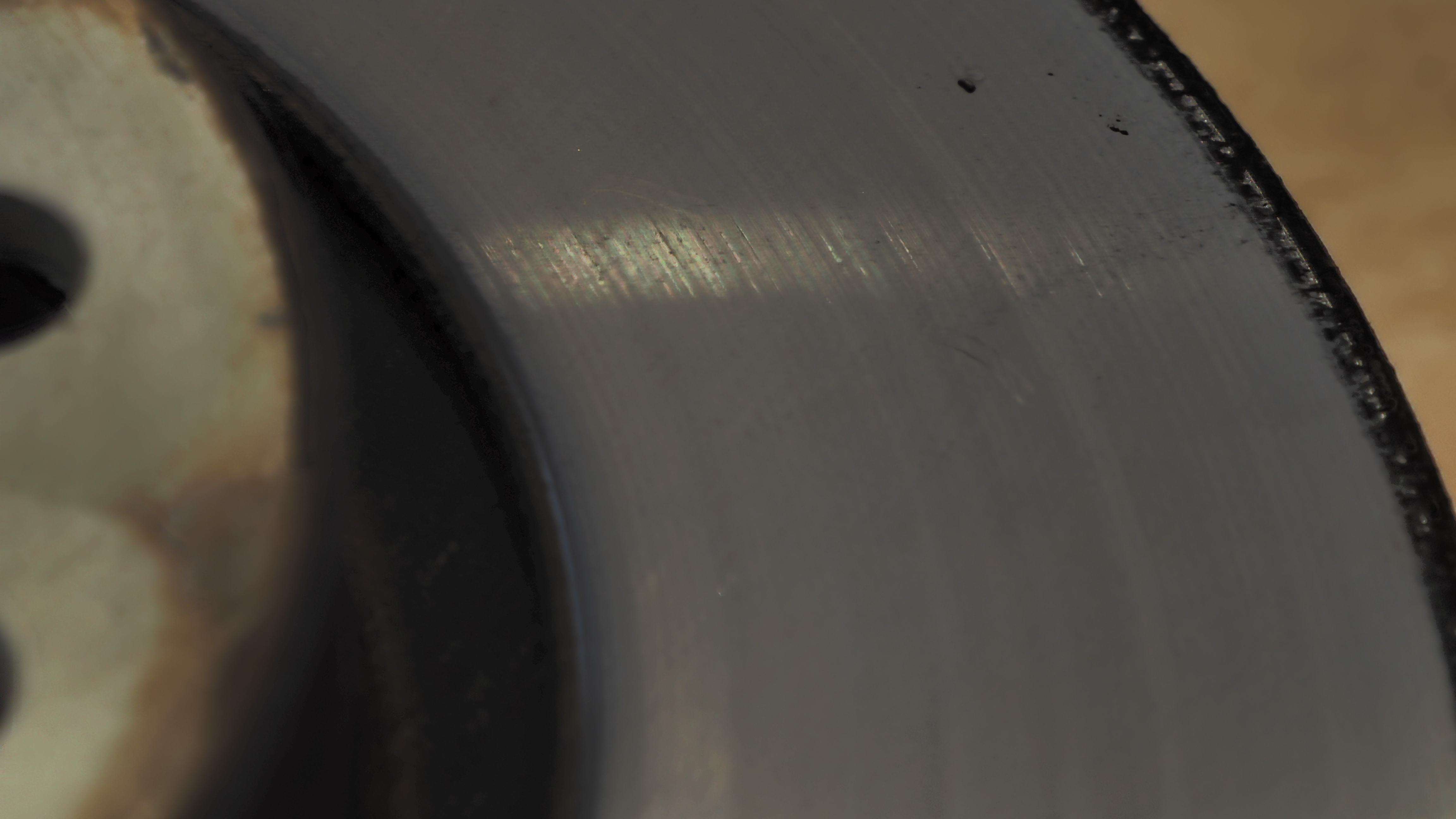

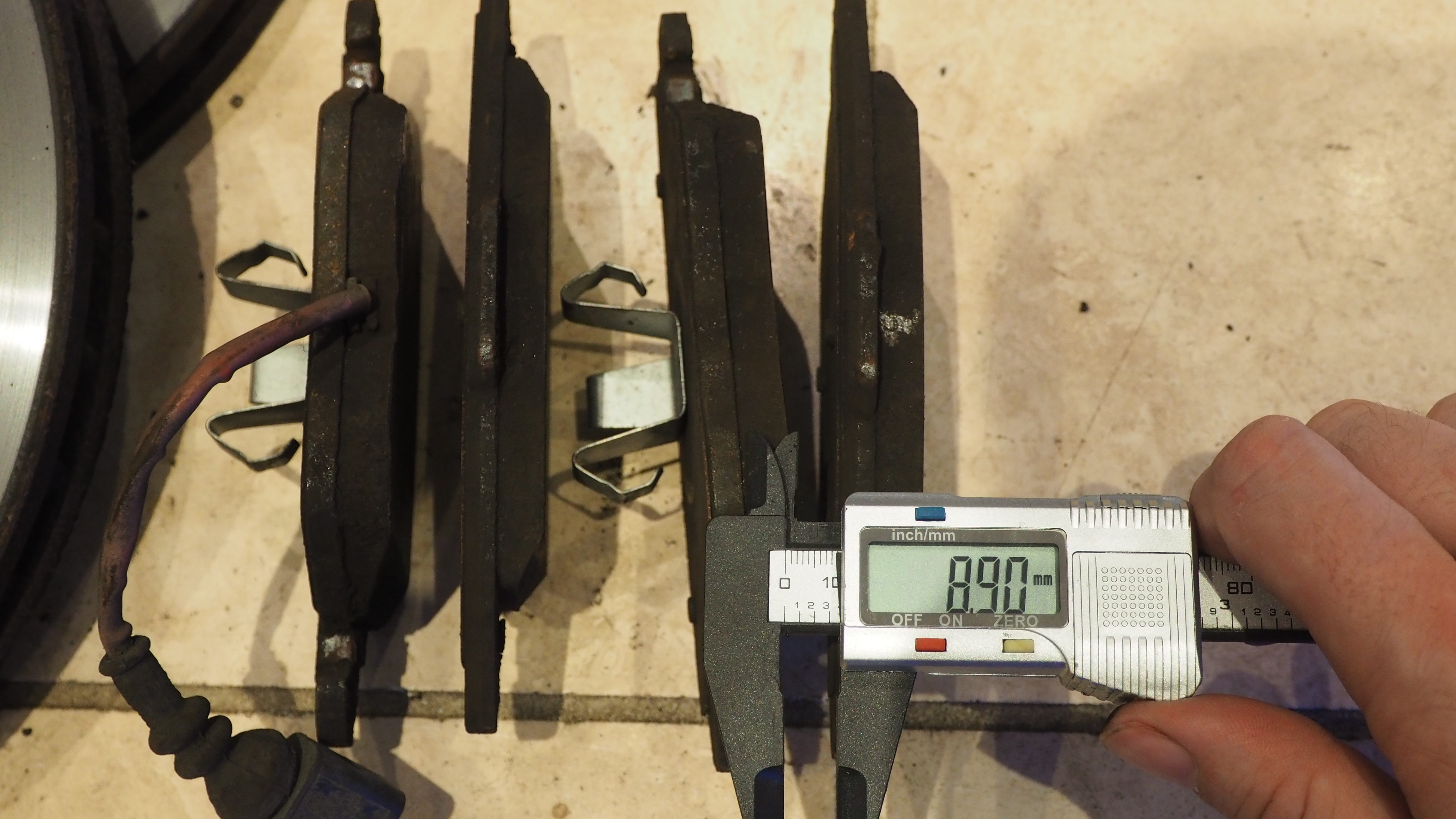

So here we go, brake pads that the dealer ship stated last June where “80% worn and would need replacing soon” and discs that are badly scored.
By my calculations the pads are a smidge under 31% worn, as you can see the discs are not badly scored.
Interestingly when the manager of the dealership phoned me today he mentioned (accidentally I think) that he had another similar complaint on his desk from someone being told their brakes need changing.
Like many dealerships now they send a video each time they do a service and the technician clearly states on that video they are 80% worn as well as recording it on the paperwork so he can’t really get out of that one.

The mechanic must have been measuring the metal backing plates ;)
I had the car MOT record brake pads being worn. When removed. they were below 50% but certainly not worn out so got changed anyway. I now always check and measure them before sending it for MOT.
