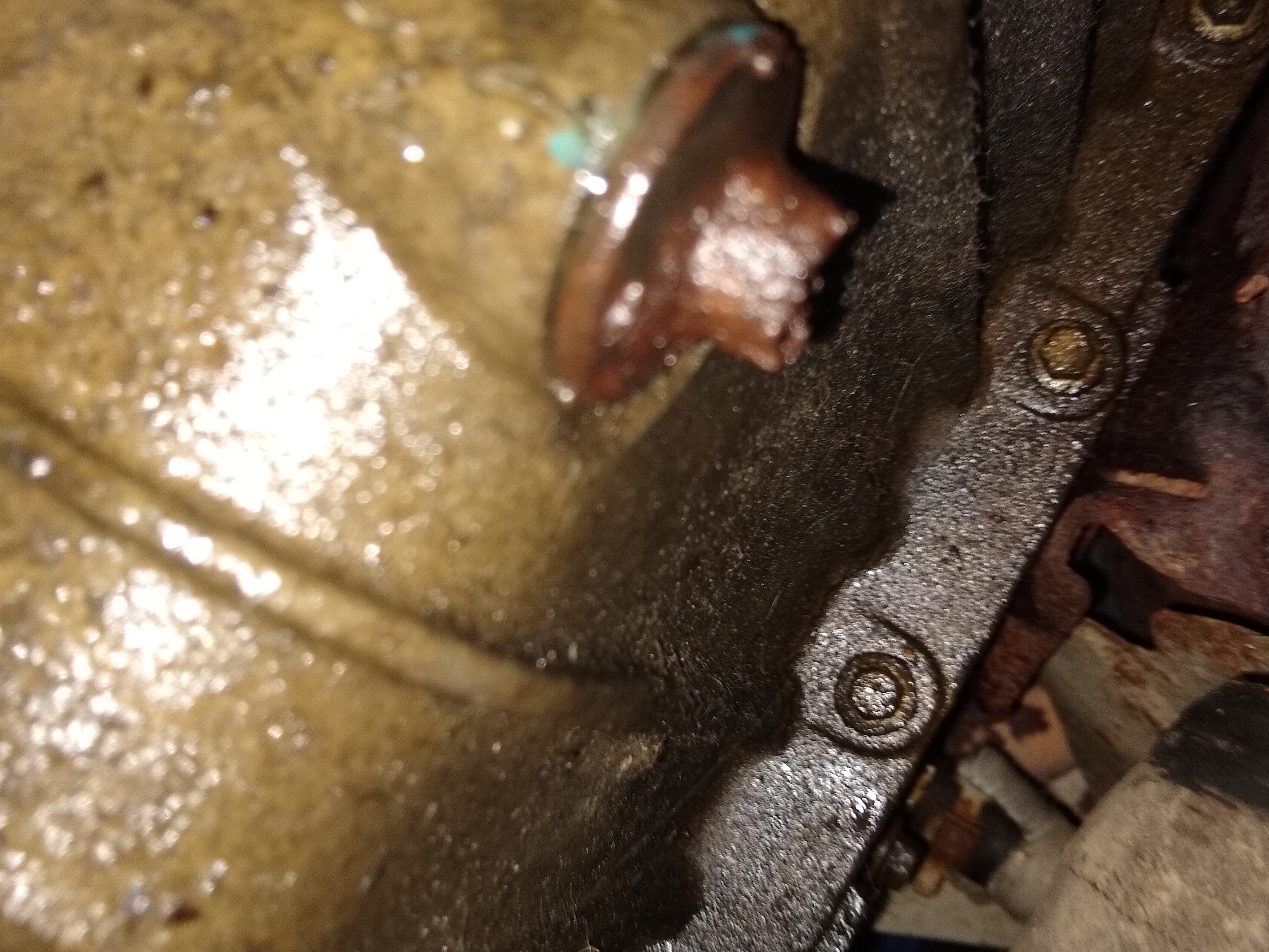

It is badly mangled. I think it is made of quite soft mild steel which is why it chewed up so easily. I will try to get a picture today.
Sorry for the delay. Here is the drain plug. No hexagon left on it.

My first "go to" on that would be a good quality pipe wrench: https://en.wikipedia.org/wiki/Pipe_wrench. Sorry if I'm telling you how to "suck eggs" KPat and for the benefit of others, if you are going to buy a pipe wrench then spend your money on a good quality product - Rigid, Stilson, Facom, etc - I find the jaws on cheap ones really let them down, either not hardened enough so they don't grip properly or over hard and brittle. Once you've used a quality one you'll be convinced.
A little heat round the ally casing and a nice big wrench should have it out I think. A good quality wrench will have nice flat sides to the teeth and I've had success with this sort of thing gripping it on the large diameter rather then on the rounded off hex. Anyway, whatever you try I wish you the best of good luck.
Ps to the above. I just magnified the picture of the plug and can see that the top half diameter is recessed into the casting slightly so you won't be able to get a wrench on the larger diameter. Sorry for my unobservant stupidity! A good Stilson - or similar - applied to the rounded hex would still be my first stop and then, if that didn't work, I'd use a chizel to raise an "edge" on the large diameter and then a flat ended punch to try to knock it round. Some heat on the ally case in both instances would probably be beneficial.
The problem with many 'pipe grips'
Is they often have a jaw wider than the other..
REALLY frustrating when you are trying to grab the 'remnants' of somebody's previous attempts :(

Totally agree Charlie. Sometimes the narrower "Footprint" type work better in these situations and sometimes you just have to get "belligerent" with hammer, chisel and/or punch. This one is nicely exposed so, if it's not being inclined to move, it would be a good candidate for welding a nut too - don't you think? The heat would probably help too.
Yes Jock
I am guessing its now 10 or 11mm in diameter.. so too small for any leverage 'as.is'
An M12 nut should push on.. leaving a 19mm hex for a good single hex socket once the welding has happened
( or half.wind a M10 for a 17hex)
Watch out for electrical disconnection (isolation) if using big Amps
Dont want to fry electronics :(
Thanks Jock.Yes the top half is recessed. The hexagon has already been chewed by pipe grips, Stilson wrench and Irwin sockets :mad:. So next step is some gentle heat and a small chisel on the outer diameter.

For some reason, until your photo appeared I had the impression this was a different type of plug - and we discussed Dormer Easy-out tools momentarily.
For that kind of problem I have successfully used Irwin Bolt-Grips. Be warned though, if you hammer cheap variants on too hard, they can split. (I'd be a bit cautious about hammering around a cast sump anyway - I cracked a very expensive vintage car sump once - but it was 80 years old!) Though you mention these bolt-grips have already been tried - hmmmm...that therefore, doesn't leave too many options and I think we're back to penetrating oil and a good amount of heat
Not sure the price of the bolt grips against a good Stilson wrench though.
EDIT: Could it have been put in cross-threaded? Does it look like its in square or not? If so there may be very little chance of it coming out without chewing the threads up on the sump itself :(

Although KPat mentions that the plug is on a Ford about two pages back, I had started thinking, like you I suspect Max, that it was a female hex - like on our wee Fiats, Until, that is, I saw the picture.
Cross threading or a "pulled" thread due to overtightening is, I would guess, a possibility and I've seen the plug repair kits used very successfully - that is the type where the hole is drilled out slightly larger, rethreaded to the next larger size and an oversize plug installed. For example a 15mm plug being substituted for a 14mm original. https://www.amazon.co.uk/Sump-Plug-Thread-Repair-Re-taps/dp/B01N7L3K19
Whilst on this subject I can also thoroughly recommend this type of thread repair kit: https://www.ebay.co.uk/itm/16-Piece...X-1-25-mm-with-Alignment-Guides-/141430849864 I suffered a damaged thread on the N/S bottom caliper pin on the Ibiza last year - probably my fault I'm ashamed to say - and one of the local wee workshops I'm friendly with has one of these kits which he used to repair the damage. It was so easy to use that if I ever run into this problem again I'll just buy a kit for myself.
