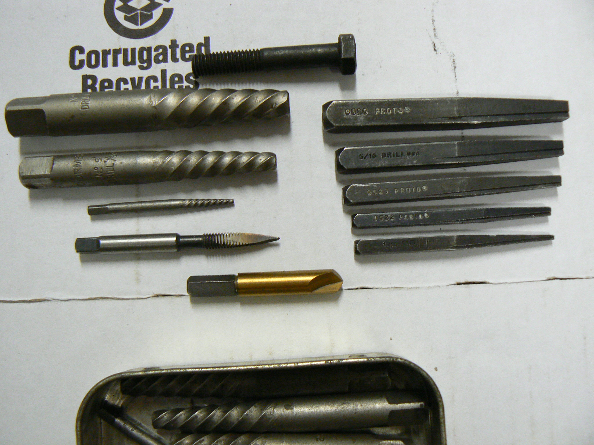

Here's a wee "pick and mix" from the tobacco tin which holds my screw extractors:
The ones on the left are indeed Dormers which feature the usual left handed twist. The fluted ones on the right are a set of Protos I bought when I went tool shopping with a chap I know in Southern Maryland, a very interesting fellow who was my daughter's neighbour and was rebuilding a Mk1 Corvette. I spent many happy hours neglecting my grandchildren helping him in his lovely large garage/workshop. Oh how I envy him that garage!
Here's a close up of the Protos:
As you can see they have no reverse thread. As I'm sure you'll know Max H, but for the benefit of others, you use them by drilling a hole into the stud in just the same way as with the Dormers (better quality tools of this type will have the recommended drill size on their shank). Then you tap the tool into the hole with a hammer until it's flutes bite into the stud. The only comparison I would make between them, and both work well enough, is that if you have a very tight stud then I find the reverse screw type (like the Dormers) will screw themselves more and more deeply into the hole. The unfortunate outcome of this is that it spreads the stud and tends to lock it even more firmly into the hole! rather like a Timesert. The fluted design doesn't do this and I think I slightly prefer them - not much in it though.

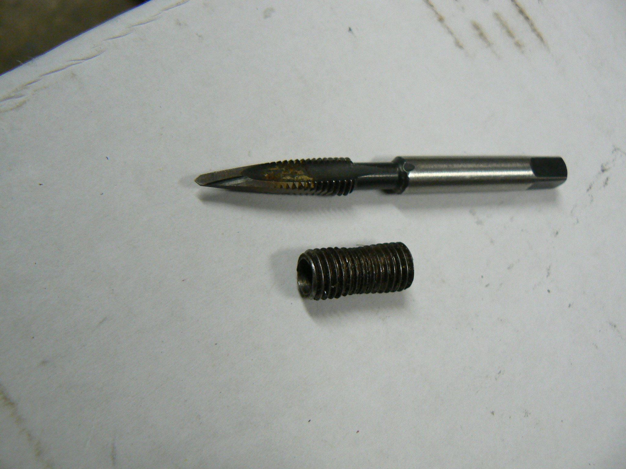

I once made one out of an old thread tap to remove a bit of broken screw from a carburettor. It's the one at the bottom of the 1st picture - here's a close up, including the bit of stud:
Must be over 30 years ago, wonder why I kept the bit of stud? In fact that was a one off, I've never used it on another one.
I also have a couple of things that look like the end of a reverse cutting drill - there's one at the bottom of the first picture. The idea is that if you have a damaged Allen screw head (or similar) the reverse twist will bite into the head and get enough of a grip to unscrew it. I picked them up at an autojumble. No idea of the make. They were in a tatty cardboard box and look brand new. In fact they still do as I've never had reason to use them!
