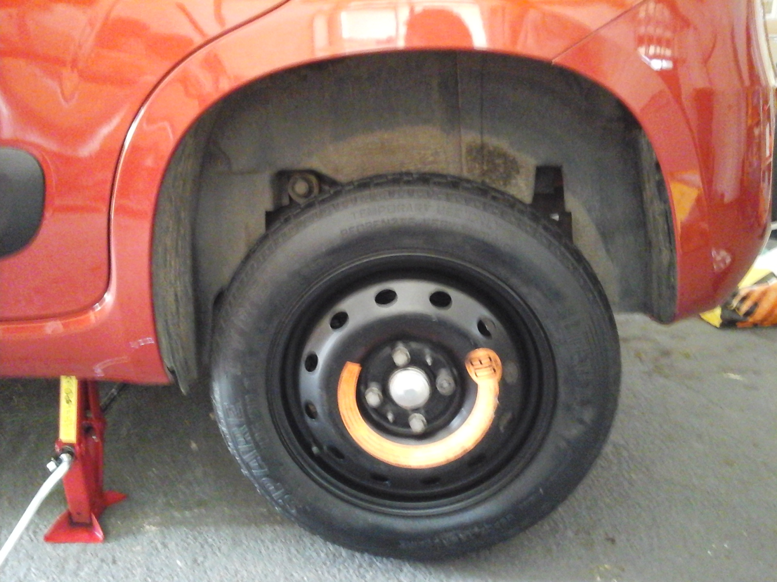

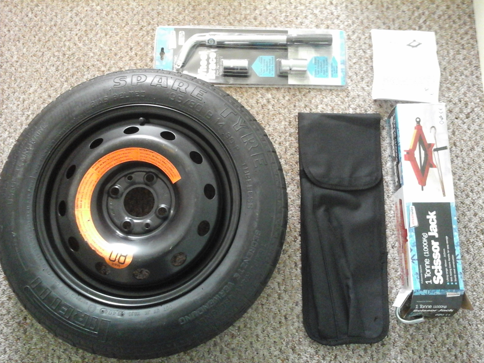

Recently my daily commute has changed and on the new road surface the rattle became annoying enough for me to look for the cause. I traced it to the front off side wheel but when I went to take the wheel off I could not find the security wheel nut tool, (at this point I should mention that the car has only ever been in the Fiat garage and I believe the wheels have never been off the car.
I was left with no other option other than to buy a wheel nut tool ( it was the one size missing from the dealers box of nut adaptors so they couldn't help either)
Today I had the opportunity to take the wheel off and instantly I could see the problem, conspicuous buy its absence a missing spring clip, the one that puts tension between the fixed and floating parts of the brake calliper.
