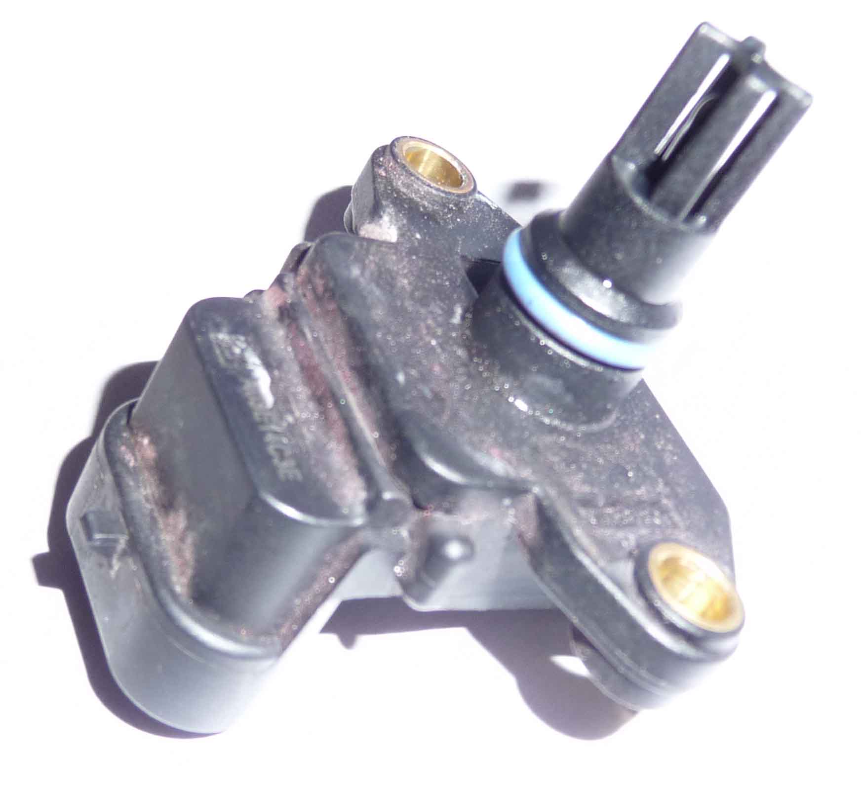

What sensor is this? It is a four pin connector, the rear piece that goes inside the inlet manifold was covered in petrol when i removed it
