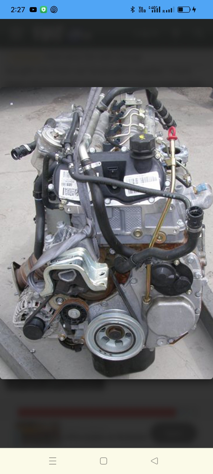

I found this thread very useful when replacing the water pump on my 3.0 l Ducato recently. I can say it is a difficult project but can be done by a DIY handyman with basic tools and a few extras that make it much easier to do. First off here's a photo of the engine showing the engine mount (the bright silver stirrup bracket).
The water pump sits underneath the engine mount. You can just make out the pump drive pulley underneath the mount. It is the higher pulley on the aux belt route.
So the first part of the job is getting access to the engine mount. As described in earlier posts, the windscreen washer and right hand headlight need removing and the steering pump reservoir tied out of the way.
More later...
Before moving on I should point out that the engine does not need to come out. The photo is just to show the layout of the different parts.
After removing the right headlight, remove the bracket that supports the header tank and power steering bottle. Remove the header tank hose to the water pump and the breather hose that runs close to it.
Now support the engine from underneath and undo the 3x18 mm bolts that bolt the mount to the water pump. Check the motor does not drop too much as these are loosened. When happy that the motor isn't going anywhere, undo the 3x18 mm bolts that bolt the mount to the chassis and remove the complete engine mount.

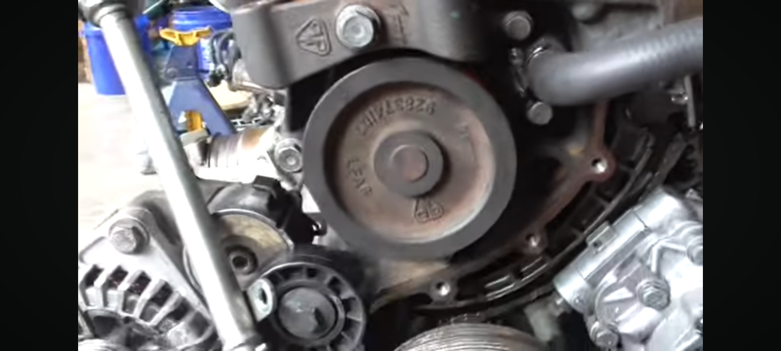

Now you get a good view of the water pump. There are 5 bolts to remove. See the photo below. The first two are either side of the inlet from the header. Then there are 3 15mm bolts 12 o'clock, 9 o'clock and 6 o'clock. The 6 o'clock one is the hard one. I used a 15 mm socket on a long 1/2" drive tee handle. A torch allows a slight glimpse of the bolt head between the drive pulley and the block.
Once the bolts are out, a tap with a mallet should free the old water pump. Remove the rear hose and pull the pump out from above.
Clean up the face ready for the new pump. Now is a real good time to check the belt tensioner. Mine was frozen solid. If you get a spanner on the idler bolt and turn it as if tightening the bolt, the idler should arc down towards the crankshaft pulley so you can get a new belt on. If it doesn't budge, you can remove the complete tensioner by undoing the 8mm allen head bolt.
Once the tensioner is ok then bolt on the new pump. Fitting the belt is much easier with the engine mount removed so that is the next step.
