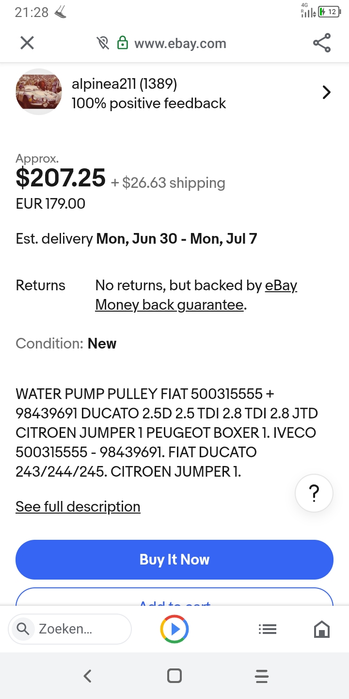

Hi everybody. I have terrible problems finding a new pulley for the waterpump for the 8140.43S engine.:cry:
No luck at Fiat or Iveco.
No luck from Aubiri and their suppliers
My lovely Duce is eating rib belts (generator,waterpump, crankshaft) like a teenager getting free chicken nuggets.:sneaky::sneaky:
I have a new pulley on the crankshaft, new idler wheel, putting on a new pulley on the generator tomorrow and I want to change the pulley on the waterpump also.
The old one has done about 400.000 km, so it's probably pretty worn.
Original Fiat spareparts no. : 500315555
Any and all links or sources would be highly appreciated.:love:
Renault, Citroen, Peugeot also used that engine.:)
