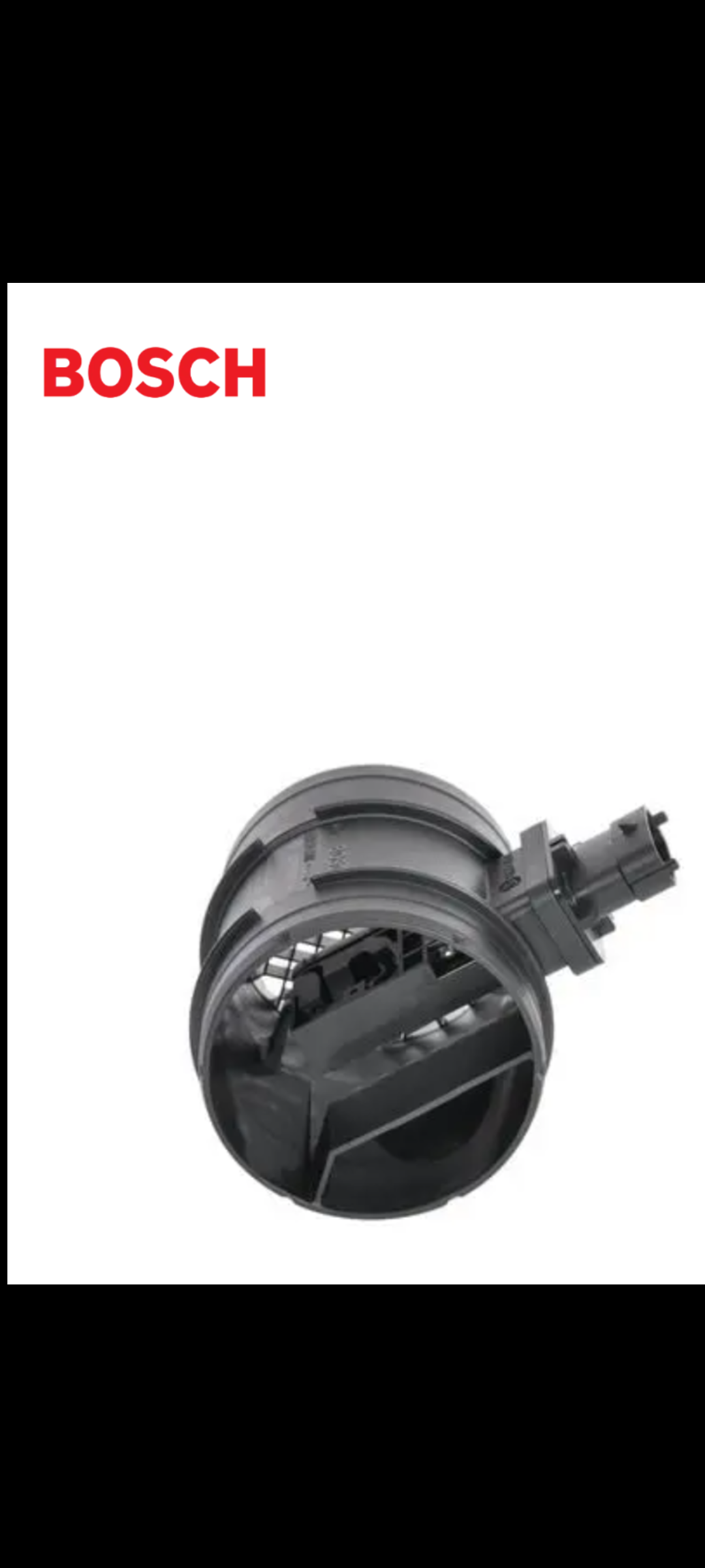

Hi. I have a 2013 Fiat Ducato 3 litre 180hp. It keeps throwing up a code P0095, Intake air temperature sensor 2, circuit bank 1. I've been deleting it, and forgetting, but it needs tackling.
Can anyone point me in the direction of where this sensor is?
Much appreciated.
It is the MAF sensor in the pipe on the side of the air filter housing.
Remove, spray & refit connector.
Remove MAF and clean with MAF sensor cleaner.
