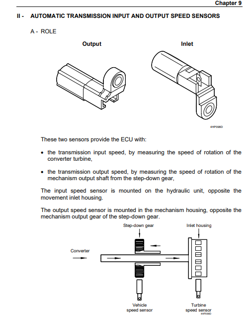

Hi, to install Zemco cruise control i need to connect the bleu speed sensor cable to the car wiring loom. Manual states location below fuel filter bleu wire comming from speed sensor on the gearbox. On a automatic transmission (4HP20) there is no speed sensor on the outside of the gearbox. wiring diagram of gearbox control i can not find . I guess the gearbox control unit also needs this signal so i can get the signal from that. Any help would be greatly appriciated.

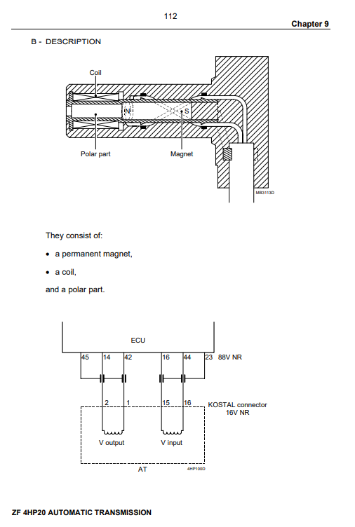

update , found a Xantia manual on the transmission, speed sensor is located inside transmission and connected to ECU ( see attachments)
still no idea where to connect my blue wire...
