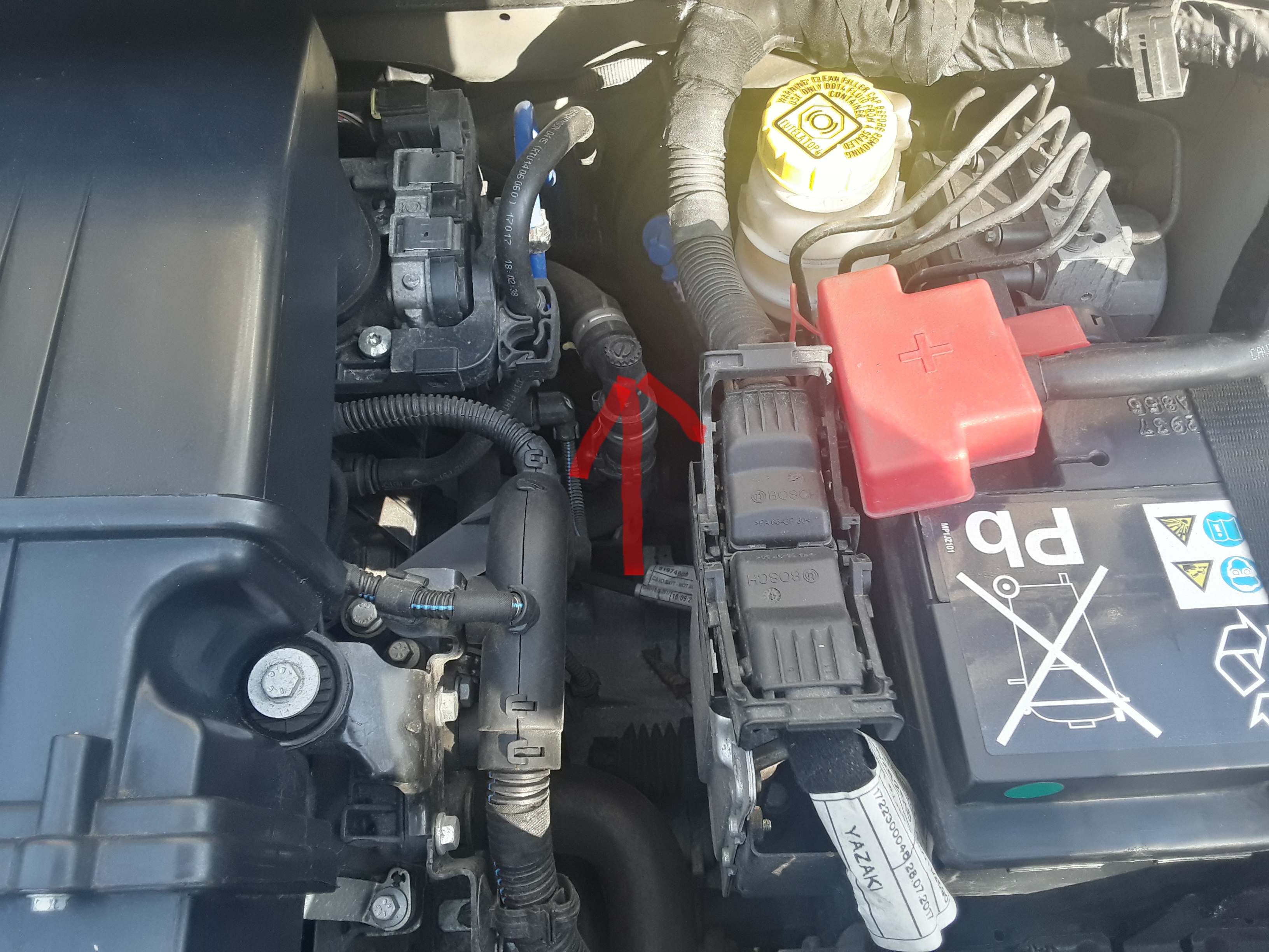

waterleak, could this be a simple leaking hose or is it the housing gasket, or could it be something else, has anyone had the same issue

Give it a good clean..
Then dry it.. and put kitchen towel across it
You should see where gets damp 1st
Tricky to see from the pic.. that could be red sealant smeared around.. or red coolant :eek:
Do you know if that has been apart?

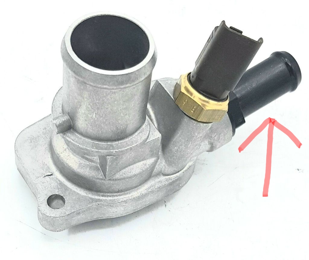

That looks like the warning sign that the thermostat is on its way out, it is quite common on the FIRE engines. The hose starts to sweat around where it joins the thermostat housing resulting in the red anti freeze residue in your picture. On the 1.2 the housing pipe that the hose sits on is plastic which goes brittle over time, I would imagine the 1.4 is the same. The residue is the warning sign to change it now but if it is left unattended eventually the plastic pipe on the housing will collapse resulting in coolant being dumped everywhere & if not switched off straight away can cause head gasket problem or worse case scenario cylinder head problems. The part itself is cheap & not to differcult to change as the Punto engine bay is quite roomy. The thermostat & housing come as one unit & then once it is changed you need to bleed the cooling system.
Here are clear picture of the of the thermostat of a 1.2 which will be simular as it is the same engine
This is the plastic pipe that goes brittle resulting in anti freeze residue then will eventually collapse
