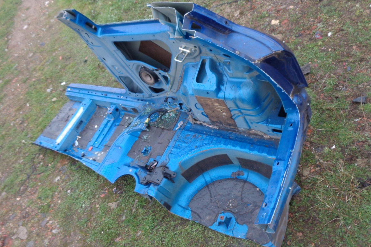

My 3 door. Has had water dribbles showing across the Bonded in rear windows (its a leaky car.)
Wheel well is often swimming
The panel sealant is a common failure..
But on a 2015 that is relatively new..
My 2012 is the dryest out of my 4 x 199 bodies (the Alfa seems OK..)
That's a 3 door grande punto rear quarter.
An impressive photo! Looks like someones been doing some structural work. How did you find the photo?
I've not come across this one, but its a defintitely maybe.
From a breaker, this quarter is for sale.
