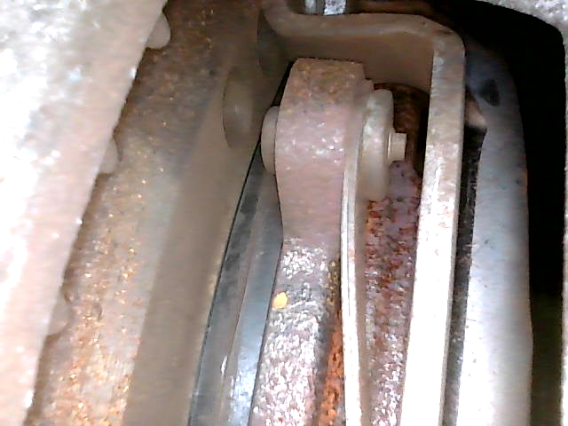

My Grande Punto developed a metallic rattle which I went looking for today. I found the source of that problem, the oxygen sensor on the exhaust out/down pipe had come loose, it was easy tightening it up. But then I found a small oil leak. Its nothing major at this time, there is a small amount of oil just under the flywheel casing. See the picture, i've had an oil leak from there before which turned out to be the sump, but i'm also aware that the rear crankshaft oil seal is there. I've tried looking but I just can't see where the oil is coming from.
My question is; how do I check the rear crankshaft seal for a leak?

First you clean everything well, then wait (watch) for the leak, pinpoint the source.
Look like you have just an axle leak (it's wet on the picture)...
Use cheap USB inspection camera/endoscope, put it into bell-housing (inspection rubber port), see if it's wet inside.

What do you mean by "an axle leak"?
I looked for an axle leak but couldn't find one.

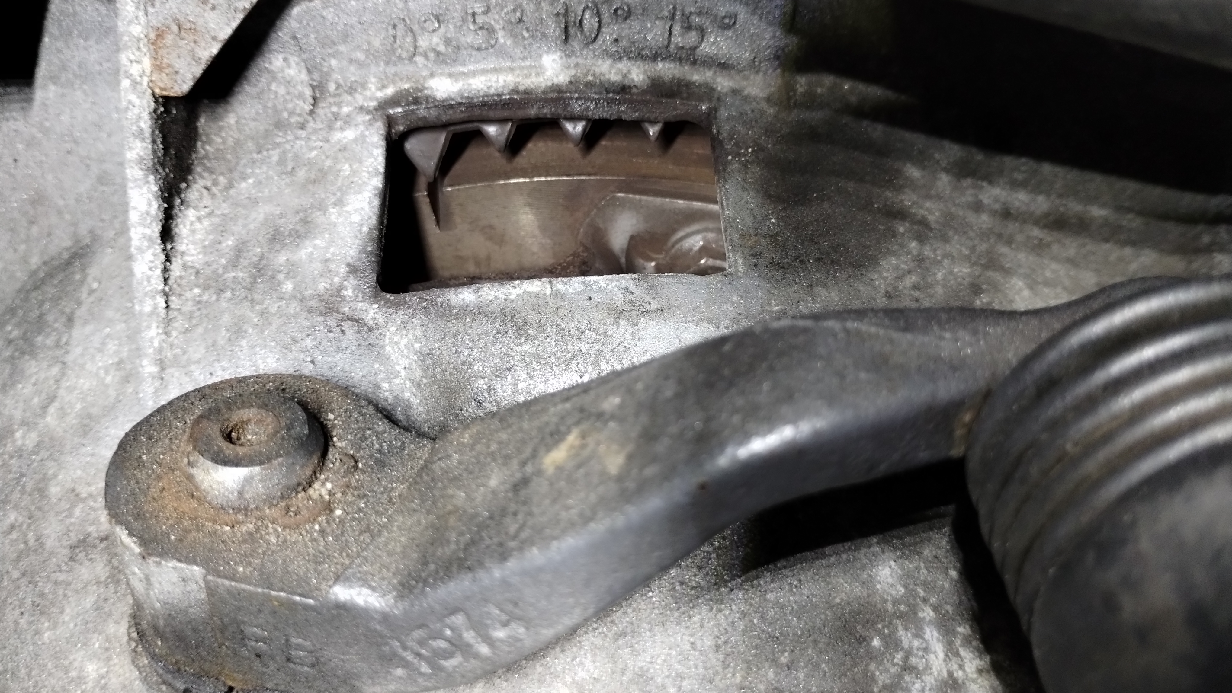

I opened the clutch inspection port and tried to use a camera, but there was so much metal in the way I couldn't get anywhere near the rear main oil seal. Is there some trick to looking deeper inside the clutch? The inspection port doesn't look terribly useful but it must exist for a purpose?
In an irony I've found an axle leak, not on this car but my other one. It looks black and doesn't really have a strong smell, so I need to get the wheels off and clean it etc. It doesn't look like enough of a leak to fix. Maybe i'd need to top up the gearbox oil though.
You have no hope of seeing a rear crank seal. Your only clue is engine oil from the flywheel area is the crank seal, gearbox oil will be the input shaft seal.
You'll know oil type by smell.
Advice was to put the USB camera into the bell, deeper, so you can see the bearing and even more, bottom of the bell-housing (if There is a wet spot). You can see the operation of the clutch bearing. Pretty useful (not all cars have this feature).

The original purpose of the window was timing belt setup at TDC in older Fiats. Now we have locking tools (away from TDC). Is this all new to you?

This is all new to me and I opened the bell housing rubber inspection port for the very first time in my life today. My picture shows the port, you can just about see some teeth on the left. The problem I had was that there was metal blocking me from putting the camera in any deeper. Maybe I should have taken it out of gear?
The gear selection will have no effect on what you see in that port.
Maybe a small change if you press the clutch, given you are looking at the clutch and flywheel...

You can stick a finger through that inspection port (engine OFF!), and feel the inside of the bell housing. It'll be filthy. Dry and sooty OK. Wet and oily something's leaking (give it a sniff).
