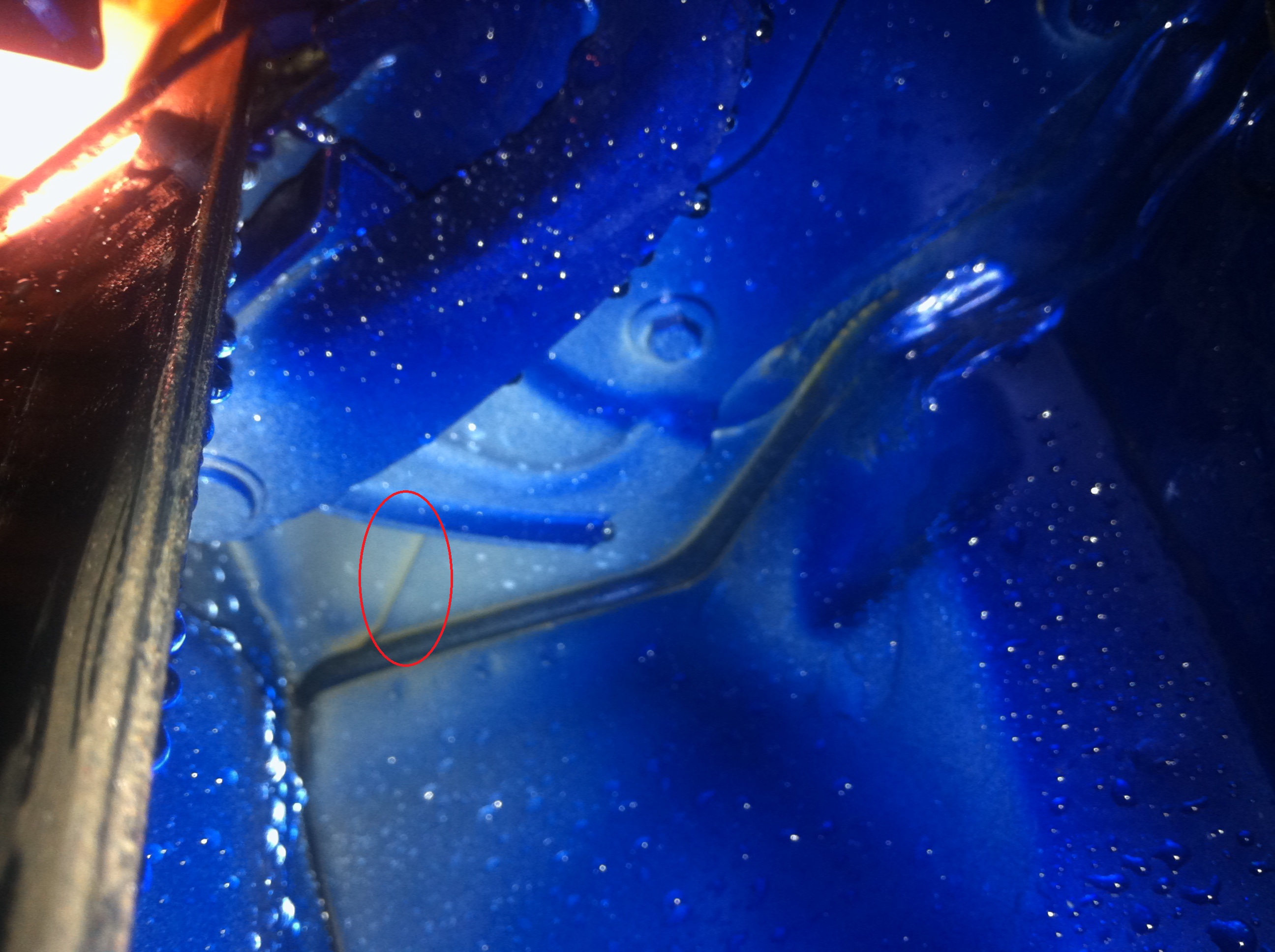

So I removed the wipers and the panel under the wipers (lost one of the front three clips and broke another one - the centre part is supposed to unscrew, but it didn't :mad:), and then I spotted a poorly-sealed seam behind the bonnet hinge, left side. This is a terrible area to try and photograph, as it is obscured by the hinge, but if you see the unsealed seam in the red circle below, and imagine that extended forward behind the hinge, that's the area that lets the water in.
After checking the floor was still dry, I hosed water just into that seam. Bingo, a significant puddle quickly appeared on the floor. What satisfaction! :rolleyes:

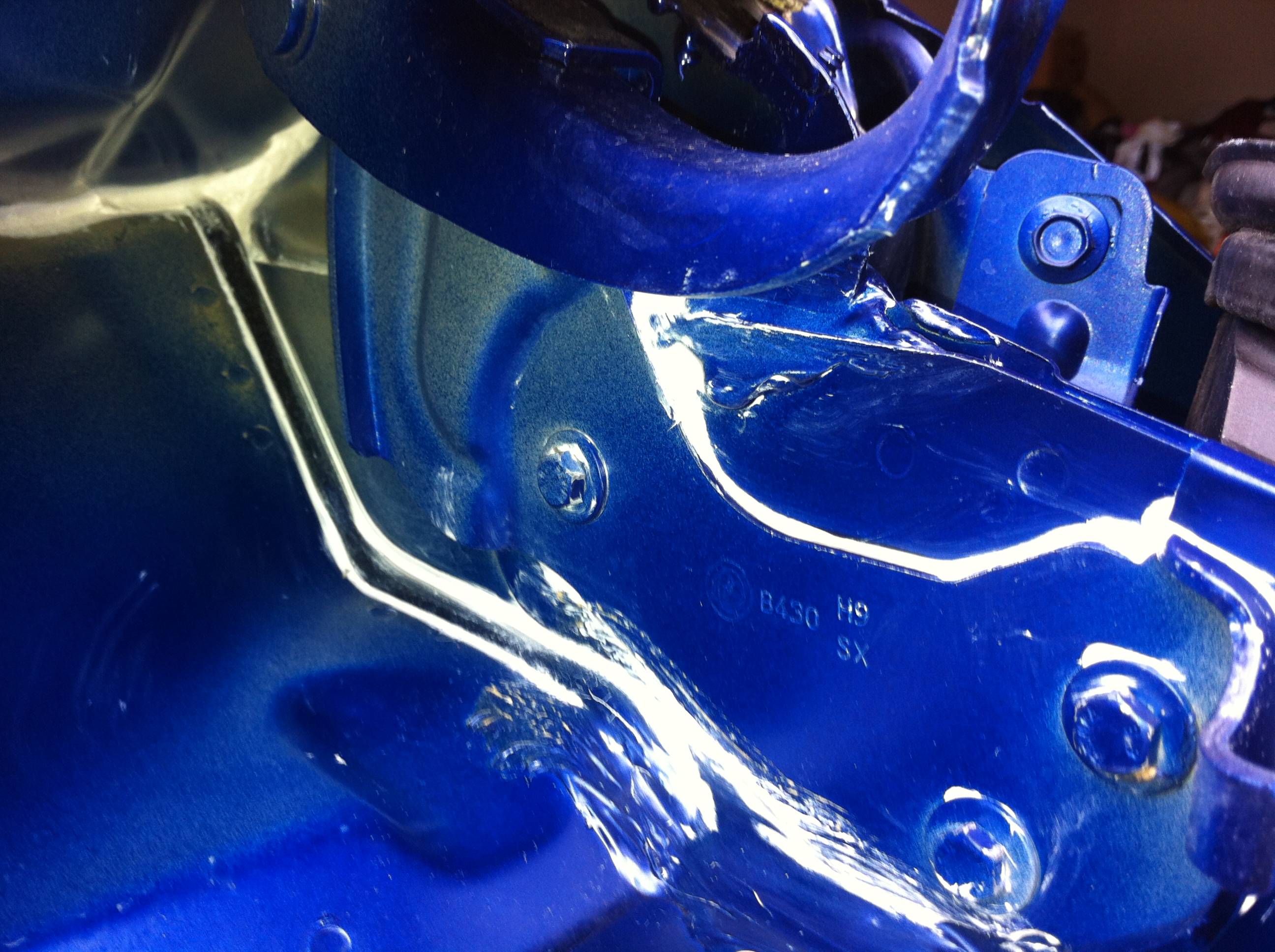

Meanwhile - good news - yesterday I sealed my seams and it's rained almost constantly since, and NO water in my footwell now, so I'm a happy bunny and ready to carry on with my sound-deadening/trim reinstall.
Still can't show it very well in a photo - the culprit was the small horizontal seam running back from the hinge to the bulkhead, which originally had no sealant at all. As you can see, I removed and sealed around the bonnet hinge as well, and smoothed out the other sealed seams in that area, going across under the windscreen too (not shown here). I removed the bonnet, which meant cracking the paint on the bonnet nuts, but it was worth it to get proper access.
I used white Sikaflex made-in-Japan overpaintable polyurethane sealant intended for this application. I used a great number of paper towels cleaning up with mineral turpentine - a protruding big fat bead may look more OEM, but I decided a minimalist approach is better - less likely to trap water or crack and fall off.
I will wisp some blue over this with an airbrush at some stage as I know the white looks ugly, but thought it best to solve the problem first and worry about appearance after that :p
