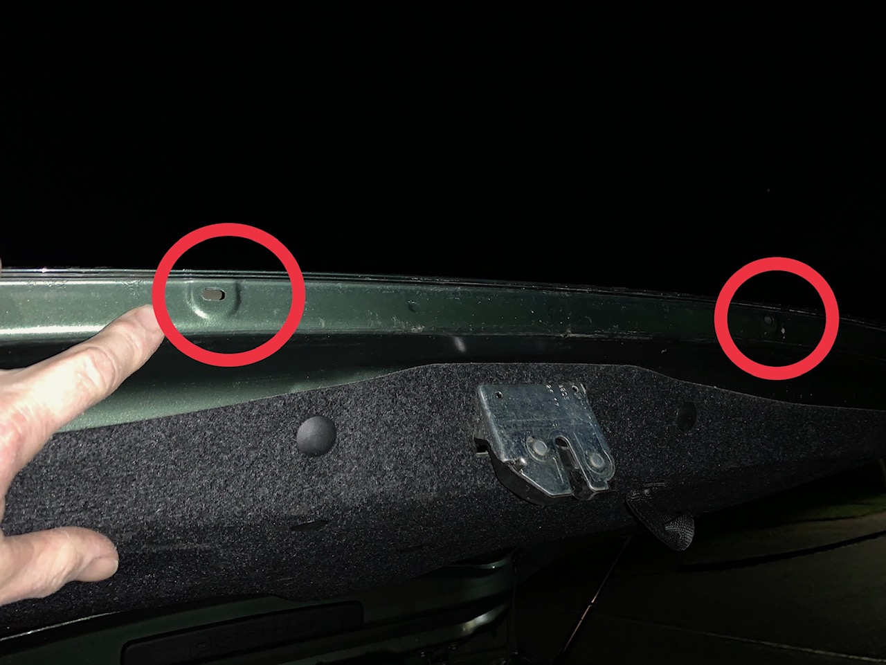

There are two drain holes in the very bottom of the tailgate edge (when shut), which drain outside beyond the rubber seal of the tailgate opening, so water should not be able to back up as high as where the bump stops (buffers) screw into. Are those drain openings clear. Unless either (1) someone's filled the tailgate with wax (which will block them), or (2) a lot of dirt has got inside there and clogged the drains, there's no way it should hold water. With the tailgate open, the drains holes are a short distance either side of the boot latch. It's dark outside so this photo might not be too clear, but might help. And how is it getting so full so quickly? I know it's rained recently, but enough to fill up a part of the car that is pretty well protected from water ingress? I still say check the washer pipes...

Yes checked these even taken them out - again just to double check they were clear - all good 😁

Nope mine have a plastic plug in drain cover, it’s just a pressing so clip in out as easy as owt.
Something and nothing of a clip , it’s all clear as I’ve put my endoscopic camera down as well.
You can see it’s clear from the inside too.
