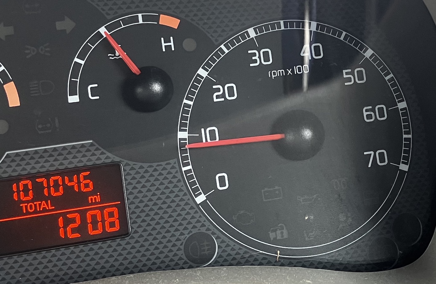

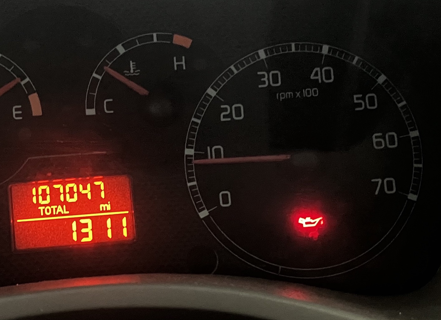

Our Baby Panda has some warning light issues.
Any ideas about what is going on?
All on the same afternoon. Switch off, and try later.
Yes, the oil level is fine, and yes, the car drives well.
107,000miles.
I plan on taking it to the local garage so they can check out the warning system.
Mick.

Random warning lights
Where to start isn't going to be easy
Oil pressure switch ---> ECU - - - > BSI - - - > dash
Airbag + switch - - - > airbag control unit - - - - > BSI - - - - > dash
ECU engine management computer
BSI body computer
I see the time and date is kept so battery isn't falling below the threshold to keep the real time clock alive
Dirty or slightly corroded connector dash or body computer would be my guess
We had some heavy rain lately, has any water entered the fuse box. Is the carpet wet near the accelerator pedal

The oil warning light would be the one that would "worry" me. Is it illuminated when the engine is running? If so I'd advise caution. It should illuminate when the oil pressure drops to such a low pressure that damage to the engine can be expected. The advice therefore would be not to run the engine until checks have been done to ascertain whether it really is low oil pressure or an electrical fault.

If the oil light was the only light that had come on, I would believe the oil pressure was low, but as the airbag lights were on without the oil light being on, and after re-starting, they didn't show and then the oil light came on ............... I somehow think it's crying wolf.
Back soon with an update.
Mick.

Update.
Disconnection of the battery seems to have cured the oil light issue, but not the airbag issues.
The clock needed to be re-set, as did the radio/cassette needing its code. The car did not remember the code, so I had to manually input it. The clock can only be advanced by pressing and holding the "up" button, and it increases by the minute from 00:00. It took a few minutes of holding the button for it to advance to 11:07 after I got into the driving seat.
Repeatedly switching off and restarting, the airbag lights didn't go off. However, by leaving the ignition off for the count of ten seconds and then restarting, all the warning lights were off.
I went for a drive with the doggie on the back seat (clipped in) and went for an hour's walk in Blanchdown Woods, and then driving back, both airbag lights came on. Stopping for the count of ten seconds and then restarting, they were off.
The oil warning light wasn't showing throughout.

A question for anyone "in the know". Does the oil warning light/sensor circuit go through a processor or is it just a straight to earth through the pressure switch on the block? I thought it was just a "good old" straight to earth?
Edit. If you really do have a genuine low pressure problem and you're continuing to drive it about as you are, I think we'd have some "nasty knocking noises" making themselves known by now?

As for the oil light, I suspect that it's connected to a pressure switch as the car starts up. As our drive points uphill, the oil level could be high.
Point it downhill, and the level is lower. This is a point worth considering methinks.
This afternoon, I topped the oil up to the Max mark with the car on the level at the bottom of the drive. Hopefully, this is the end of the oil pressure problem as since then, it's fine.
