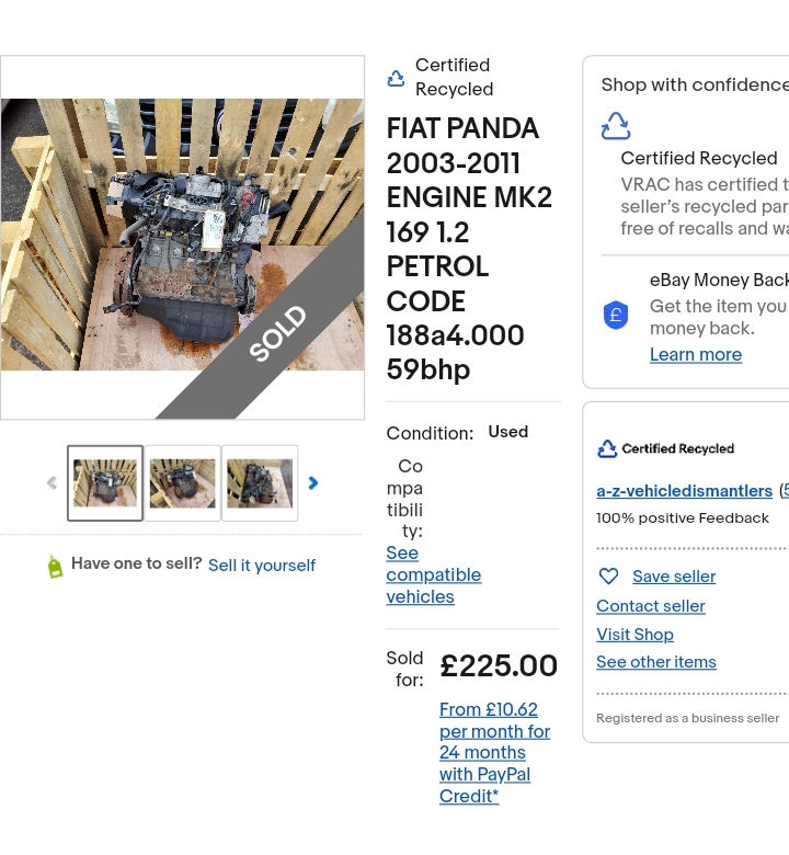

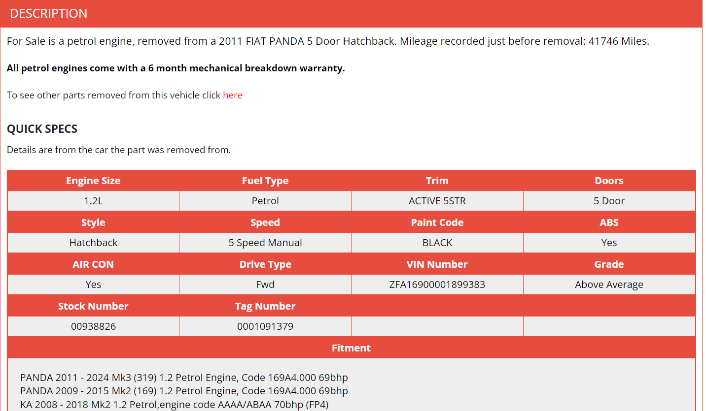

My missus works at the vets in Broughton she knows nearly everyone LOL. My mechanic now suspects the engine might have blown a ring because there is oil on the bottom of the replacement throttle body. If the reprogramming was going to be under 50 quid it was worth a gamble but if the kit is over 100 quid then he thinks it is a good money after bad scenario and I should just get a replacement engine. So got an engine of Ebay from Carlisle 2008 74k for £225 plus £75 delivery with a 30 day warranty. He will stick a new clutch in when swapping the engine as it would be daft not to he said. (Will he do the timing belt as well? I forgot to ask) I have known this lad since we were kids he really knows his stuff 99/100, salt of the earth, but this one has had him scratching his head a bit. Thx everyone for their help and input :)
Is that engine from a panda?
I guess it's this one
It's not a 69HP
2003-2011 is wrong
There are 3 major changes in design
Some minor changes throw in
Swapping a none VVT into a car where the ECU is expecting the Cam to advance will be fun.
As in unless you have the knowledge to reconfigure the programing of the ECU it's probably a none starter
It's not a 69HP
2003-2011 is wrong

For a direct swap it has to be like for like
The panda didn't get this engine till quite late on, so any from a panda will be quite expensive
Not sure if any from other models fit, possible
There normally easier, quicker and cheaper to fix
Personally an unknown, at a garage it would be worth starting with a compession test and see what we are starting with
Could this be the correct engine
No problem

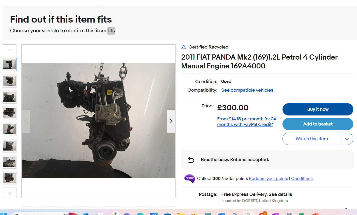

Will ask about the compression test tomorrow. As a back up is the correct engine https://www.ebay.co.uk/itm/395080445854
It could be; this is the Euro5 69HP 1.2 engine fitted to the Panda from around mid-2010.
BUT
this engine is going to need a bit of work before being refitted. Just from a superficial look at the photos:
- the sump is seriously corroded and may even be leaking already; it should be replaced
- there is a missing exhaust manifold attachment stud; it's impossible to see if it's broken inside the head, or if the threads are in good order
- the external coolant pipe from the water pump is seriously corroded and needs replacing
Add to that, a new cambelt, water pump, clutch, auxiliary belt, and fixing anything else that's broken that I haven't spotted .....
Nothing particularly difficult for someone with strong DIY skills, but if someone else is doing the work, it all adds up.
The garage you're proposing to use doesn't appear to have any Fiat specific knowledge; they don't even have FIAT diagnostic software. I wonder just how capable they are going to be at sorting out the inevitable issues that are going to arise when fitting this.
So you've paid for the engine, and they spend a day (or two) messing about with it, and they can't make it work. You're down the cost of the engine + delivery, and then who pays for their time, and just how much hassle is it going to be to sort things out?
If I were to list all the possible ways this could go wrong, I'd exceed the forum's limit for the post length.
Go back and read my previous post again, and think carefully if it's worth the risk of going down this route.

Thx for the advice. The cost (IF it goes well) will be, 300 engine delivered, engine will be fitted for 300 to 400 cash depending on what issues arise. Plus a new belt, clutch etc and the other things you mentioned but some bits will be taken off the old engine. Probably looking at a grand is what I am basing my decision on. Talked to a couple of other mechanics (without specific fiat knowledge) and petrol heads and they all say more or less the same that it is basically a crystal ball job.
The sump not weeping yet
Coverd in muck with a few scabs, you will not know until it's cleaned up
The coolant pipe looks fine, it's 10 years old, it's in better condition than most, it's just not hidden away under the heat sheild
The exhaust stud is a slight worry, good spot @jrkitching 👍 if you look at the photo of the engine number it looks empty, but you can't tell if the threads are okay
I suspect the nut and stud came out together, which is pretty normal
