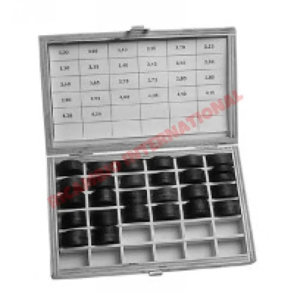

Where is best to get a set of correct shims?
I don't mind buying a set of different thickness shims as I'll be doing more Fiat stuff in the future.
A full set isn't cheap, even an aftermarket set will set you back multiple hundreds of pounds. Unless you are going to be doing a LOT of this kind of work, it's best to just buy what you need. You'll also need a decent micrometer, unless you already have one.
Ouch £240 and you will probably only use a few of a certain size!
Do they sell individual sizes?
I would definitely measure the existing ones and see if they mostly just want refitting in original positions, if some are tapping after grinding in which to me would close up the gaps, then I would say you have them out of original order.
Individual shims can be bought from multiple sellers on ebay; expect to pay £3-£6 each, but quality may be a bit of a gamble. This is a highly stressed part and you don't want to be fitting cheap rubbish. If you've a franchised dealer nearby, that could be a good place to buy what you need. Sometimes you can reuse what you already have in a different position, but usually you need at least a couple of new ones to get everything set right.
In the past there were many engine reconditioners and you could just pop in and sort through their box of shims with a micrometer and job was done, sadly they are few and far between now.:(
