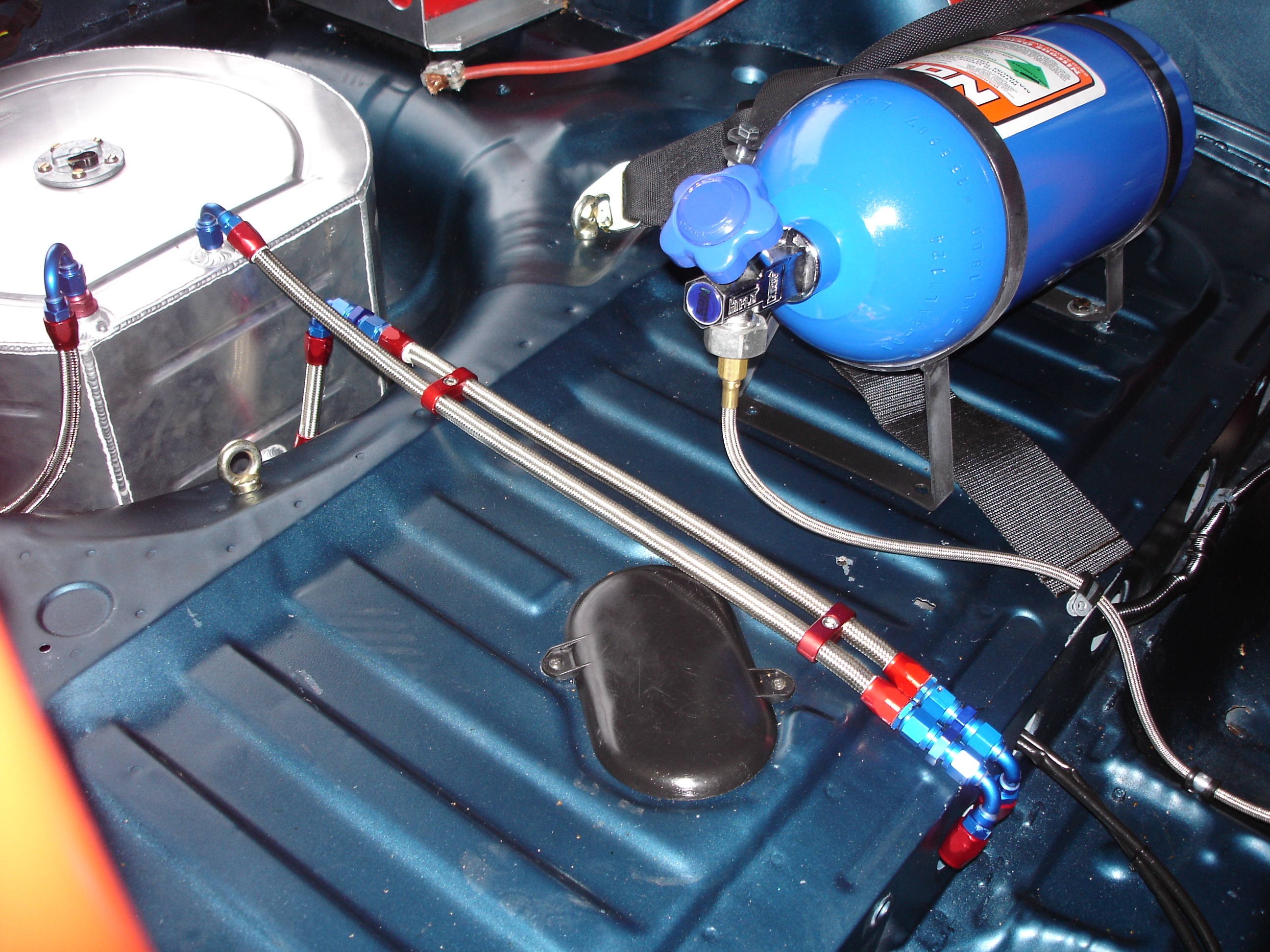

as from my last post, i had bought a few Goodridge connectors, well ive bought even more now and its starting to get very very pricey! but, boy are they looking good! taking a while to do, and im not having much time on it at the moment, but heres what ive done so far :D
just dropped off my tank to have the lugs welded on so i can bolt the tank down finally, then i can get the fuel lines fitted in place with 'P' clips :D
going to buy a new fuel filter and uprated fuel pump, both with the -6 threaded fittings on so i can use goodridge connectors. also going to bring them both inside the car just behind the drivers seat instead of under neath the car.
so i'll have a FSE uprated fuel pump for sale soon which fits straight into place ;)

Looking good, but with all the pro stuff you've got fitted the Mickey Mouse OMP rear strut brace looks out of place. Looking at the picture I can't understand why OMP didn't make the bracket fit to the two solid mounting bolts on the rear towers rather than the rubber mounted shock absorber tops. It's hardly going to be bracing anything when the two mounting points are wobbling around in rubber :rolleyes:
Otherwise looking top notch as usual. 2008 for the UT to rise like a phoenix from the ashes (y)
Re: UT Restoration, New Thread. UPDATED 29/10/07 Goodridge Fuel Connectors
i see where your coming from with the rear strutt brace, and i have contemplated getting a custom one made up and acutally welded in place, but this will have to be done another time.
