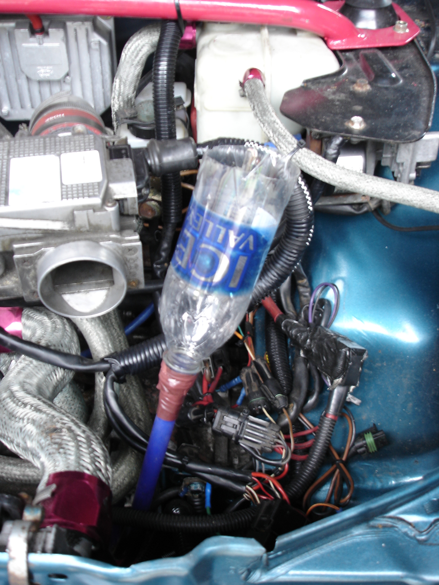

anyway, managed to get a few jobs done. first off, it seems to be crunching as i put it into 3rd gear, and i remembered that i'd spilt loads of gearbox oil out of it! oops! so filled it back up with my DIY gearbox oil filler assembly :D lol
the blue hose goes down into the gearbox oil plug thing. worked a treat!

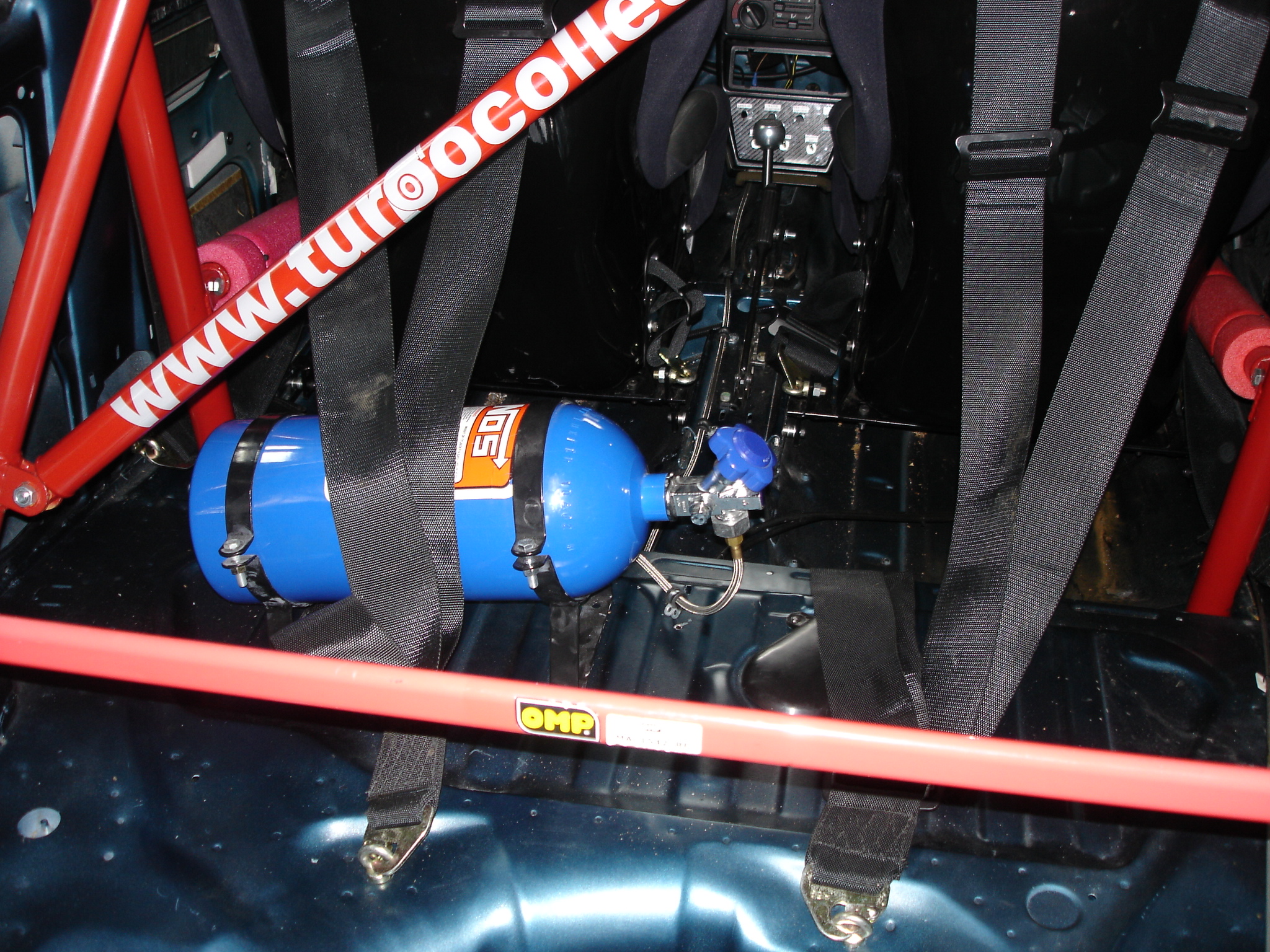

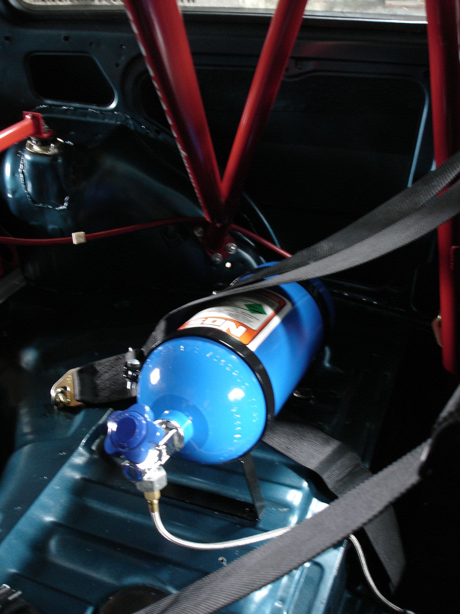

started to refit my NOS bottle and braided line
managed to get it really neat but it took alot of doing!
gotta finish fitting it and get it all wired in. gonna get a auto electrician to do all that tho lol

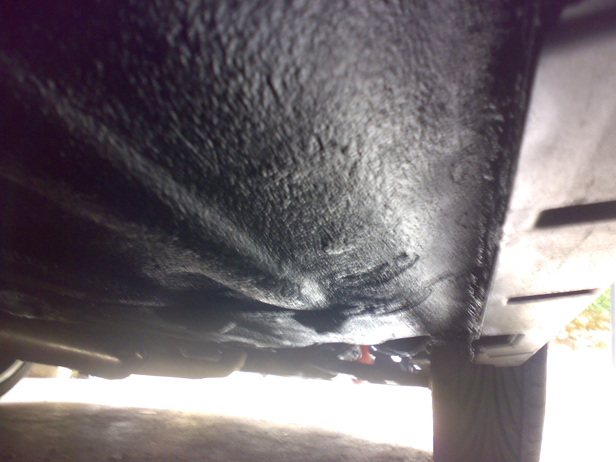

got thursday off work and decided to start the dreaded job i'd been putting off for ages.........undersealing the bugger :(
everyone else at work (mates etc), so no one to disturb me, i thought it was the best time to do it :)

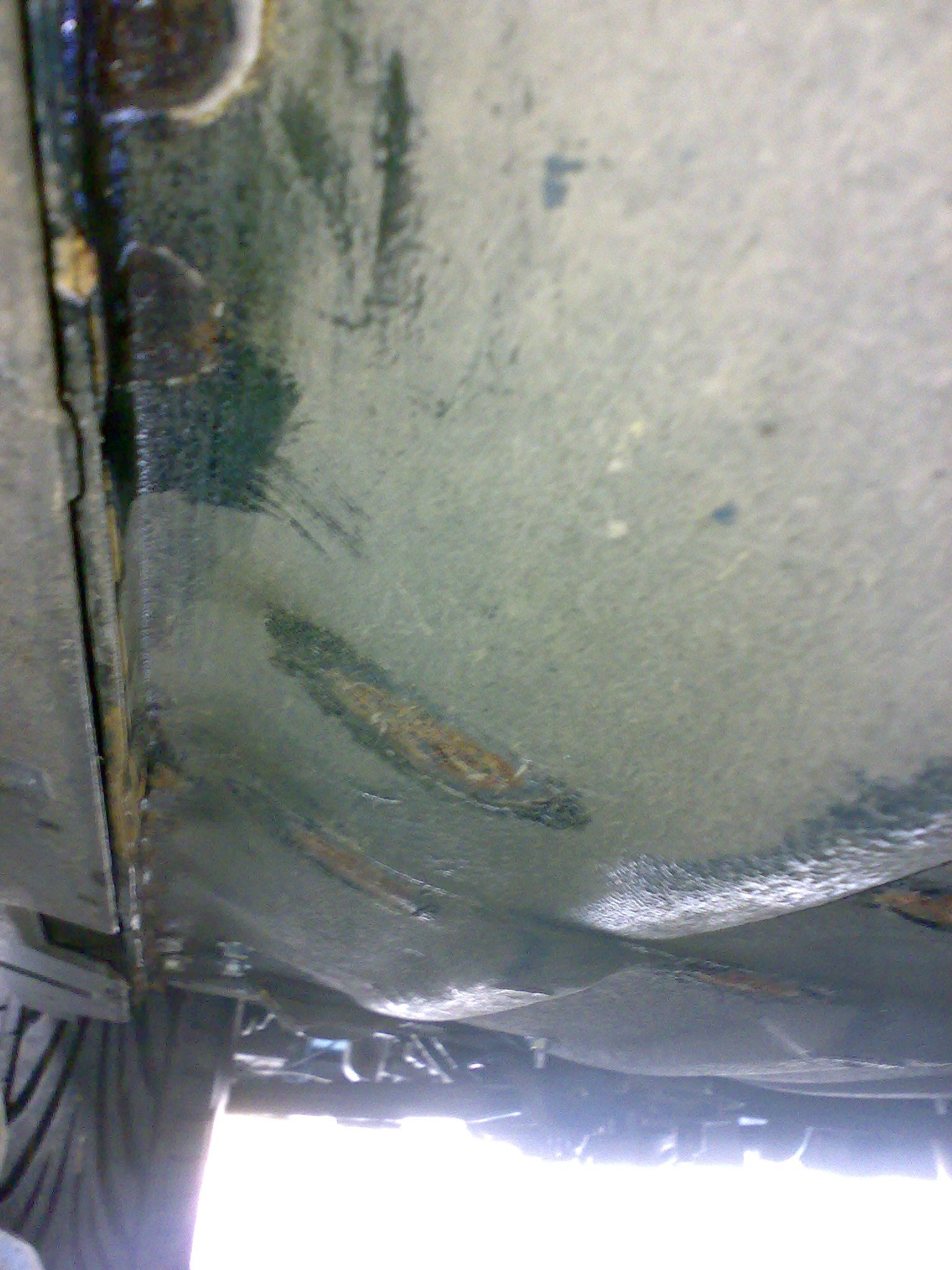

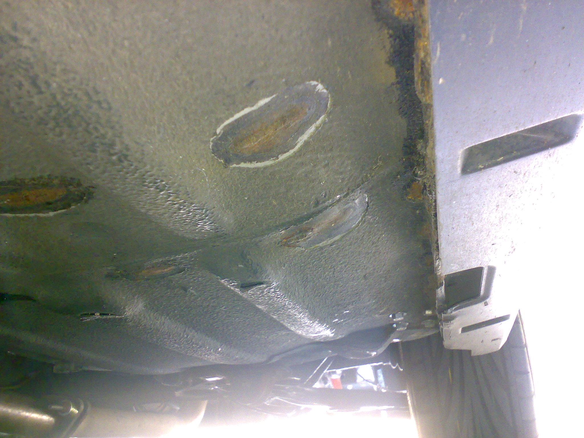

took a few pics before i started. As you can see, the underseal had burnt off in places where the shell had been stitch welded for strength. and i had been putting this job off for sooooooooo long :rolleyes: Now it had gone a bit rusty, but nothing major as u can see.
went to my local Belper Auto Tech, and bought these few bits :D

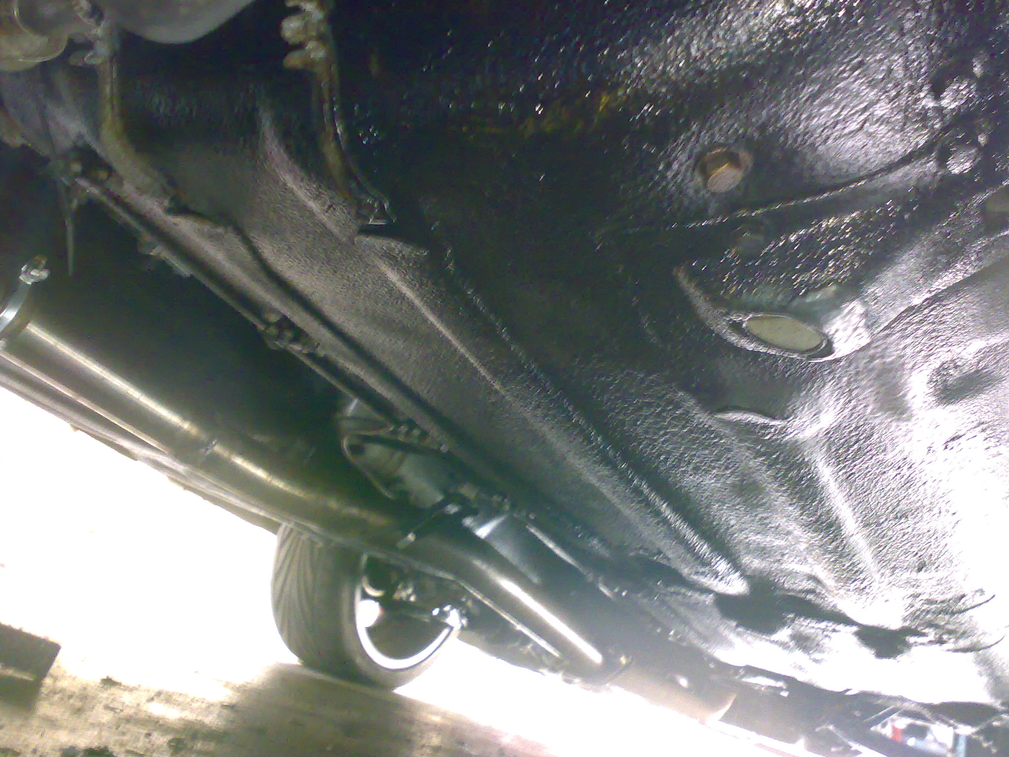

then after some hard sanding, grinding, wire brushing, kurusting and then waxoiling and protecting EVERYWHERE possible, it looked like this :D much better huh? yay!
made sure it got a very very good covering in all nooks and crannies! hopefully should keep the rust at bay!

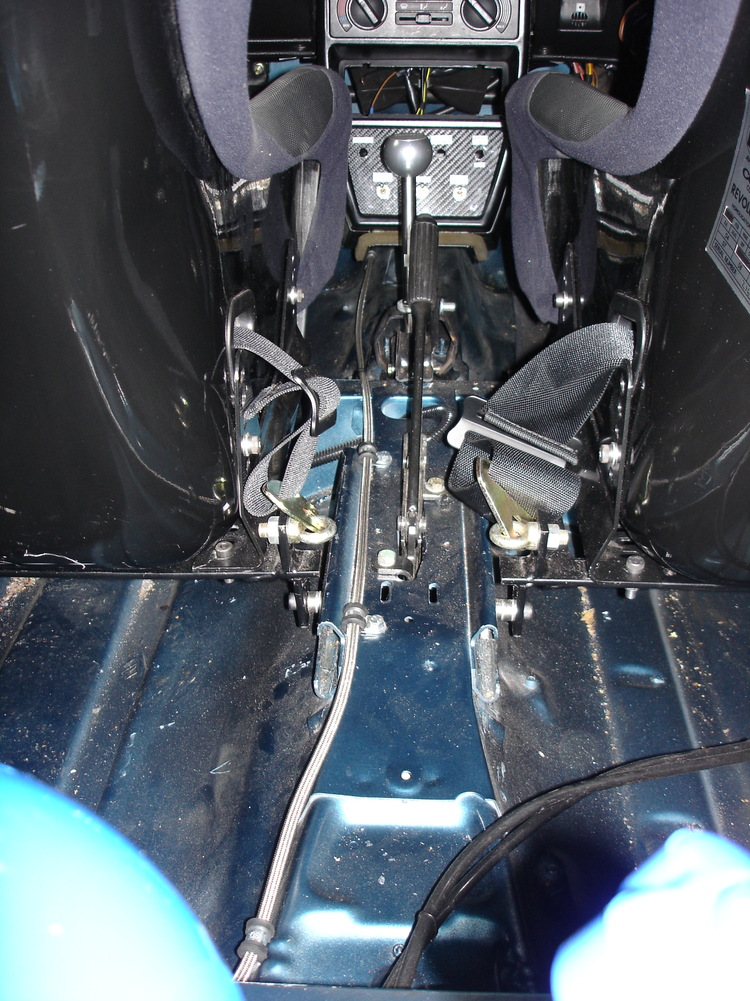

before i set off home, i wanted to stick down my boot release cable as it rattles about when going along. so stuck it down and left some weight on the places id stuck down over nite :) Ypu can see my paddle clutch has come in handy after all :D lol

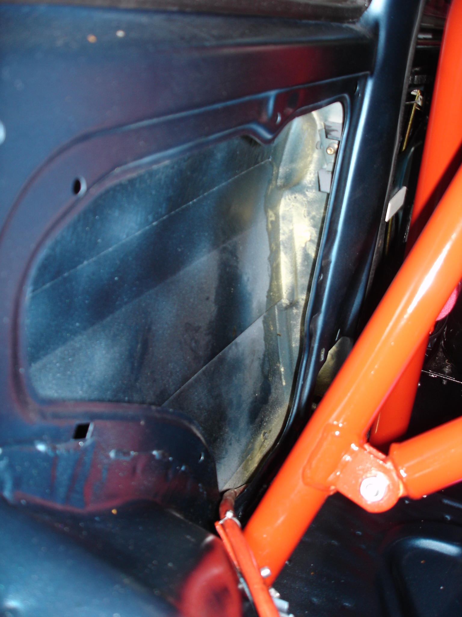

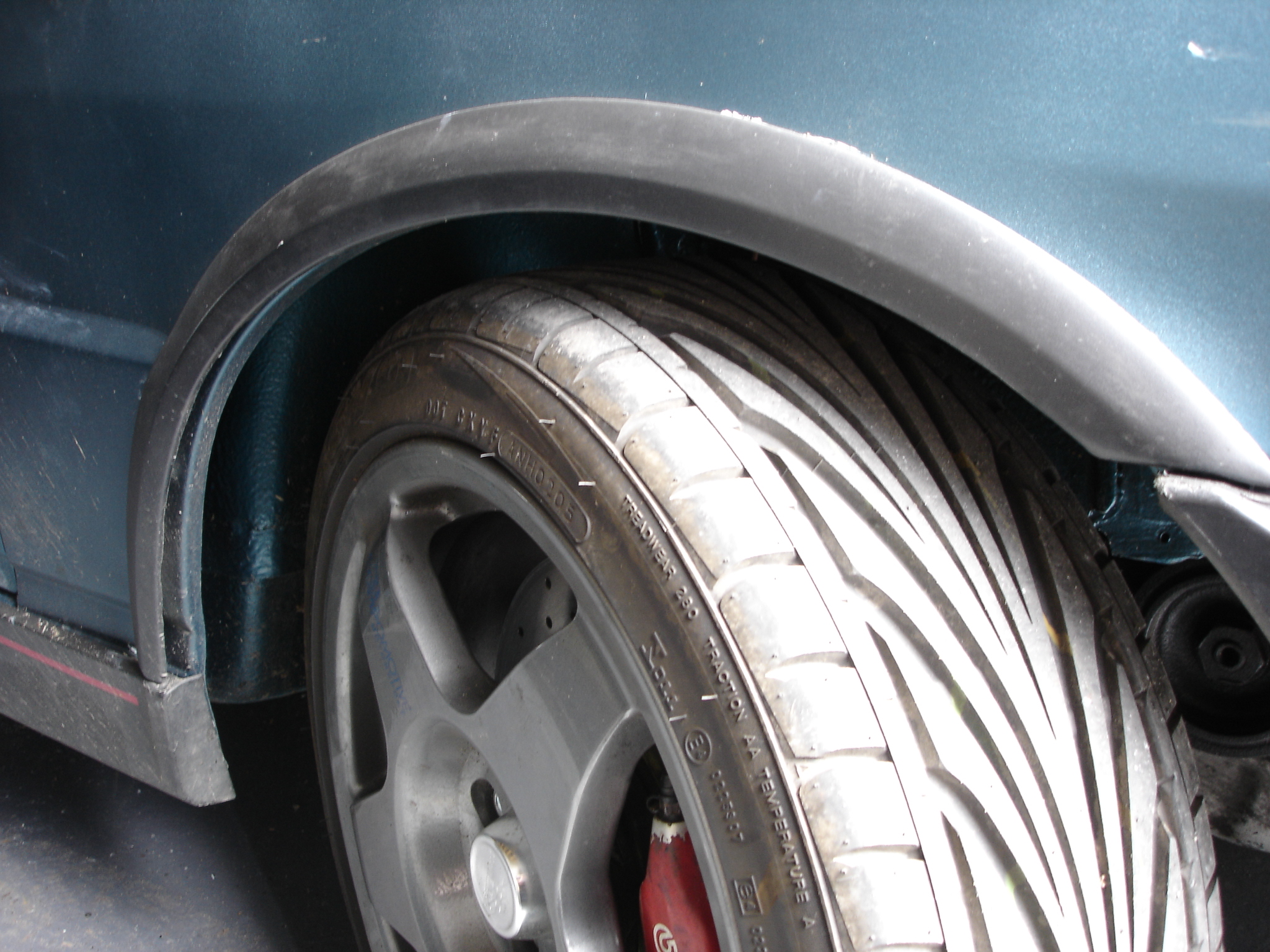

heres the waxoiling i did inside the car the other week. did all down the sills etc, also ploughed loads into the inner arches :D that'll hold the rust at bay! mmwhahahah

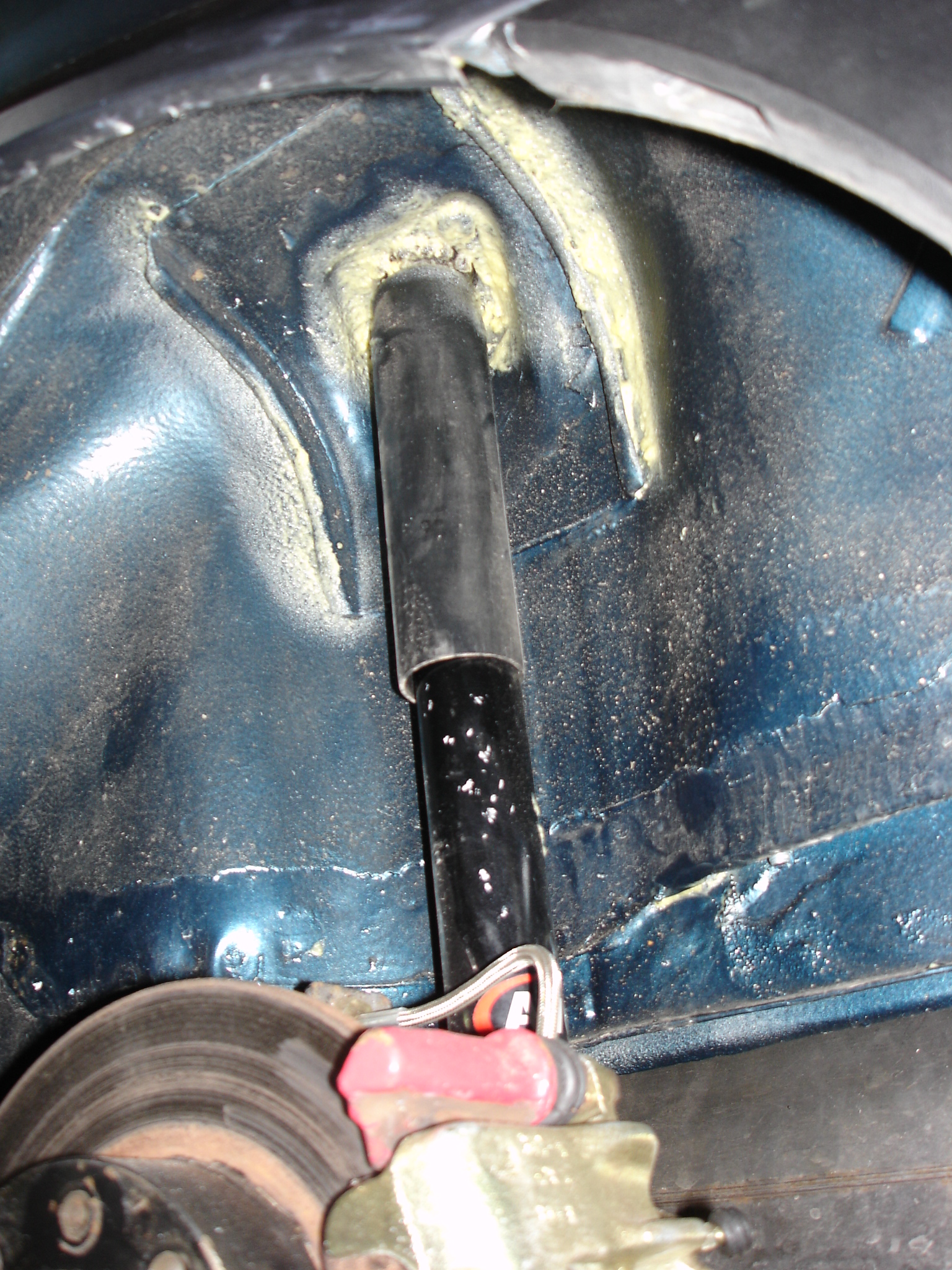

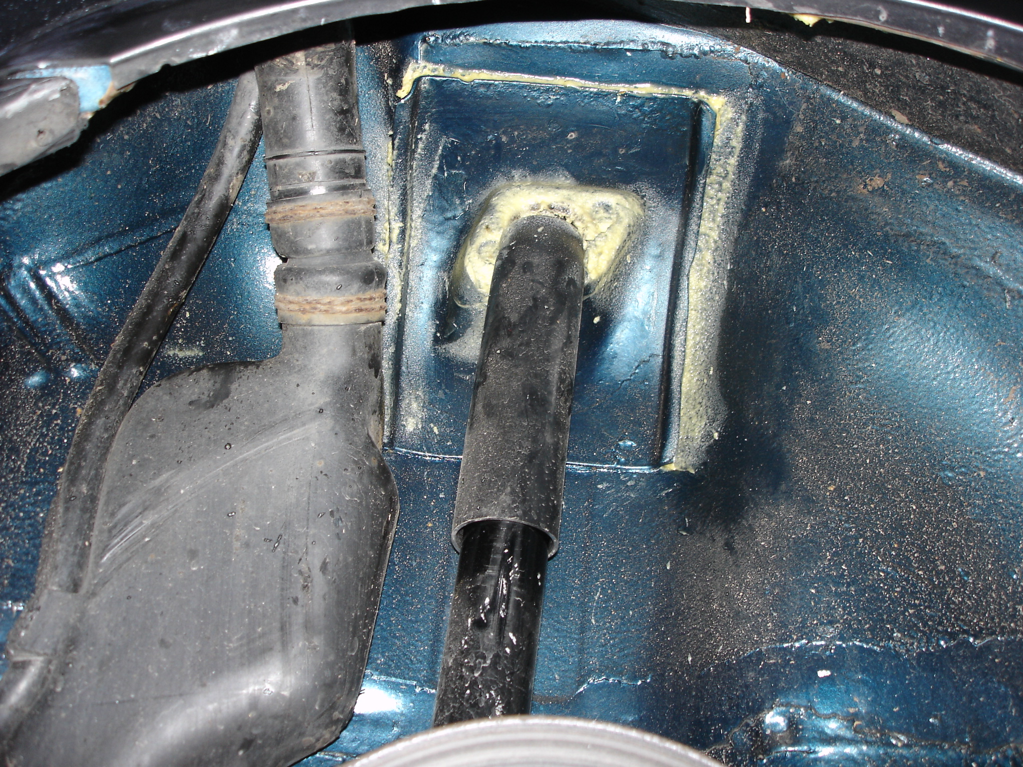

did some more waxoiling here and there on the car

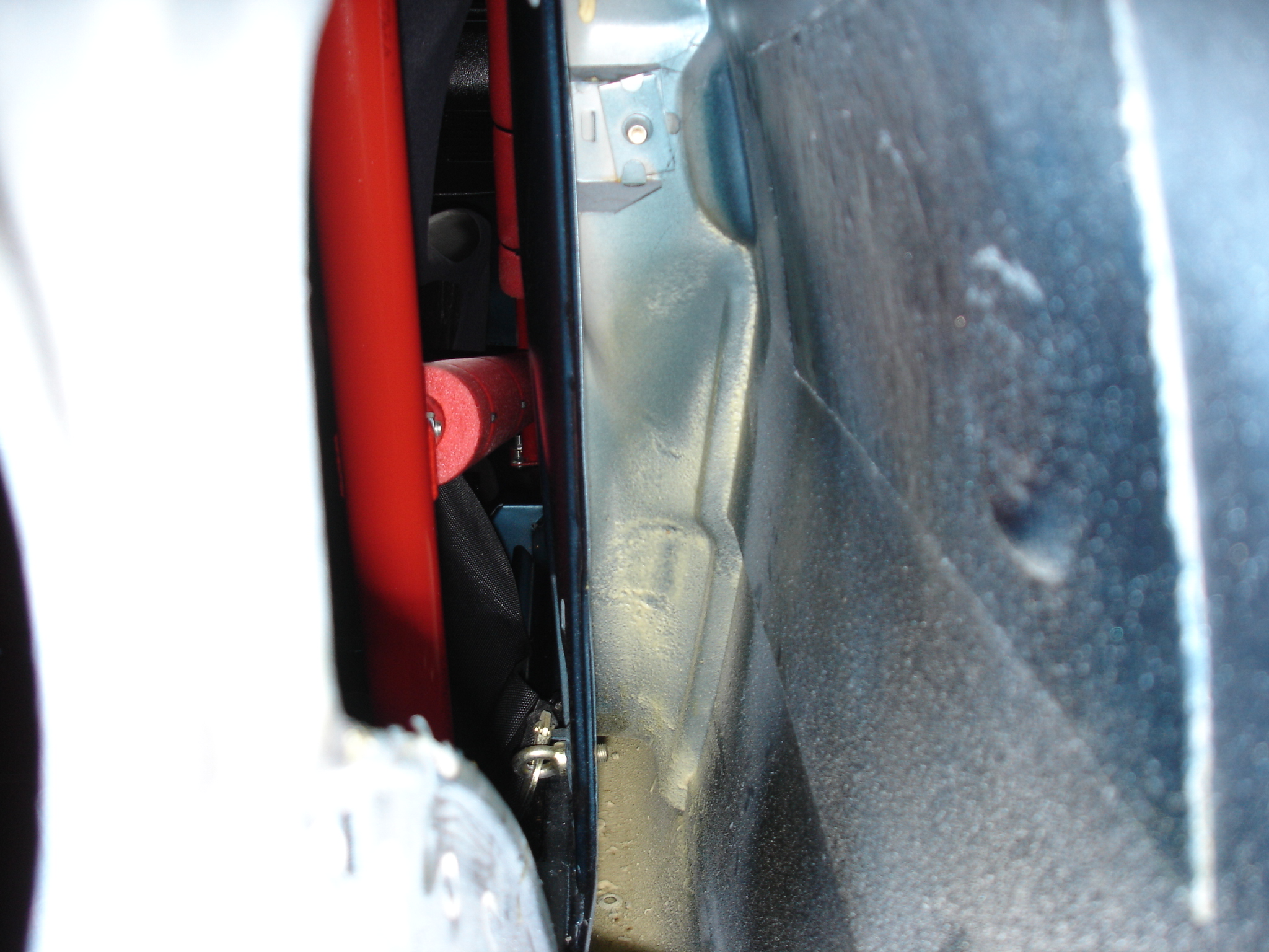

up inside the rear arches

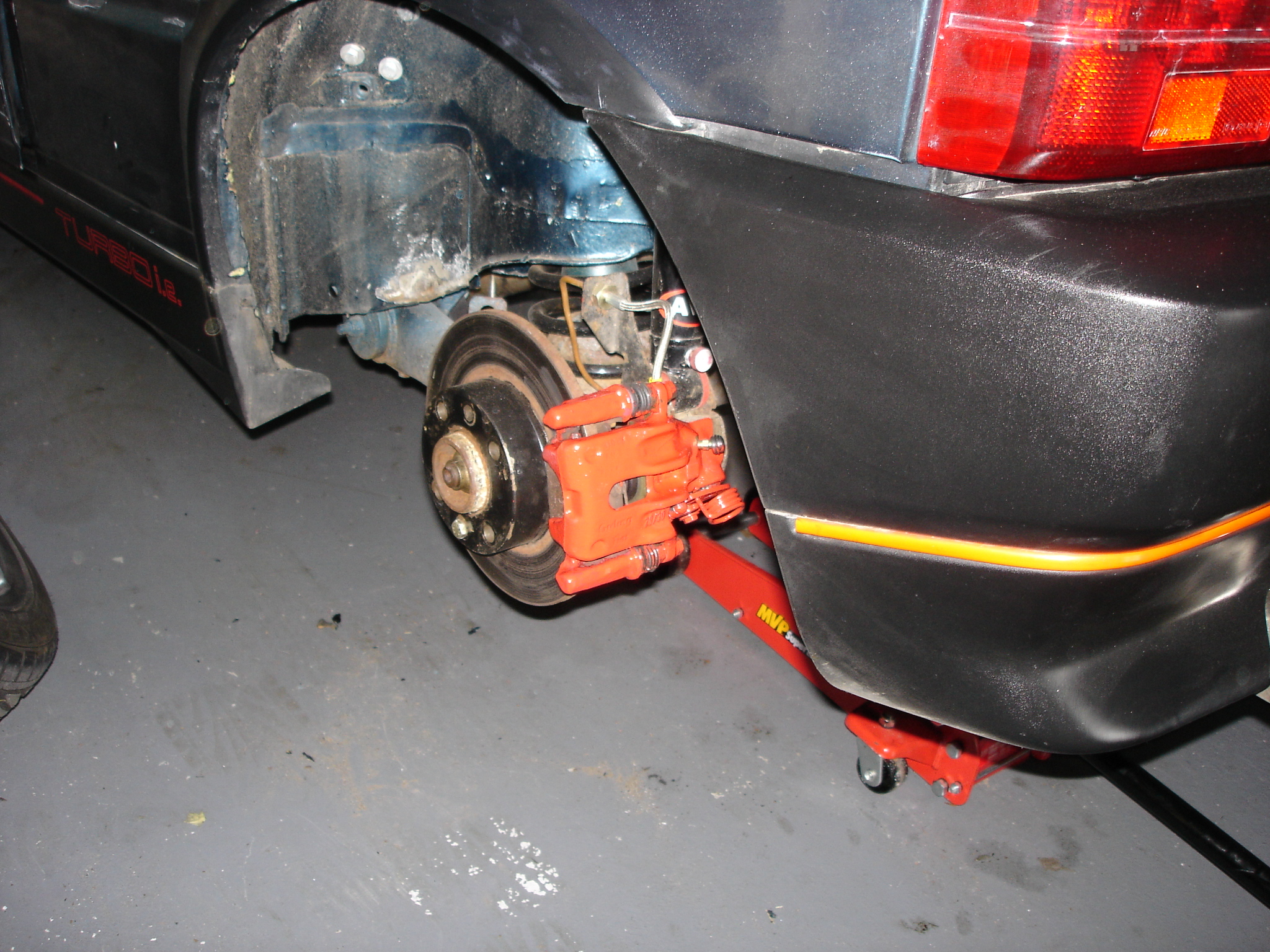

also notice in that pic that the new rear caliper needs painting ;)

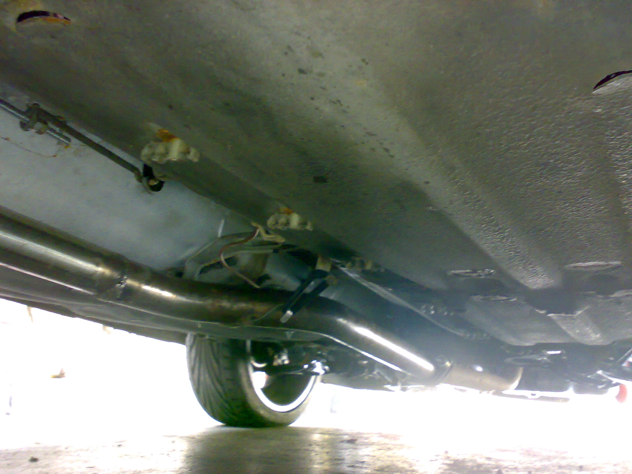

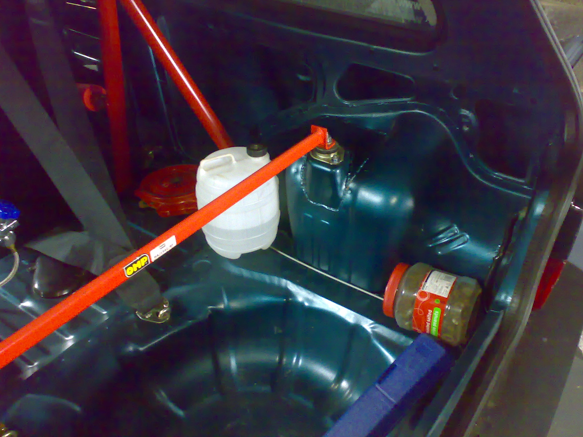

underneath near the spare wheel well

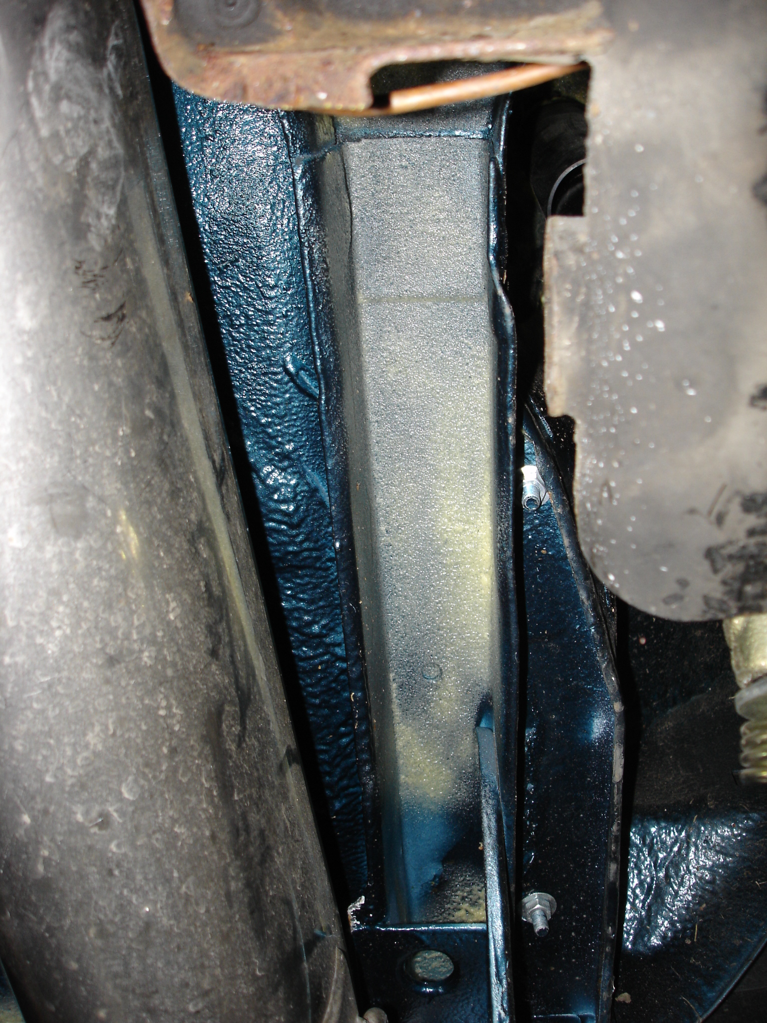

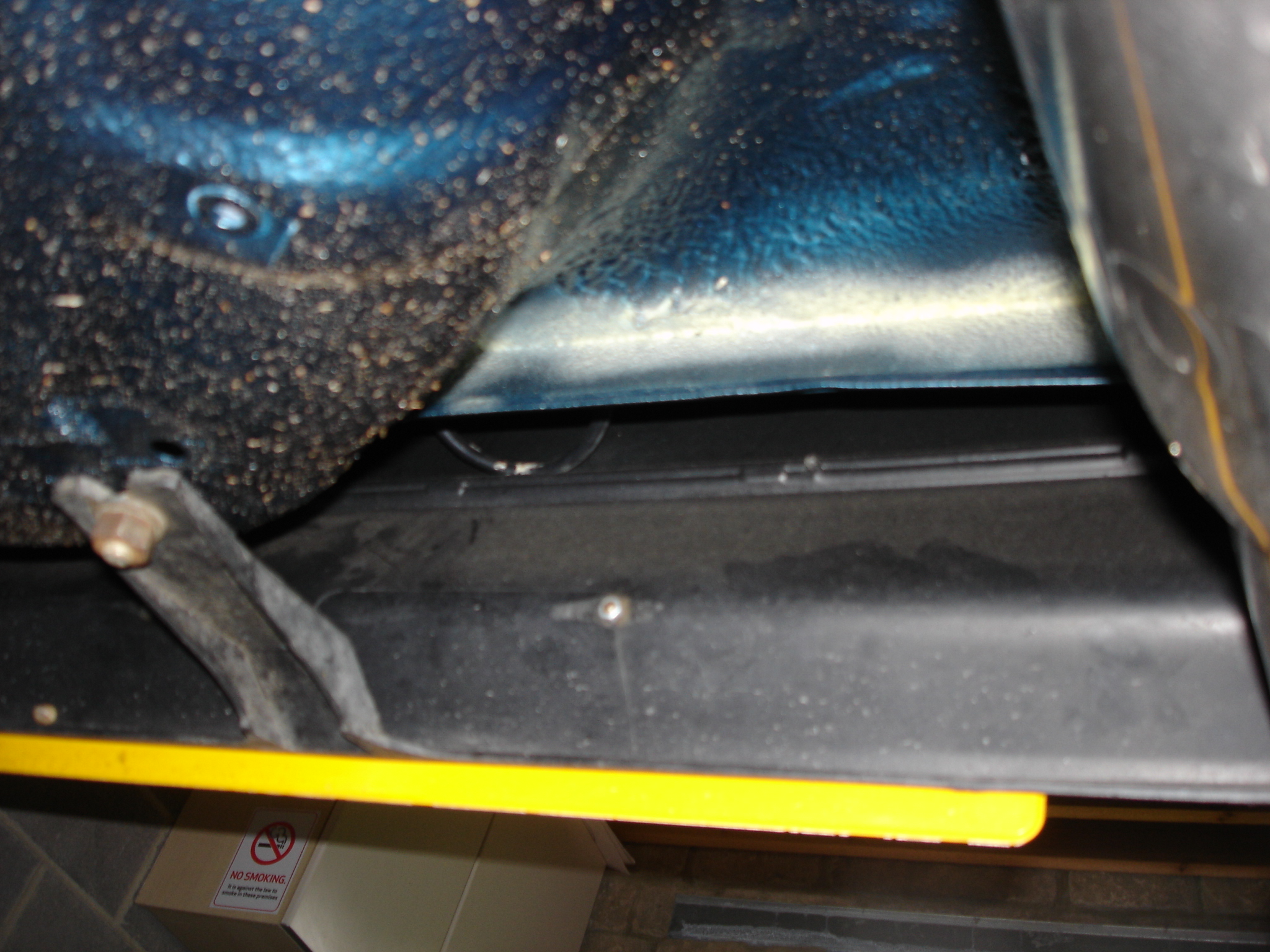

rear chassis rails

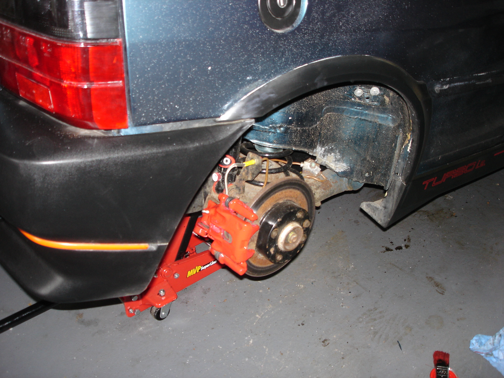

also painted my rear caliper up in red, then thoguht "sod it i'll do the other one too lol
