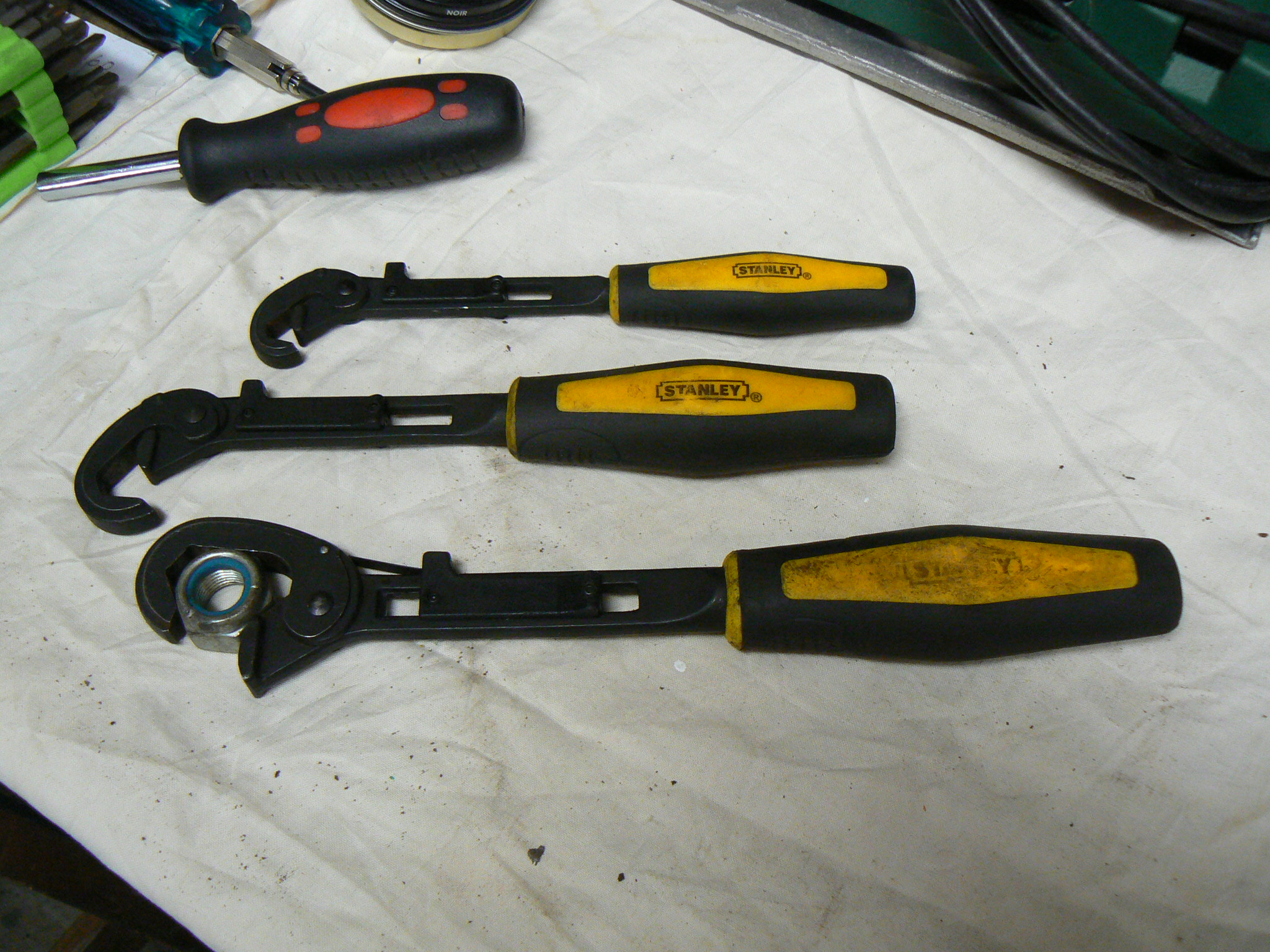

I have some excellent quality Stanley branded tools in my carpentry tool box but I don't think they stack up against the likes of Britool etc for mechanics tools, However they were on a good offer and I liked the idea of them as they seem to work on the same principle as a Stilson/Footprint but with flat driving faces rather than the aggressive teeth of the other tools. If you look here:
You can see that if I turn the handle so the nut is rotated in a clockwise direction, the jaws will tighten against the flats and the harder I apply force to the handle the tighter the tool grips the nut faces, just like the Stilson/Footprint. However it's driving faces are flat so no damage is done to the hex faces. It also has an inherent "ratcheting" ability which is very handy if you find the nut to be a bit too stiff on it's thread to spin by hand after the initial "lock" is broken. All you do is rotate the tool anticlockwise and the jaws open and jump back to the next set of flats ready for you to pull against it again. Another reason why I think it works so well is that it takes a 3 point contact with the nut - the Stilson/footprint grips on opposite sides of the nut - So it has very little tendency to crush the nut onto it's bolt/stud/track rod/whatever, whereas the Stilson/footprint, by gripping on opposite sides of the nut, tends to crush the nut to it's male thread thus tending to lock it up. Although I don't find a lot of use for them when at home - as I have a big choice of other tools - I do use the larger one quite a bit though, almost exclusively, for doing track rod end locking nuts and I always sling them in the boot (trunk) when going on longer journeys. With a size range from 8mm (5/16 for us oldies) to 24mm (15/16) they can cope with most of the stuff I might want to tackle at the roadside.
There was a conversation going in another thread recently about the newer bolt types - splined, Torx , etc - and it occurs to me that the "good old" hex head gave us the possibility of using a number of different tool forms - Sockets (in hex and bihex), open enders, ring keys and tools like these Stanley efforts (I'm sure there are others) to "attack" fixings, whereas the new forms require the specific and only tool so if you can't get access with it you're "shafted"
Spot on, a picture paints a thousand words:)
