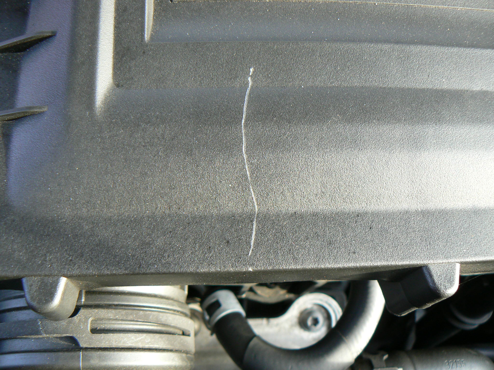

although they lost one of the black wheel nut caps as well. I raised these issues with the service desk this year (particularly the scratch) and got the response "well why would we do that sir?"

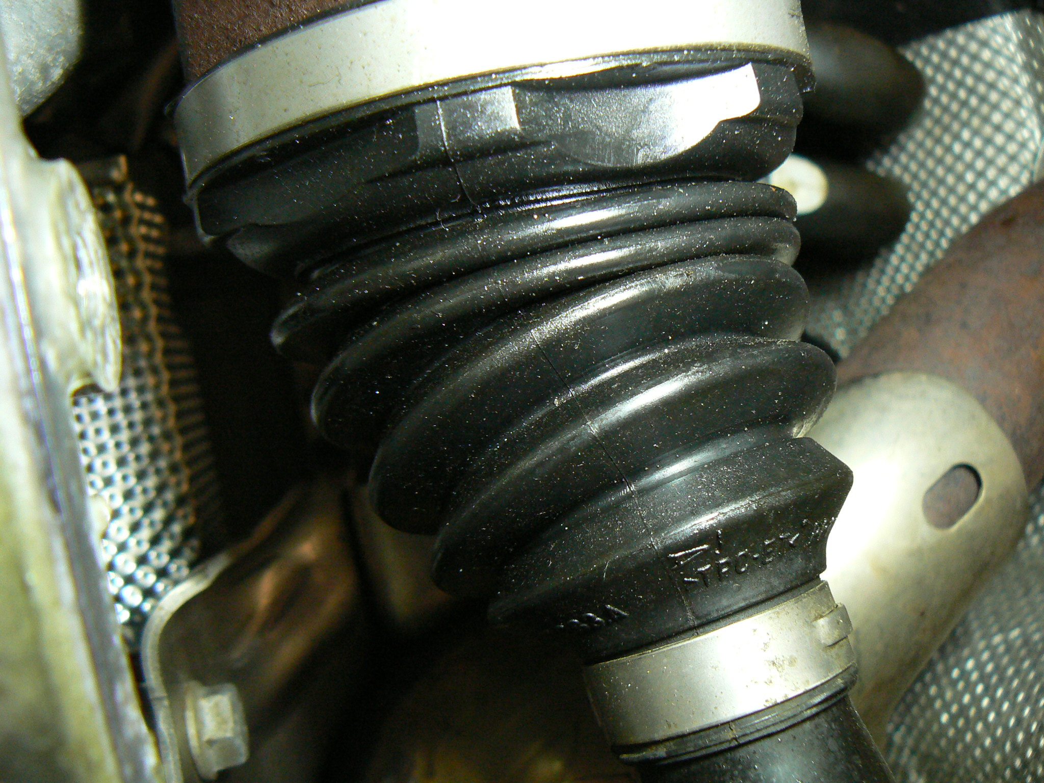

I do quite like that the technician sends you a video of the underneath of your car. Not, to be honest, that there's much it shows I don't already know - it shows a tread depth gauge being used on tyres, exhaust condition, looks for oil leaks and so on. There is one big plus for me though. If you look carefully and pause the video, you can clearly see where the 2 post lift pads have been positioned. It's pleasing to see that, on all three occasions, the pads (which had rubbers in good condition too) were on the box sections and not on the bottom sill seams! Well done lads! Pity though that you reported no oil leaks when it's obvious that something is going on with the inner driveshaft joint on the O/S driveshaft!
The N/S one looks nice and dry though

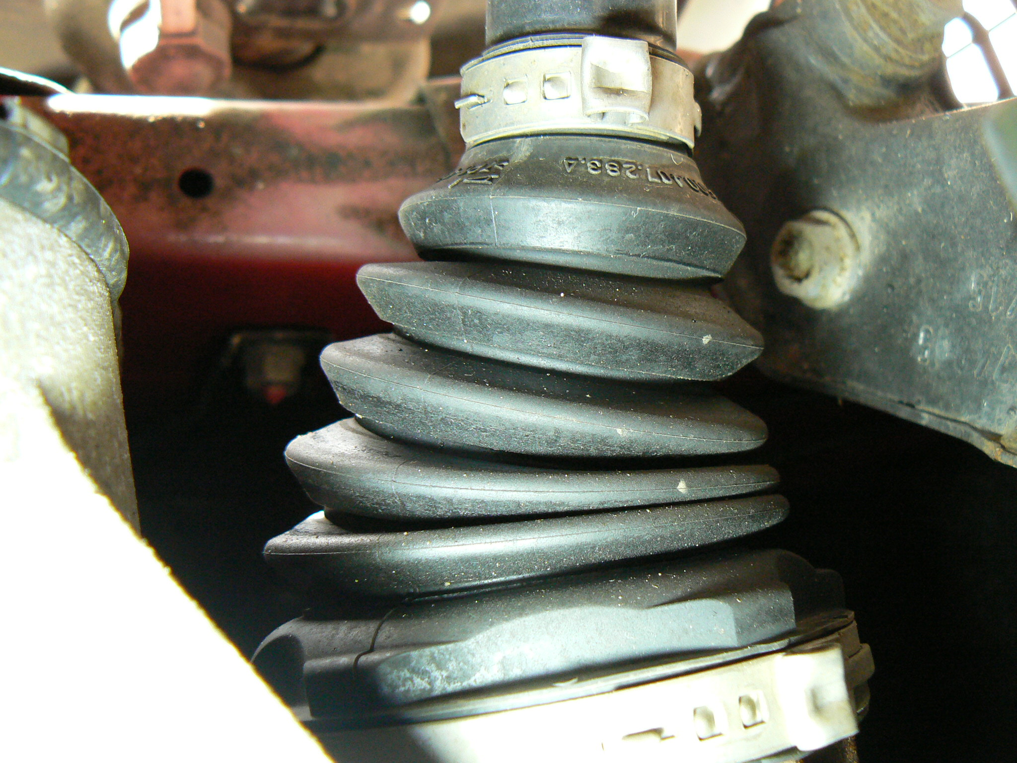

Strangely there's no very obvious reason for the dampness. When you wipe it it's quite clean and oily looking, not like the black moly grease you would expect from a leaking boot. The gearbox seal is dry and the inner end of the joint is dry so it's not a gearbox seal leak (disappointed to see no obvious drain plug on the box though). However the Turbo is right above it. Wonder if either there's a wee leak from the new turbo (fingers crossed it's not that) or, as she's not done a lot of miles since the new turbo was fitted, maybe oil was spilled when the pipes were changed over? There's no sign of anything being flung off onto neighbouring components/engine block/gearbox casing. Anyway I've given it a good clean and I'll have another look in a few weeks.

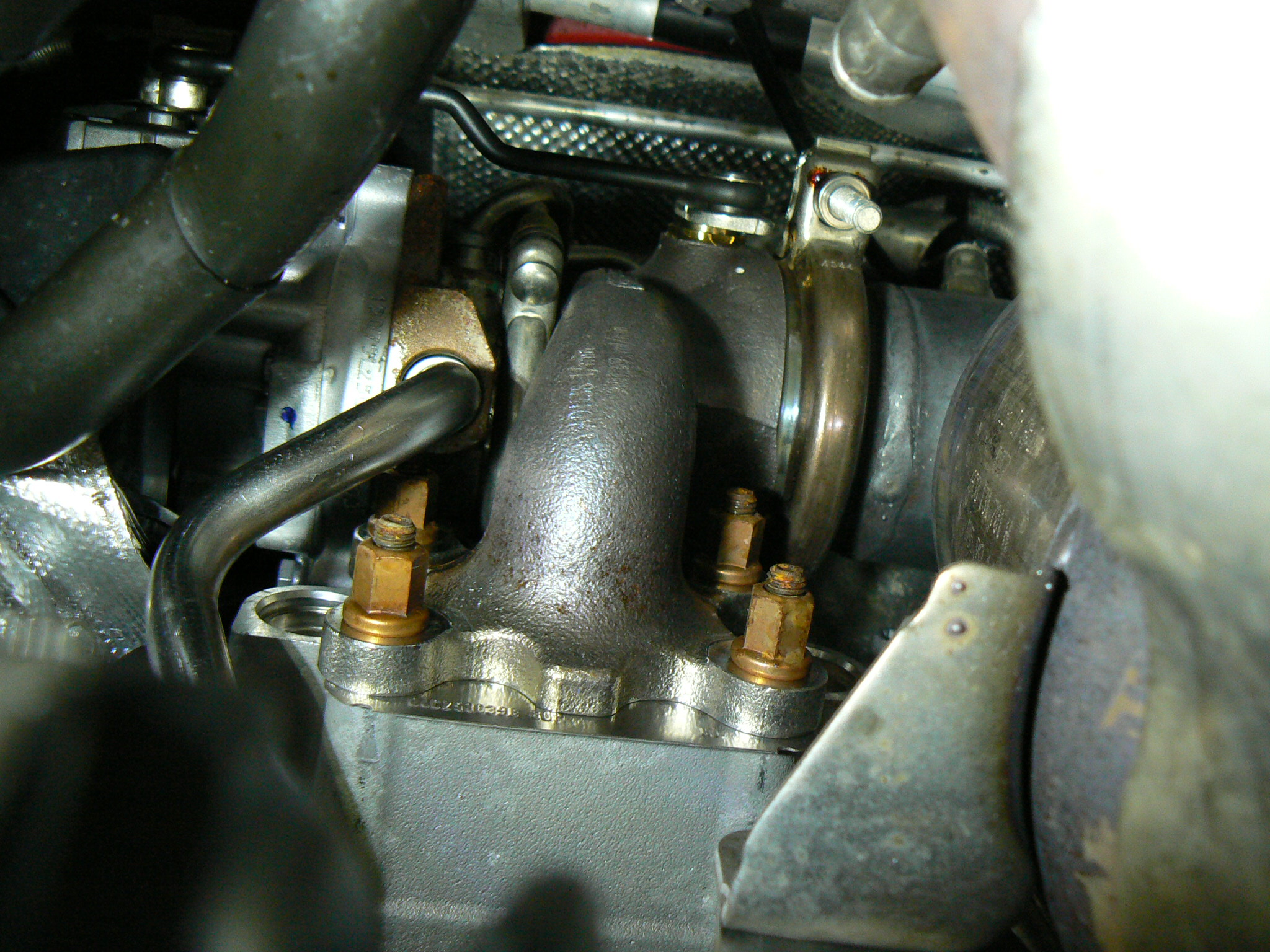

As I was lying underneath I shone my torch up the back of the engine to see if I could see any obvious signs of oil leaking - Thankfully none that I could see - but I noticed that the 4 bolts securing the turbo manifold to the back of the head look as if they are brass. This brought back to mind the posts we did recently about anti seize etc.
On reflection though I'm not so sure they are brass? but not steel either? maybe stainless?

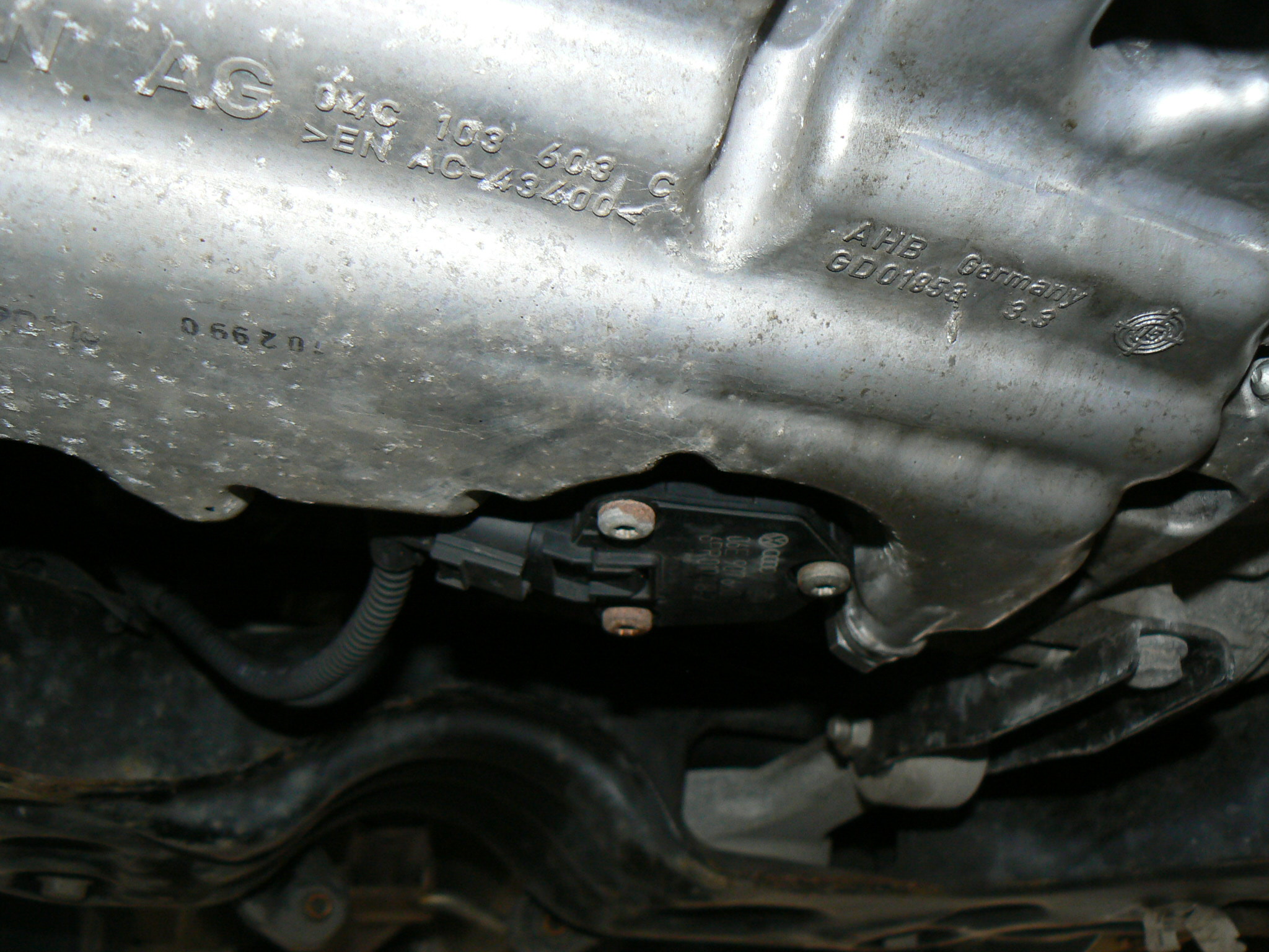

Finally, and I applaud you if you've got this far without falling asleep, There is one thing about her which makes me nervous. right on the bottom of the sump is this:-
It's a plastic sensor, I'm guessing it's oil temp or level? Just to the right of it is the oil drain plug. Good thing I go really slowly over speed bumps. I think the surrounding sump casting would take the brunt of any contact but why not have put it just round the corner on the back face of the sump?
It's just on a week now since Twink was in for her service/MOT. So late yesterday I had a quick crawl underneath and had a look at this driveshaft joint. You'll remember, if you've been following this thread, that I gave it a good wipe down last weekend and I'm delighted to report that, after a week of running around, there seems to be no signs of any leak now. I gave it another very thorough all over wipe, right down to the base of all the convolutions and I'll give it another check after I've put a few more miles on it. The conclusion I've reached is that it's most likely to have been oil which leaked down during the Turbo swap. But, if this is the case, maybe there would be some traces of oil on the back of the block? I'm not 100% convinced yet.
It's brought home to me though how much I hate someone else working on my car. If I'd done the services myself I would have had an ongoing knowledge of the condition of things like the drive shaft boots and I would know if oil had been dropped during the turbo swap thus eliminating the uncertainty I now feel.

From post #1 , the lump on the bottom of the sump is the oil level sensor.
Got one on the Fabia. 1.2 TSi.
Perhaps best to avoid farm tracks and floods.
To be fair some VWs do 20,000 miles between oil changes so it's worth having a level sensor. At least it's a handy warning light to tell you when the sender has ripped off the bottom of the engine. :)
My bike has one. Its a magnetic float thingy that sits in the side of the sump. The only time it ever lit the warning was when the wires got salt corroded. It does 6000 miles between oil changes so a bit pointless IMO.
The concept of 20'000 miles between oil changes makes me very nervous. My present "good" car (as against my "fun" Panda) is, as some of you will know, a SEAT Ibiza 1.0 tsi and has the option of extended service intervals. I opted for yearly/mileage which works out at yearly/6'000 miles now I'm retired. Even so I don't skimp on the oil quality.
Obvious though it is I hadn't thought about the wires corroding, thanks for that, I'll be slaistering some contralube on and in its connector next time I'm under there. Thanks for confirming what it is lads.
