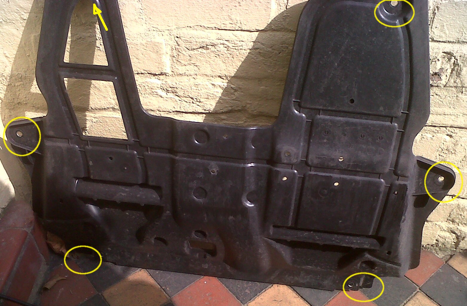

Here is the floor after I removed it, with the bolt holes highlighted:
Once the bolts are removed, you can slide the floor towards the back of the car and remove it. This will expose the engine sump.

Once you can get under the engine bay, remove the six anodized bolts and washers which hold the plastic engine-bay floor -- you will need a 10mm socket to do this.
