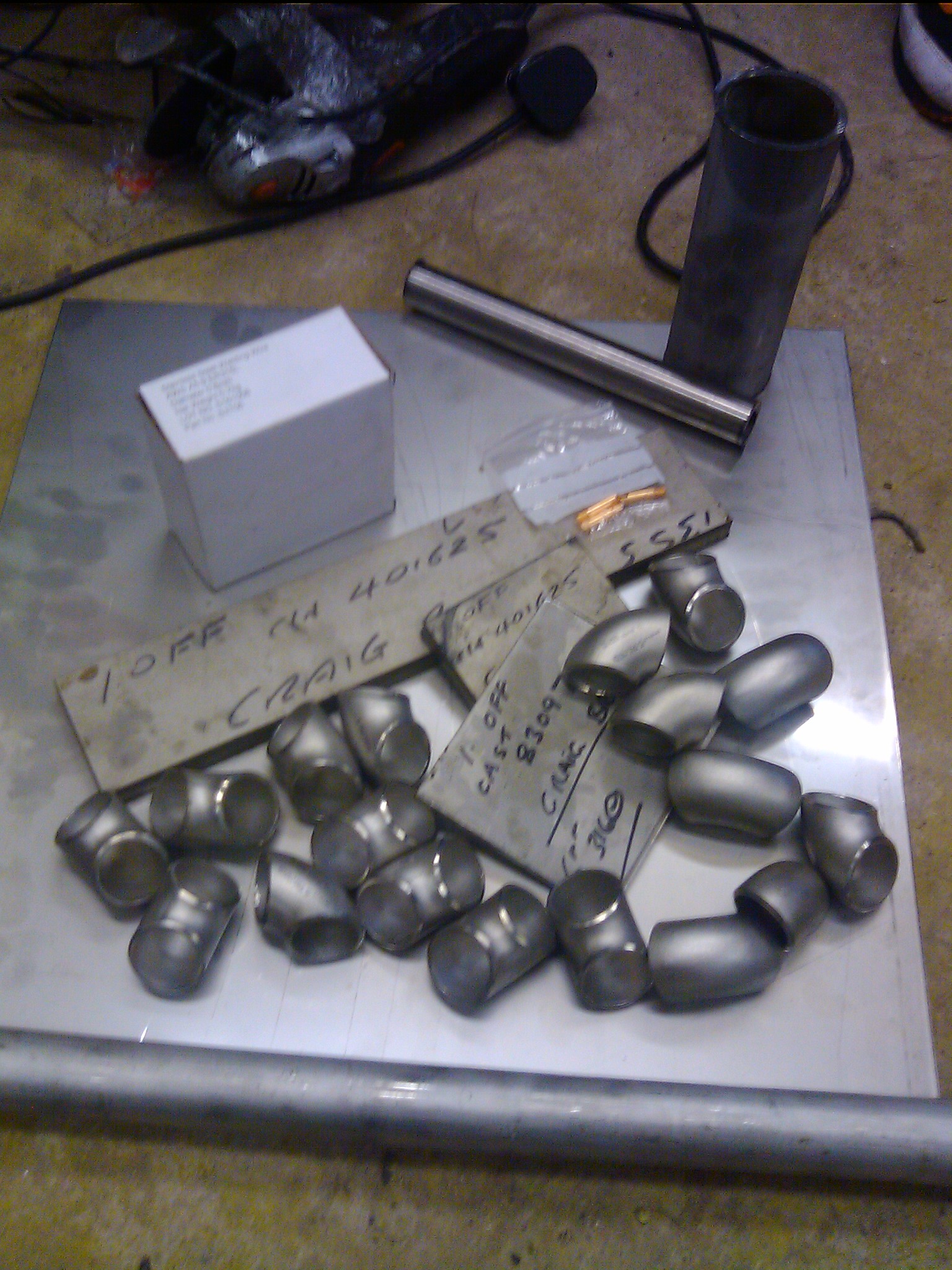

photo as usual. got the metal. I was also given some offcuts of tube to practice welding on which was nice of them.
this 12mm thick stainless is going to take some work!

cutting??? LOL goggles/grinder/drill press.... if all else fails the company i got it from can do it for me.

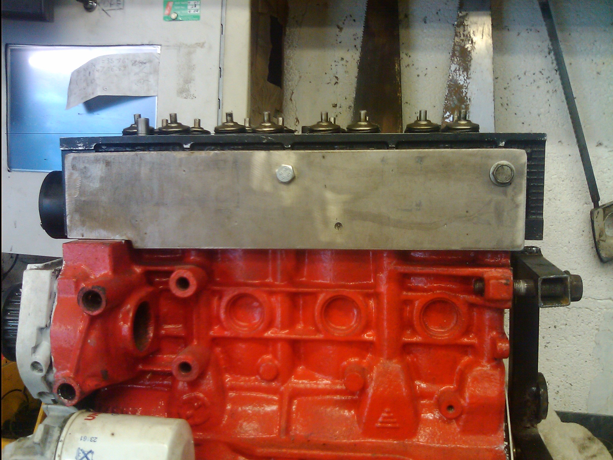

what did you do where the manifold goes to the flange? the ports on our engines are long
I was thinking of tube in a vice before welding them onto the flange to make them oval but not sure if it will work

exactly that - vice lol
I made a mistake when I designed the head flange in CAD, miscalculated what the squished pipe outer diameter/circumference would be, and had to have it altered again on CNC. I worked out out in theory on outer circumference, but in practice it comes out differently, and I still dont know where the missing area went lol. Just a heads-up for you if you're designing a template or whatever.
Only reason I used CNC is because you can get it 100% and my mate runs a machine shop, so it wasnt too expensive.
