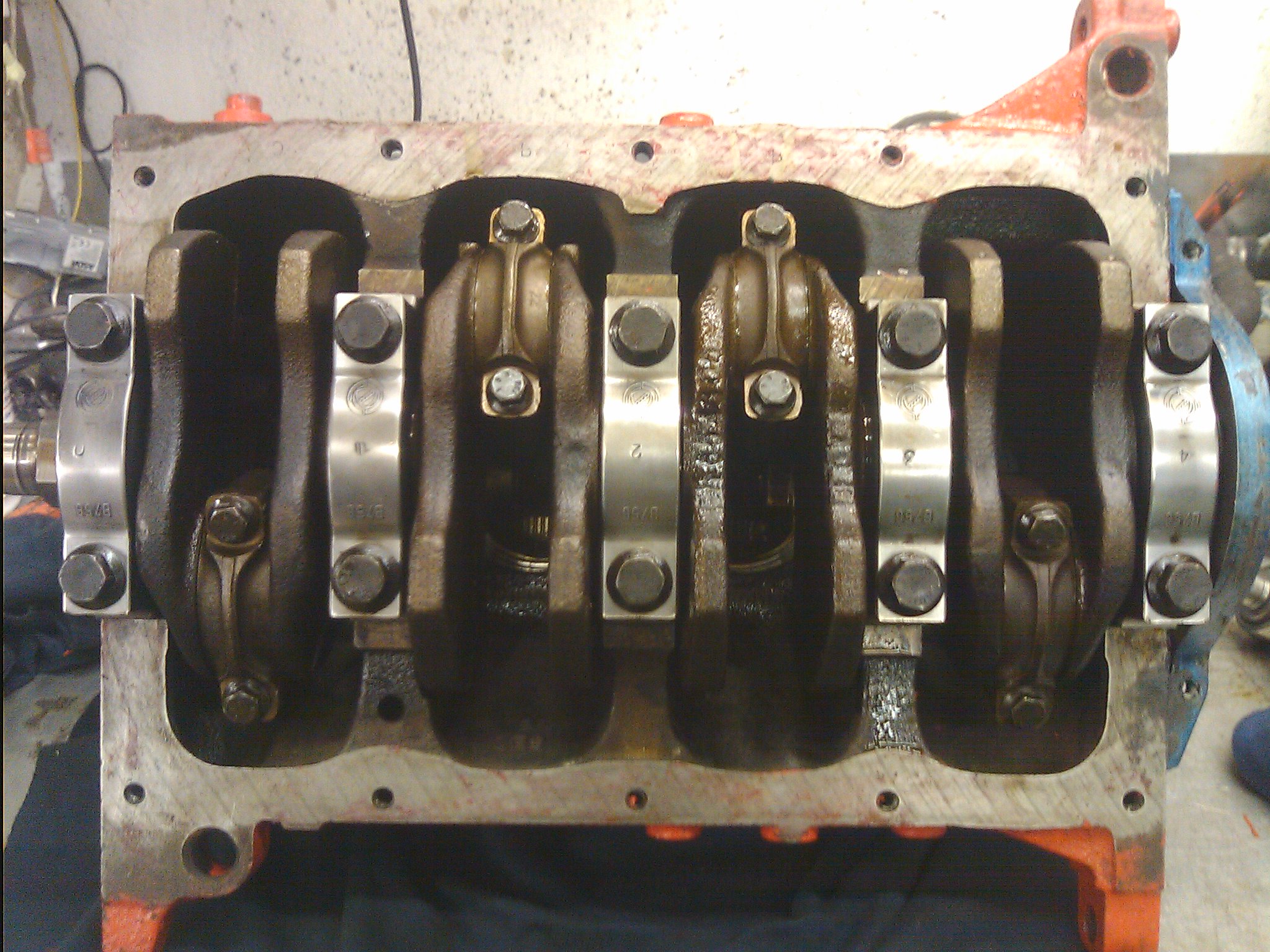

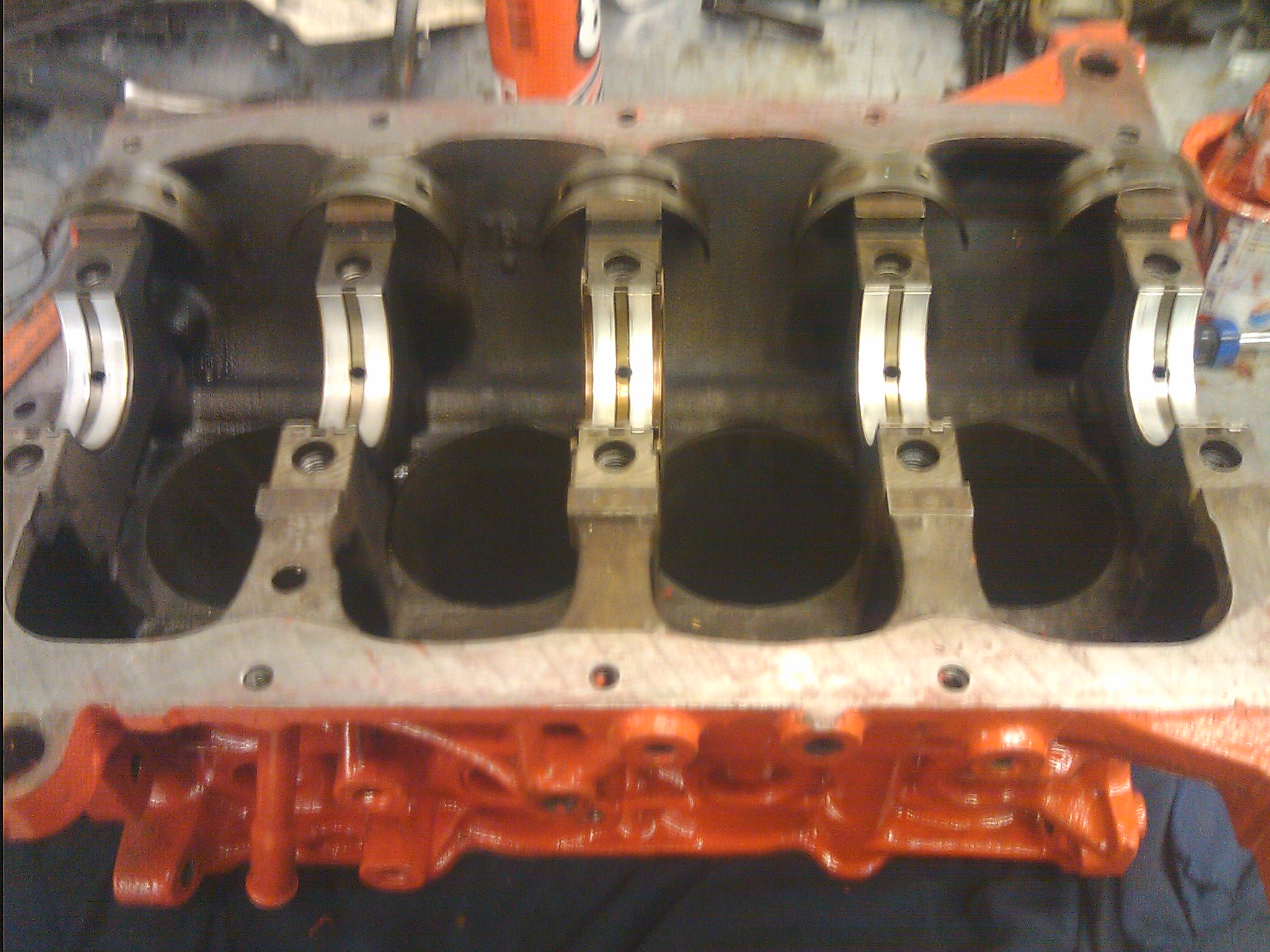

got another 75 engine.
80k but its mint (might be a new engine in a car thats got 80k on it)
bores are like new. head looks mint.

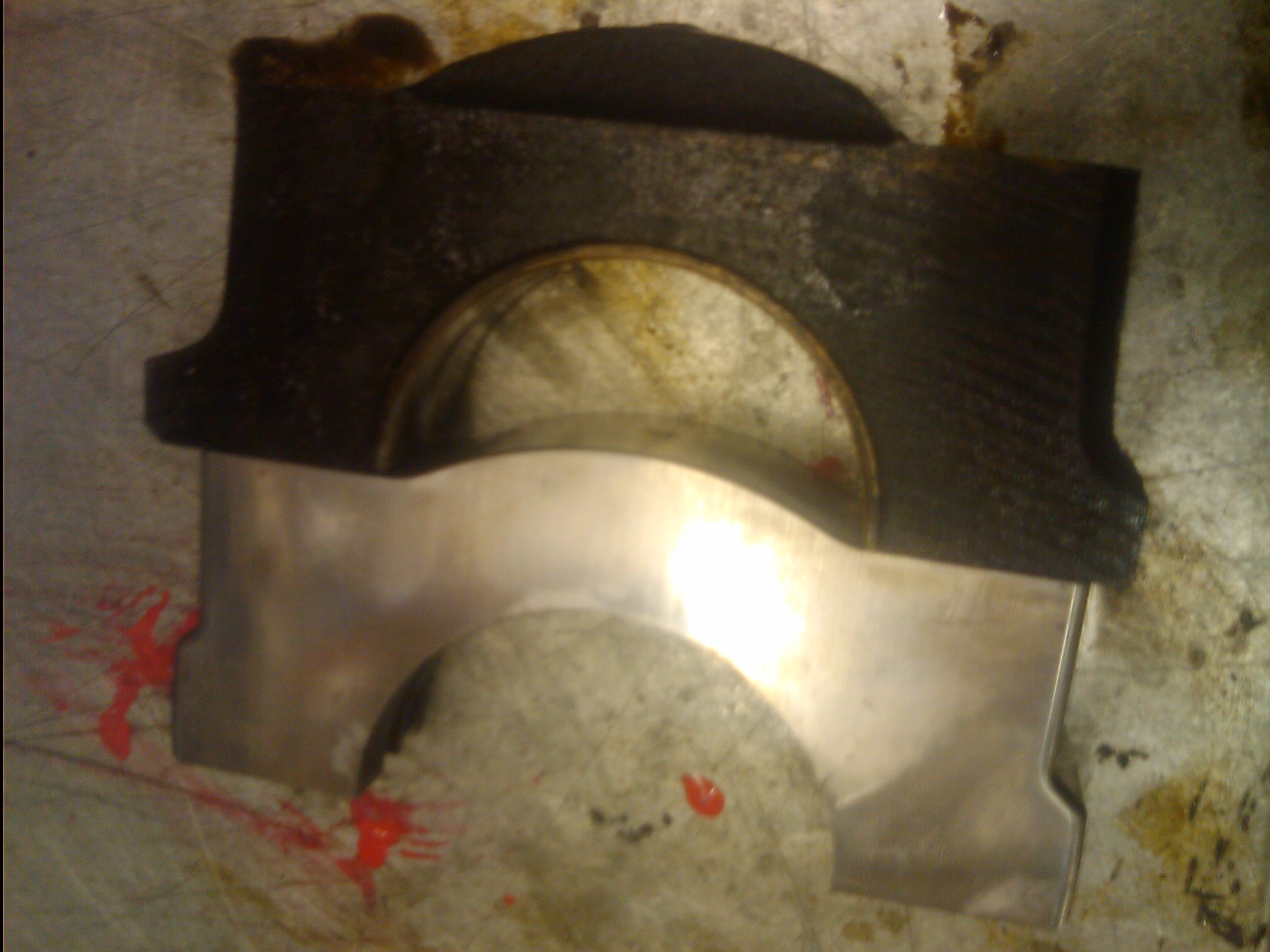

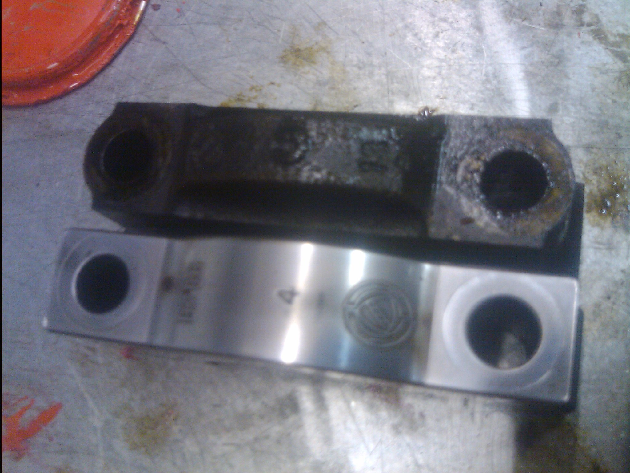

stripped it down and found that crank bearing caps are not like any other 75 engine ive seen.(only difference that non of my other engines had is this engine had A/C)
they are not made from cast iron they are made of the more modern metal,same metal they use for modern conrods (like the 16valve rods)
:yum::yum: what's the plan with this engine ?
just a spare i assume but a very nice find

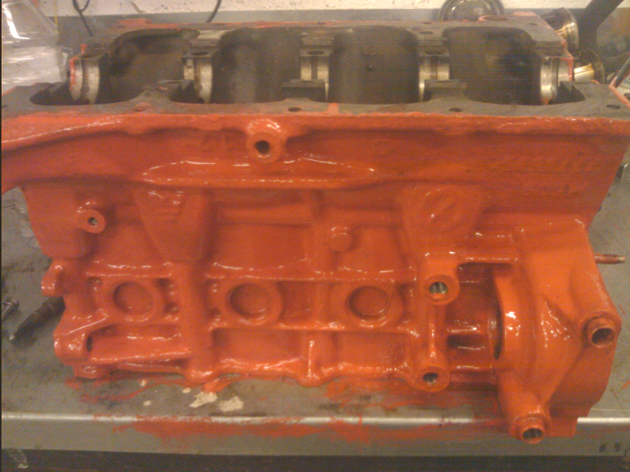

block painted(only colour i had)

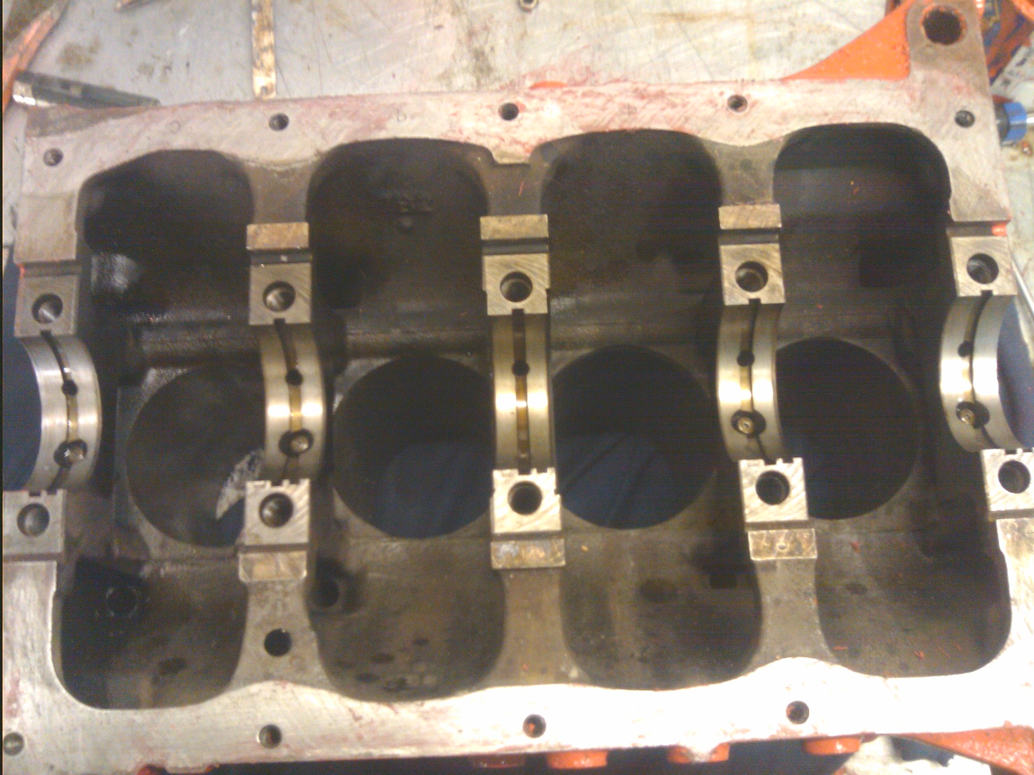

here you can see the oil feeds for the piston cooling oil squirters found on the 75 engines. they seem to have a ball-bearing check valve built into them (at least thats what it looks like.)

pistons and shiney caps fitted (i stamped the caps myself as getting them mixed up wouldnt be fun, there machined together so not interchangeable)

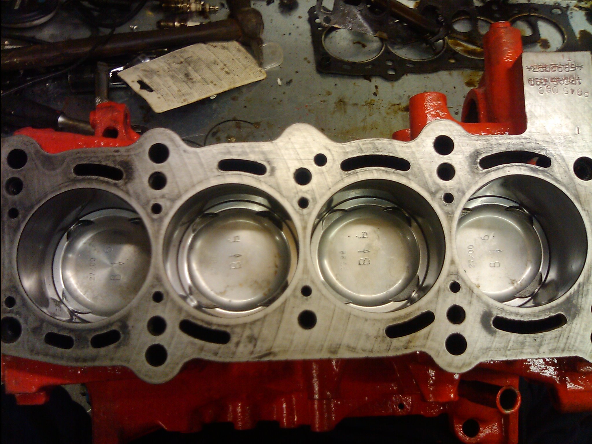

nice shiney 16valve pistons :slayer: they where like new:cool:
