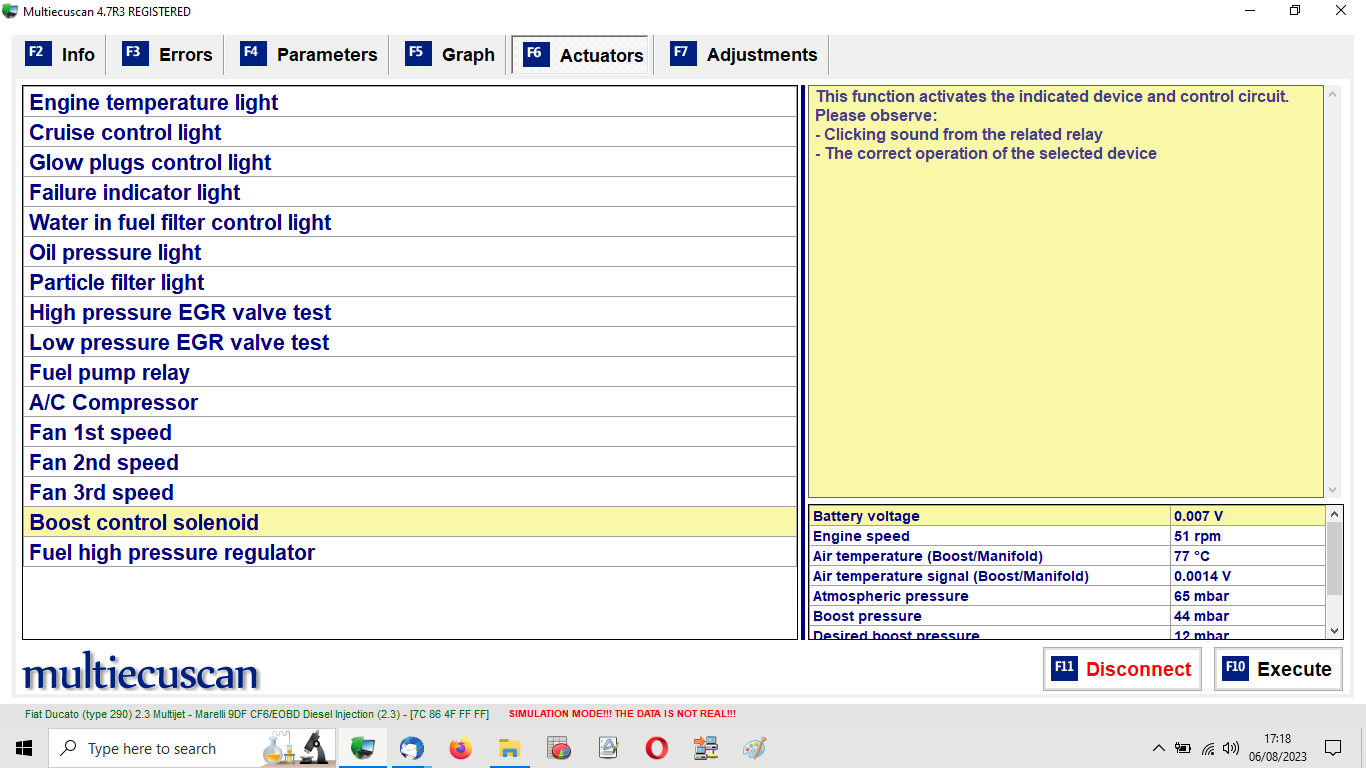

There is a specific option to test the (turbo solenoid)boost valve in multiEcuScan.
Just select the test (Ignition on, engine off) press F10 or click execute and it will signal the valve to open and close a number of times. You should be able to see and hear it. At the same time the turbo actuator rod should move a few time untill the vacuum is used.
If it works at least one time the valve is OK, less than 3-4 times check the vacuum pipes.
