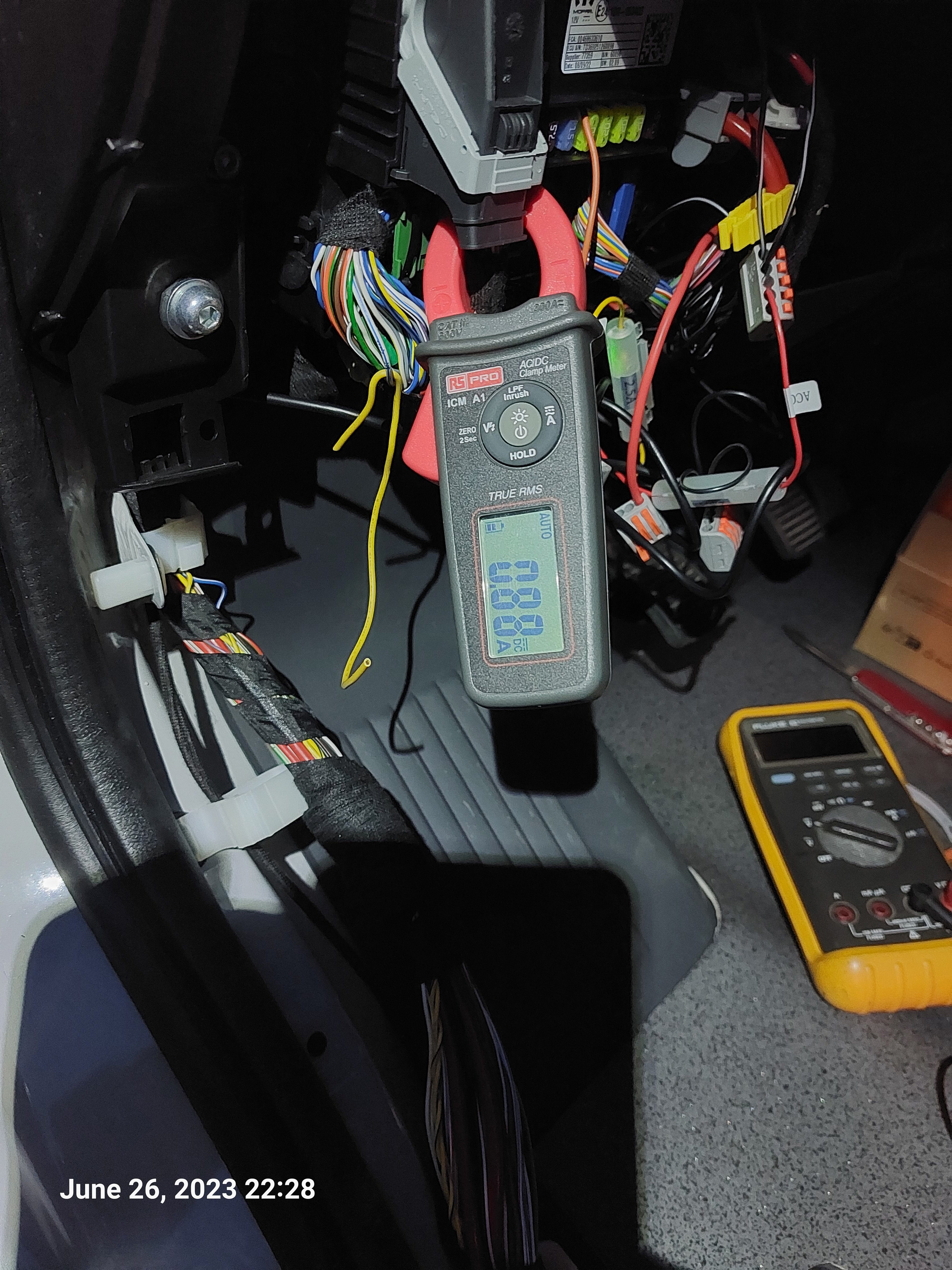

Just sharing this little piece of information, for those who want to activate the rear camera on non-FIAT specifique smart self-installed radio.
So, take out the under panel plastic cover, and find out the wire as shown in the attachement. It is the + 12 V wire sending power to the reversing white bulbs.
Make a derivation on it, you can draw several miliampers comand current to your radio device, without disturbing the BCU.
