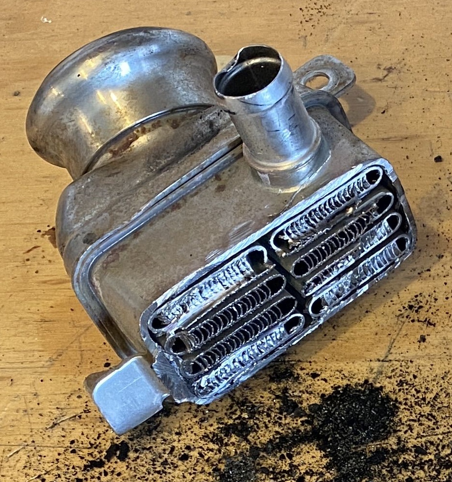

What is a LPEGRcooler? Its a part of the emissions control system on the Ducato twin EGR no Adblu engines.
This engine can suffer a problem unique to itself that of a blocked LPEGRCooler.

Excessive soot is generated and has to go somewhere if there is a crack in DPF the soot will be shared between atmosphere and cooler. It may be evident by soot in the exhaust pipe (wipe with kitchen roll).

If the MIL is iluminated then error codes may be availble eg P0401,P0402,P0236, P0238. Typicaly a P0401 will exist with or without others in the group. It is pointles trying to solve other codes without taking on board the primary reason.
Why a P0401, Exhaust Gas Recirculation Flow Insufficient Detected. The 401 error always coincides with a large demand and inability to deliver it.
The inability to flow the desired Air volume is generally not due to the egr value being unable to do its normal function but the ecu asking for an implausible value. This is due to an ecu error or air flow not being possible due to another condition. Inside the LPEGR housing is a butterfly throttle that closes off the fresh clean air from the air filter in a controlled manner such that the turbo has to pull in an amount of sooty air from the cooler to blend the combustion air. With the cooler blocked the butterfly closes off any fresh air with the result that the engine is strangled. Because of the strangling effect the software tells the HP EGR to open in an effort to avoid this strangulation. The software gives daft unachievable opening instructions to this HP EGR which because it’s unable to do it throws the P0401 codes leading the unaware to change the HP EGR because the fault code says so!
The clogged cooler is not the root cause. Lets use the 5 whys
why do I get a P0401 et al?
Blocked cooler
