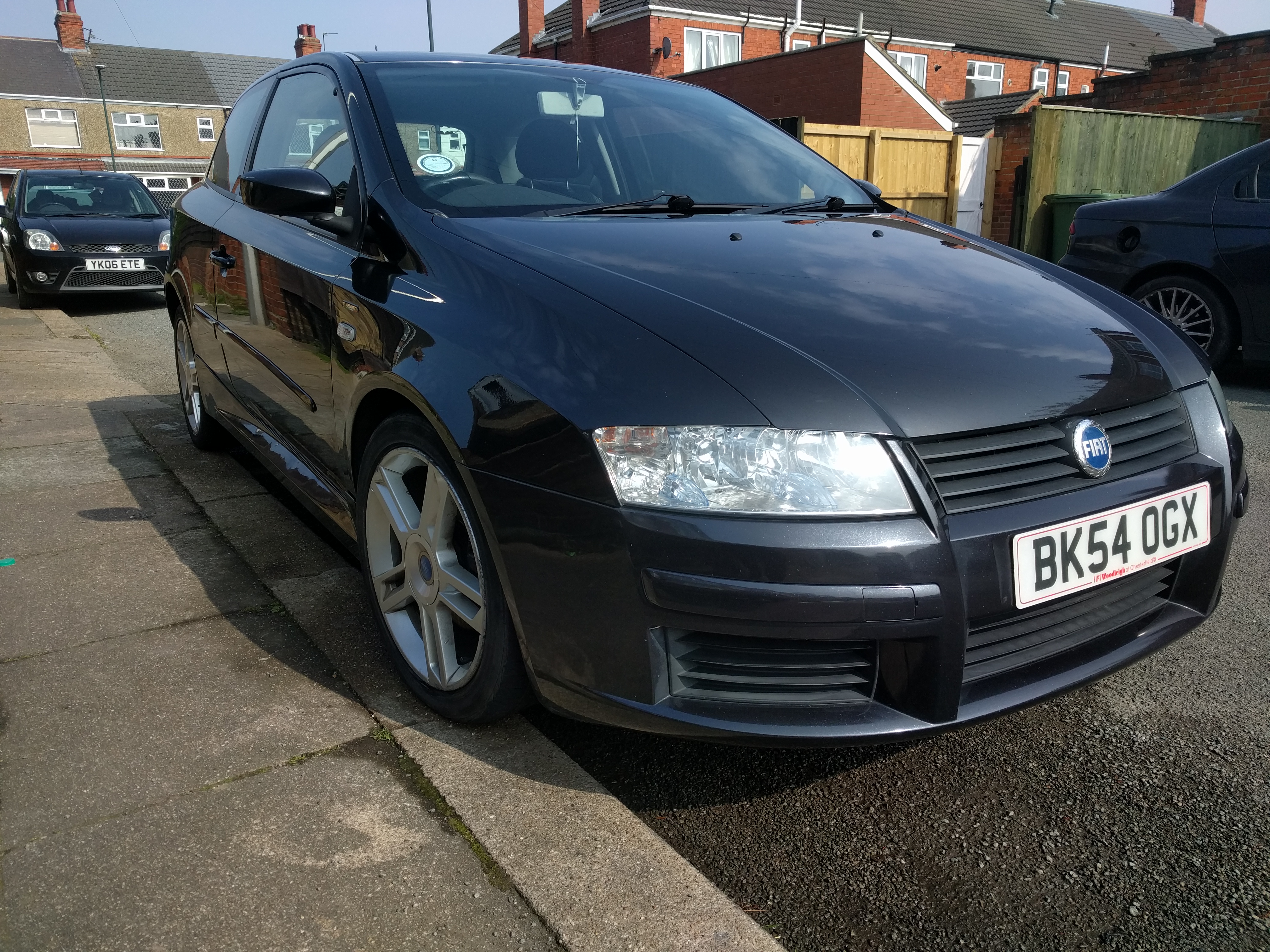

And I couldn't be happier! Today is the day I get my Abarth back.
Plan for the weekend / coming week is to get it back to roadworthy having been sat for a few months.

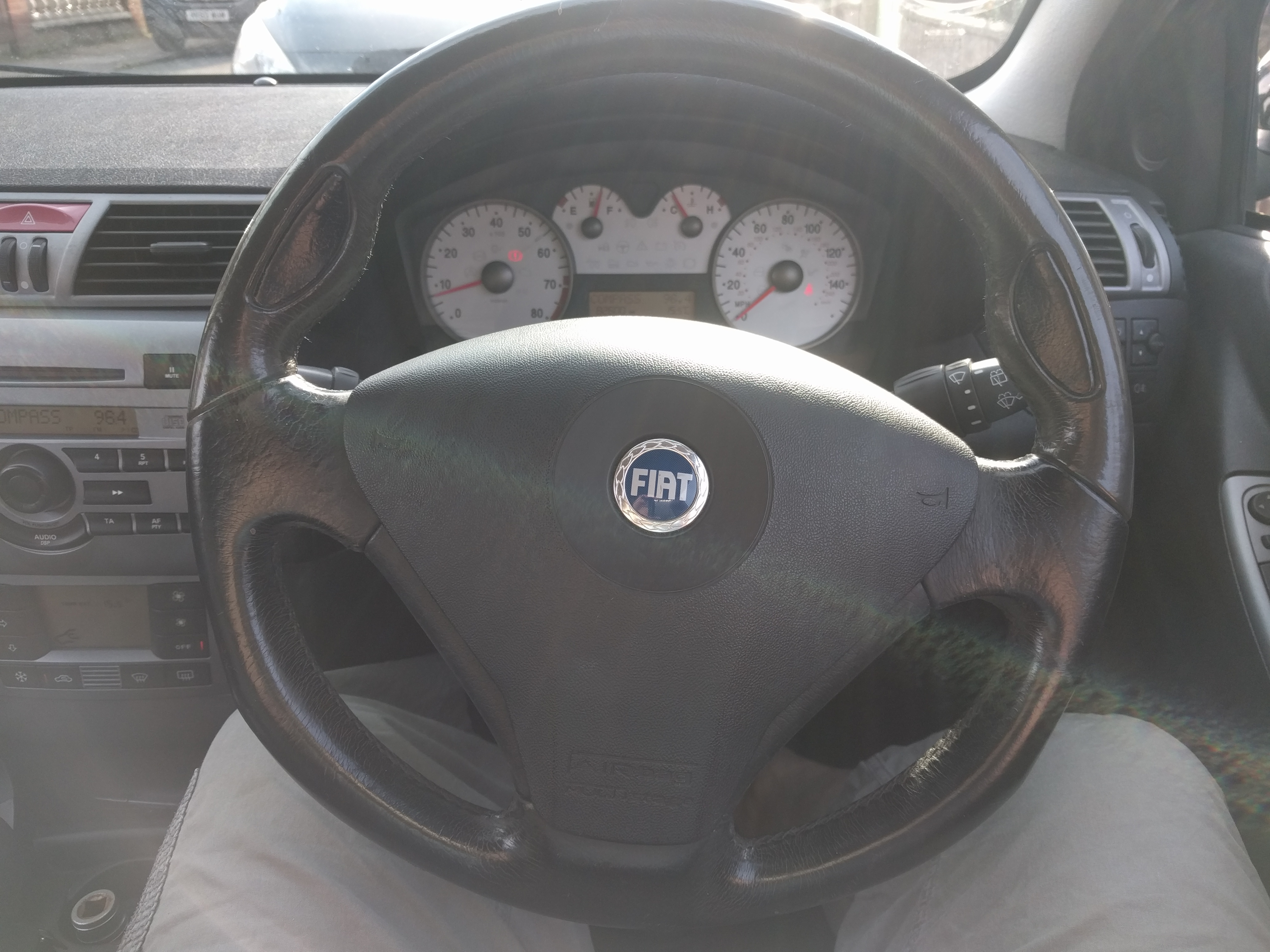

Also been a little naughty, as I had a spare 15 mins this afternoon, so I popped on the sport steering wheel. Did it without disconnecting the battery too - living on the edge!

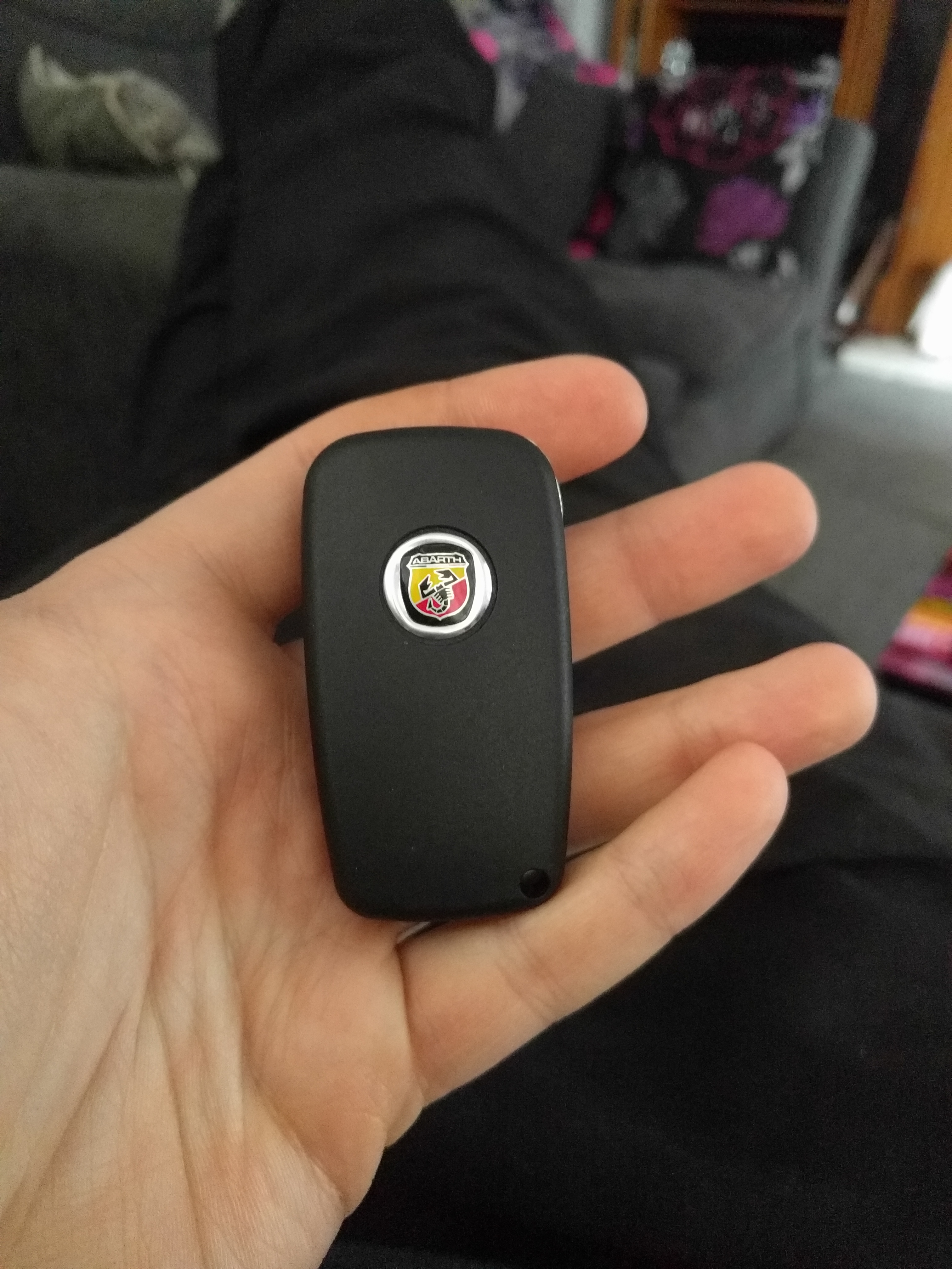

Whilst giving the Abarth some love I've just ordered her:
Key key fob case in black
two new key fob Abarth badges (to replace the Fiat one, seeing as I'm missing my badge anyway)
I've seen there's a guide to getting the wheel off, how tricky is it? From that point how much work would it be to get the indicator/wiper unit off?
I bought one because my indicator wouldn't stay on and I planned on replacing it, but it just turned out to be the rubber around the stalk bunching up and getting in the way.
I can live with it popped out but the new part isn't as worn and it has the cruise control stalk, so if it's not too much bother I might swap it out,.
I had the steering wheel changed in under 15 minutes start to finish. It's very simple.
Start the car - engine running......
pull the car forward or backward and rotate the steering wheel so that one of the 3 spokes of the steering wheel (at 3, 6, 9 o'clock on the wheel) are up at the 12 centre position - this gives you access to the bolt hole on the back of the wheel.
Undo the allen bolt that holds the airbag on the back of the wheel for the spoke in the 12 o'clock position.
Repeat for the other 2 bolts rotating the wheel to get the other spokes into the 12 o'clock position.
Keep the engine running and move the car back and forth whilst spinning the steering wheel so you don't static steer the car, which puts a lot of load on the steering and scrubs the tyres.
Once all 3 bolts are loose - note the don't actually come out the wheel, they just undo from the airbag, centre the wheel at the straight and level position. This isn't necessary as the steering column is keyed but it makes life easier.
Turn ignition off - quite important. Probably disconnect the battery if you're nervous around airbags. I didn't but hey... Never unplug an airbag with the ignition on as the system is live.
Disconnect the two airbag connectors - yellow and green for multi stage bag. Also unplug the little white plug on the wheel body for the horn.
You're then going to be presented with the nut that holds the wheel. It will probably have a little rubber boot on it too. Remove and undo.
Wheel should slip right off.
If you're going to be working further in the clock spring, apply a bit of duct tape or something to it now, so that it doesn't get knocked and spin off - this will upset the car. It lines up with a connector hole on the back of the wheel but if you knocked it and ended up 360 deg out or something it'd go bonkers.
For the clock spring - you're going to want to remove the steering column cowl as well. Thats I think 4 screws on the bottom half, which unclips and removes over the steering column adjust lever. There is I think 4 more screws on the top half to locate. 2 of them are quite well hidden under what would have been the base of the steering wheel - which you've now removed. That should then unclip and pull away.
Check out the guide for changing the instrument cluster for more detailed info on removing the column surround as it has to come out to pull the cluster.
Then you're down to the clock spring. I'd add that this point that I believe you need to hook the car up to diag to tell it that the clock spring has been changed, otherwise the ABS / ESR freaks out because it senses a steering angle and sends the system into meltdown.
I think - but am not 100% - the clock spring can be removed from the stalk set and then the stalk set is removed, but I've never gone as far as to remove these before, I've never had a need.
You might find if you remove the cowling you can re-seat and tidy up the rubber boot and solve your issue. Also cruise control I believe is a retro-fit item that can be done with just removing the cowling and plugging it in. Note that you will need a cruise control ready cowling or need to cut the existing cowling to accommodate the additional stalk. It shouldn't need coding either, just turning on although it might take a minute or two for the car to figure out what's happened.
Thanks man, didn't realise there'd be so much in it. Double checking the part I've got there's no clock spring on there (and because I bought it cheap I didn't check the part no. :bang:), so I might see if I can replace the stalks without getting into taking the whole unit out. Or, like you say, just fit the cruise control stalk. Been keeping an eye out for the replacement cowling for that, looks tricky to find.
Anyway, sorry to derail the thread, looking forward to seeing what you do next!
The yoke with the levers on it is a separate item than the clock spring. I changed mine to see if that solved a problem with the headlamp high-beams that turned out to be a Body Control Module issue.
Once you have the airbag off, the clock spring pieces just lift away from the yoke. I didn't take any special steps to hold mine together (in ignorance) and got away with it.. but it's a good tip to tape the beast together before you remove it, to stop it moving.
The reluctant indicators are more easily solved. Get a huge knife (I used a Stanley knife) and then pull off the rubber boot and "shave the side of the hole that is causing the stalk to pop back to centre. You can remove half a millimeter without any problems..
Replace the rubber boot (it will be looser.. but unless you removed too much plastic it will still remain in place) and Robert is your mother's brother.

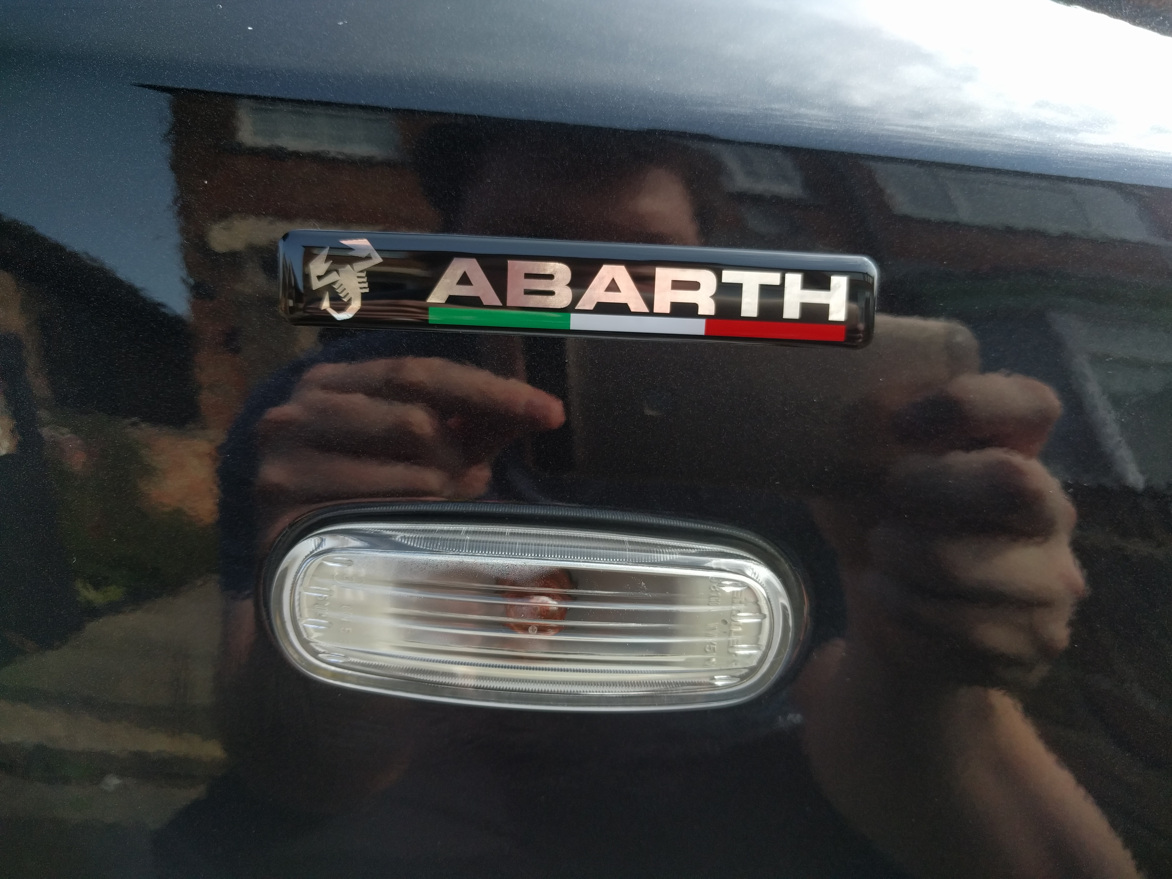

Pics attached are before I'd waxed it - needed to get the new Abarth wing badges on whilst the paint was still bare.
Like my new little Abarth badges.

New key fob case in black to match the car and the Fiat badge replaced with an Abarth badge - seeing as it's a Stilo Abarth.
Much smarter :)

The last of the new badges arrived and I fitted that after I gave the car a wash at the weekend. This was to replace the faded and damaged Abarth tailgate badge, so it's looking a lot healthier there now.

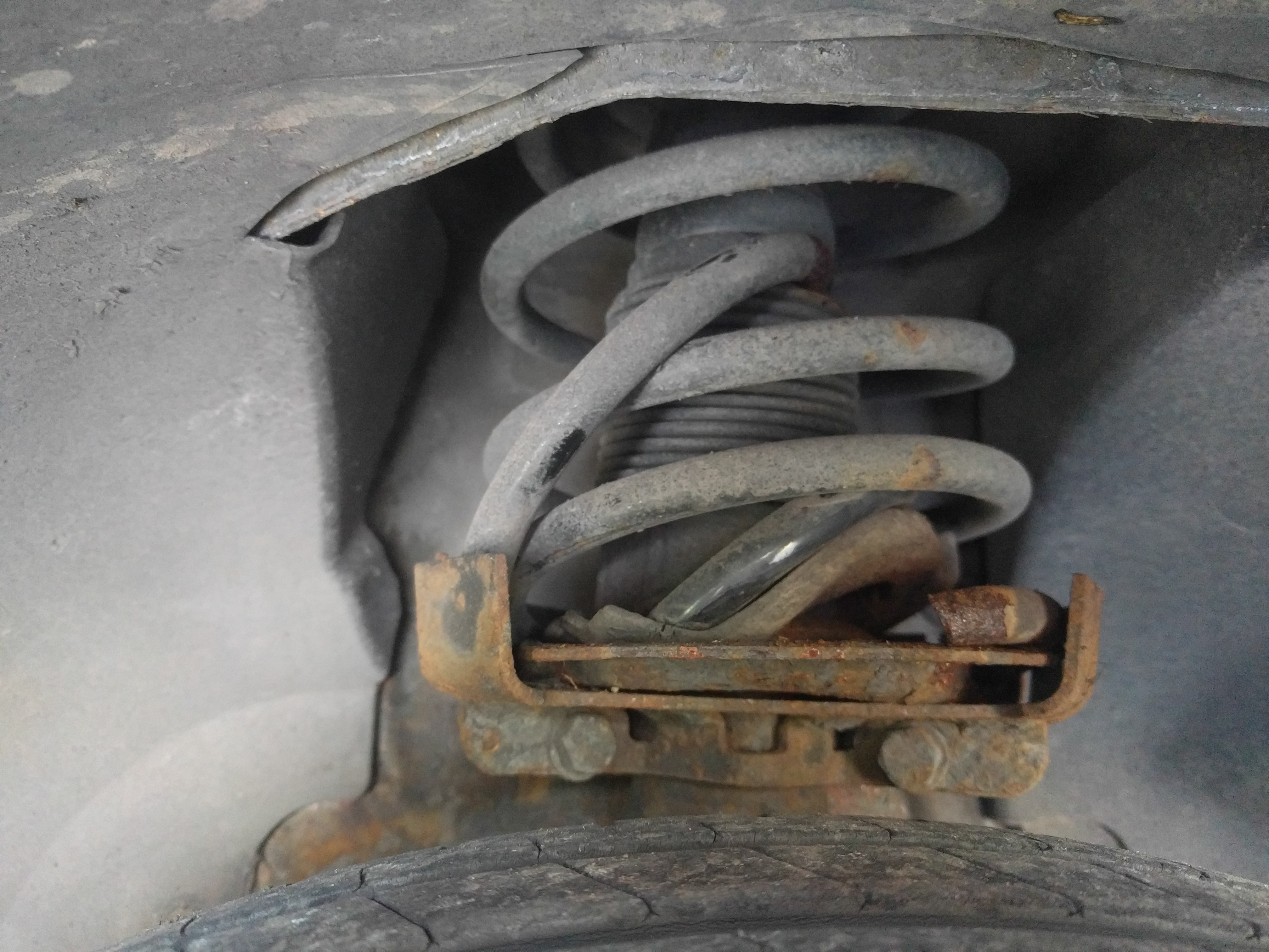

Lastly, the replacement front suspension arms and anti-roll bar links arrived yesterday ahead of my planned install over the long weekend - weather permitting.
I know the MOT is due before end of the month and I'm not particularly happy with the amount of noise coming in particular from the near side front, which I believe is just worn bushes. So will replace. After that it'll go in for MOT and see if anything else fails.

Well this was not what was required. Went to jack up the car this morning in order to get after changing the lower suspension arm and I spotted this. Think something might be wrong.
