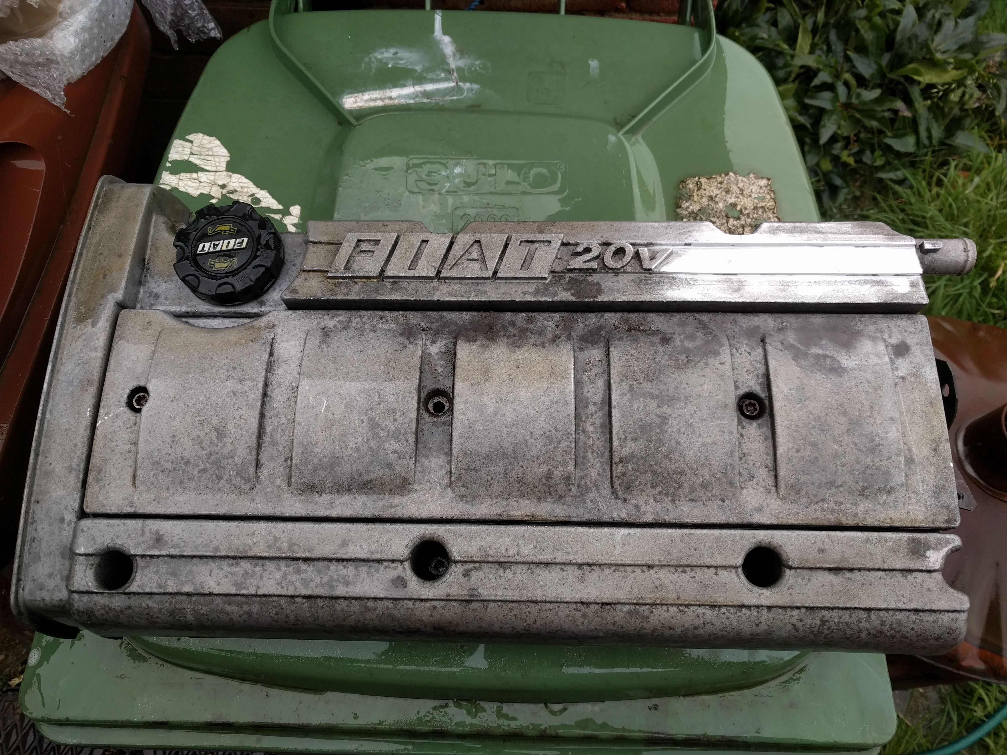

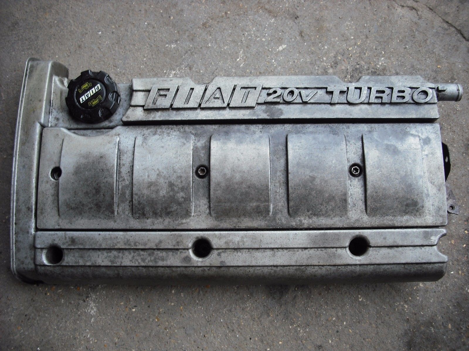

The second and somewhat more Stilo related matter is that I have acquired a Coupe 20vt rocker cover! Cost me £80 but as it turns out they're a bit difficult to get hold of. Anyone that has one on a breaker or whatever is adamant they're selling the engine hole and won't split, so I took what I could get. It is complete with decor panel and oil filler cap though, so it's not all bad....
The obvious elephant in the room is that it says TURBO on it in big letters and we all know my little Abarth isn't that.
Not really decided what I do about that yet. I could leave it, but that just feels misleading and silly. It'd look like i'm trying to portray her as something she isn't (turbo). I could get it machined out or attempt to do this myself with a grinder, file and sandpaper. The other thing to consider is covering it up, like putting an Abarth plaque over the top of it or something.
Waiting on delivery at the moment so it's something I'll be able to better gauge when I've got my grubby little mits on it but I'll have to have a think... I like the idea of machining it out at the minute provided I can get it done at a reasonable cost. that's assuming there is enough material there to machine it without getting too thin or risk cracking / breaking it.
That makes 2 of us. ;) I've never liked stickers, badges, labels etc. that try to portray a car that something it isn't.
Could try filling the lettering with one of the metal fillers. Searching " Liquid Metal " gives numerous options that you could research to check adhesion and temperature capabilities.

Bearing in mind how soft it will be I would file it off, sliding scale, grinder, file, wet and dry depending on bravery but I think it could easily be deleted and finish with a rough grade paper, time will then blend it ian sure.

Yeh it'll be easier to figure it all out when I've got it in front of my.
My wife's best friend's father is an engineering tutor at a local college, so has infinite access to a very well equipped machine shop. I'm currently in opening discussion with him about getting it machined out.
It doesn't have to be a superb finish as the plan is probably to have to crinkle painted anyway, so by the time you've sanded out any light machining marks then the paint should cover it nicely.
What is striking me at the moment is just how hard it is to get hold of yellow crinkle / wrinkle paint.
Might have to go with blue - which is at least a fiat colour, even if I can't get the Abarth yellow. Kinda don't want to go red, coz that's what everyone does.

I also got my rocker cover, freshly machined and looking lovely, back from my friend too. Need to order up the paint and gasket for this too.
