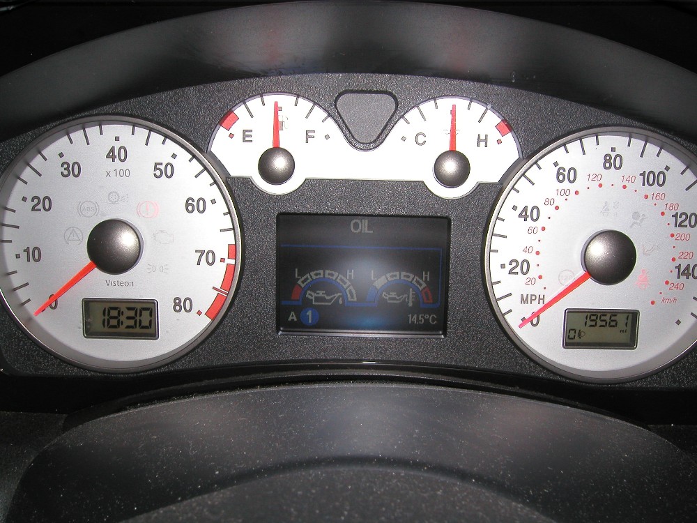

Yeah.... as you know, the oil pressure and temperature gauges only show low to high, no numeric graduations. Out of interest, how do you get the gauges to appear? Do they pop up by themselves when there's a problem, or can you make them appear whenever you want to?

I don't recall there being any L and H markings on the gauges but then maybe I was just distracted by the shininess of it all.
It's interesting because your pressure gauge there seems to only show 1 bar if you like, where mine was always showing full / H.
My temp gauge on the other hand was just always showing L, so I'm wondering if I even have an oil temp sender or if it's working. Need to check MES to see if it's a parameter I can look at on there. It would stand to reason though that a turbo diesel should get it's oil hotter running through a turbo.
I could get the gauges to display, yes. The only way I could do it was to go and turn the audio off in the menu (or have radio off) then it would drop back to the gauges. Otherwise I just get the CD track number being displayed unless i use one of the trip meters.
The picture is not my cluster, it's just a picture I found to show the gauges. Don't think this one is showing any oil pressure, the engine is off (0 rpm).

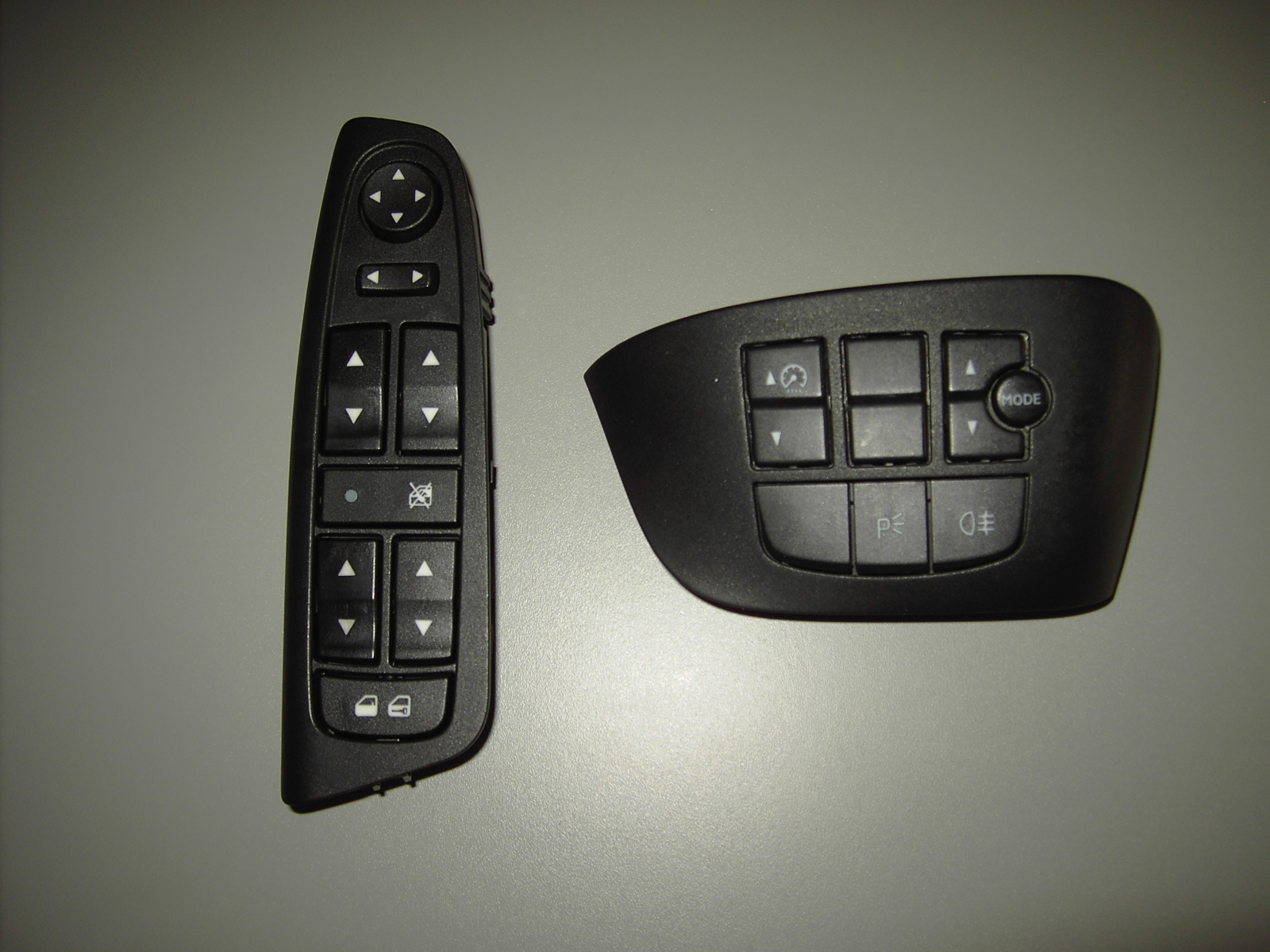

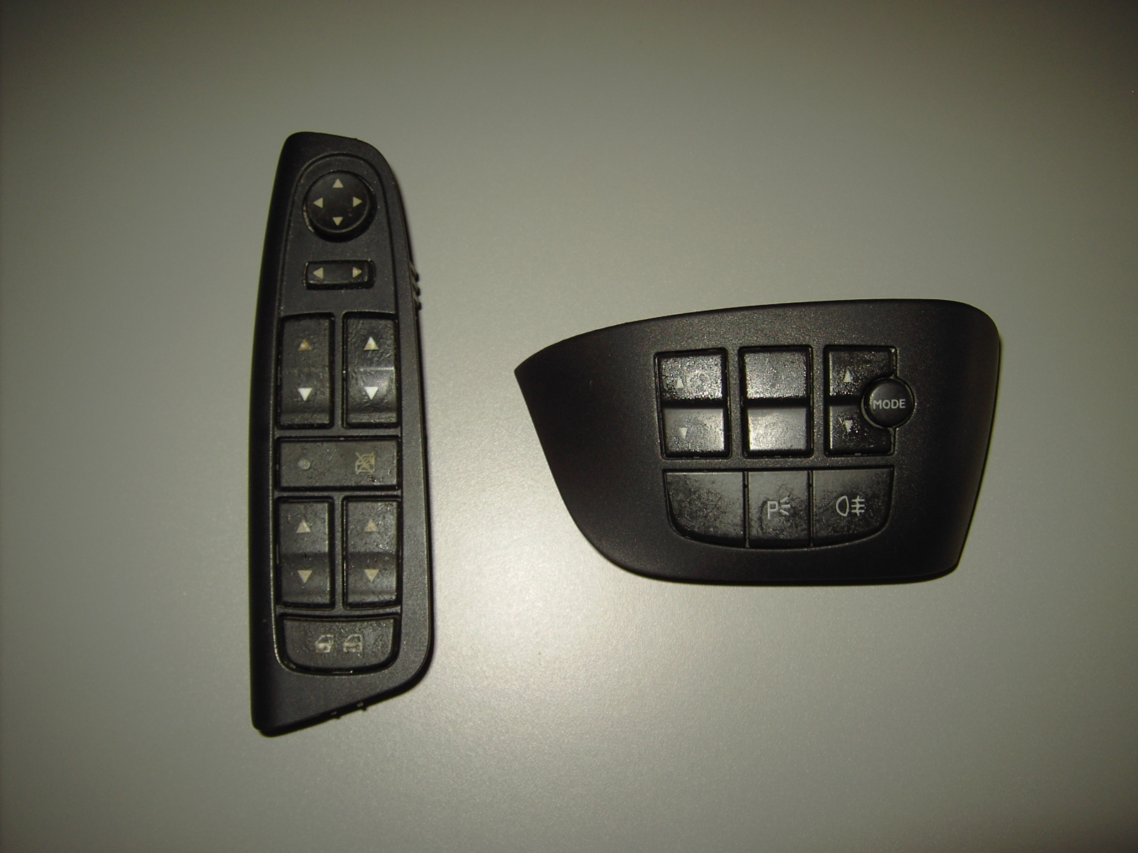

Also agreed a good price on some other little bits. Managed to get some replacements for a lot of my switch gear. The Abarth switch gear is all covered in this horrible soft touch coating - which breaks down over time and looks hideous. His car's switches didn't have this soft touch stuff, so I'll replace them all to look much tidier.

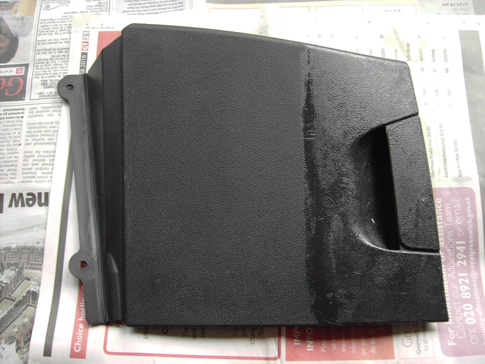

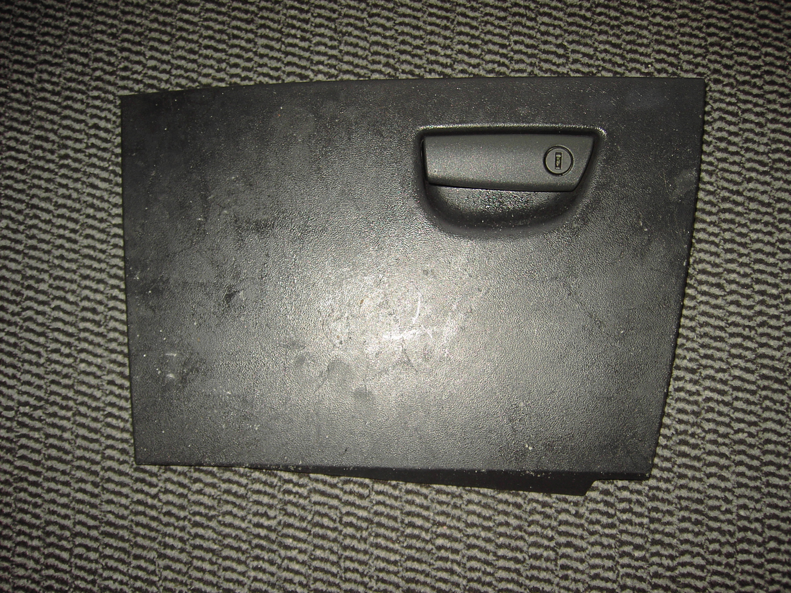

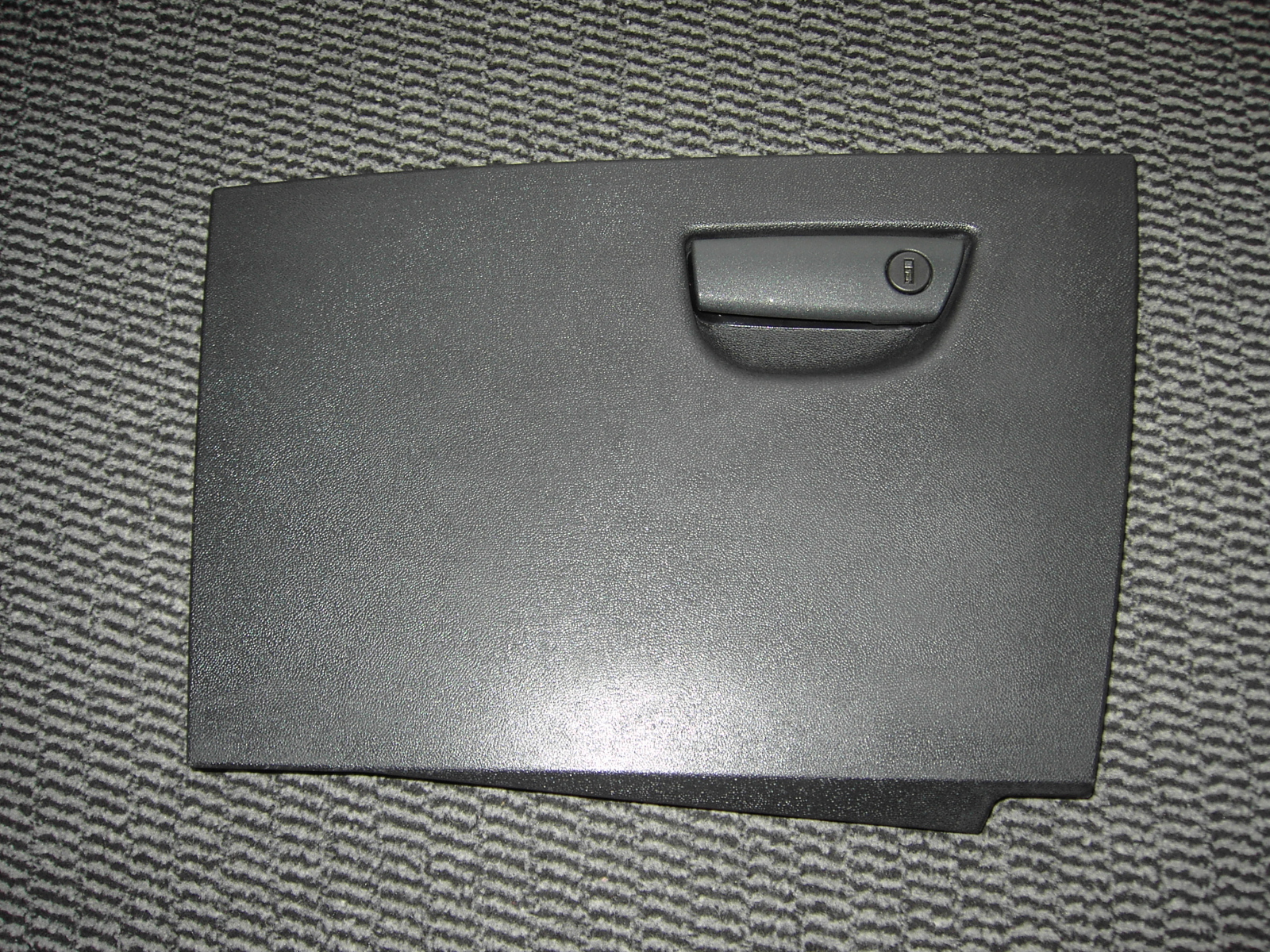

I had that sticky rubberised coating on all of my switches, and the lower glove box and fuse box lids. Tried numerous different chemicals to clean them, but nothing worked. Then discovered Biostrip Artex stripper. Dismantled the parts and brushed it on; left it about 20 minutes then scrapped a washed it off.

Good stuff, i don't think my stilo has this stuff on the buttons and trim, my old 1.2 did have it and its nasty stuff!left my window open one night and it it rained... they all everything that had that crap on went white and tacky :(.
Awesome top tip mate, cheers. The ASR etc buttons on centre console are looking ropey still the rest is OK or have been replaced now. I might have to give this stuff a try!

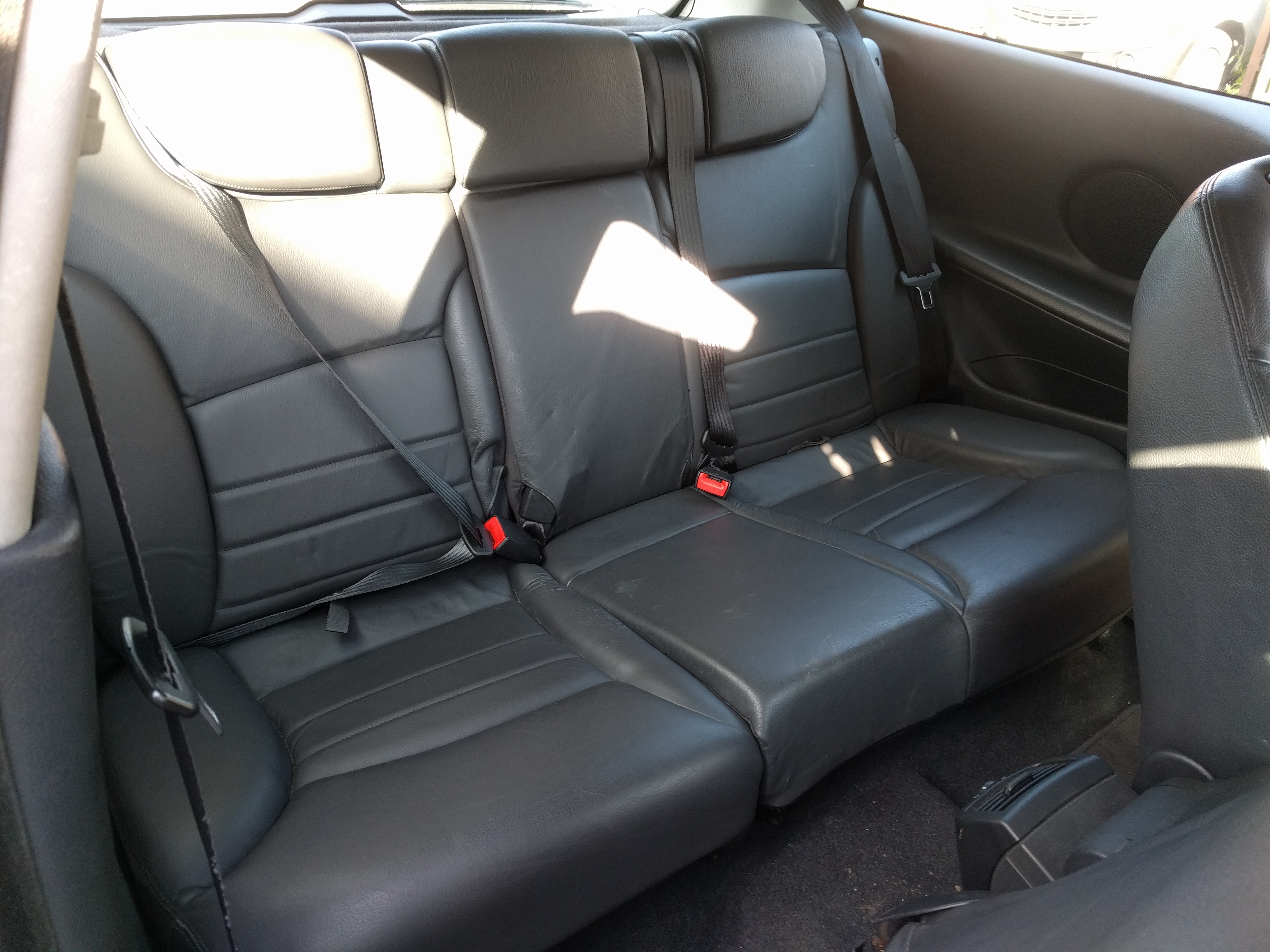

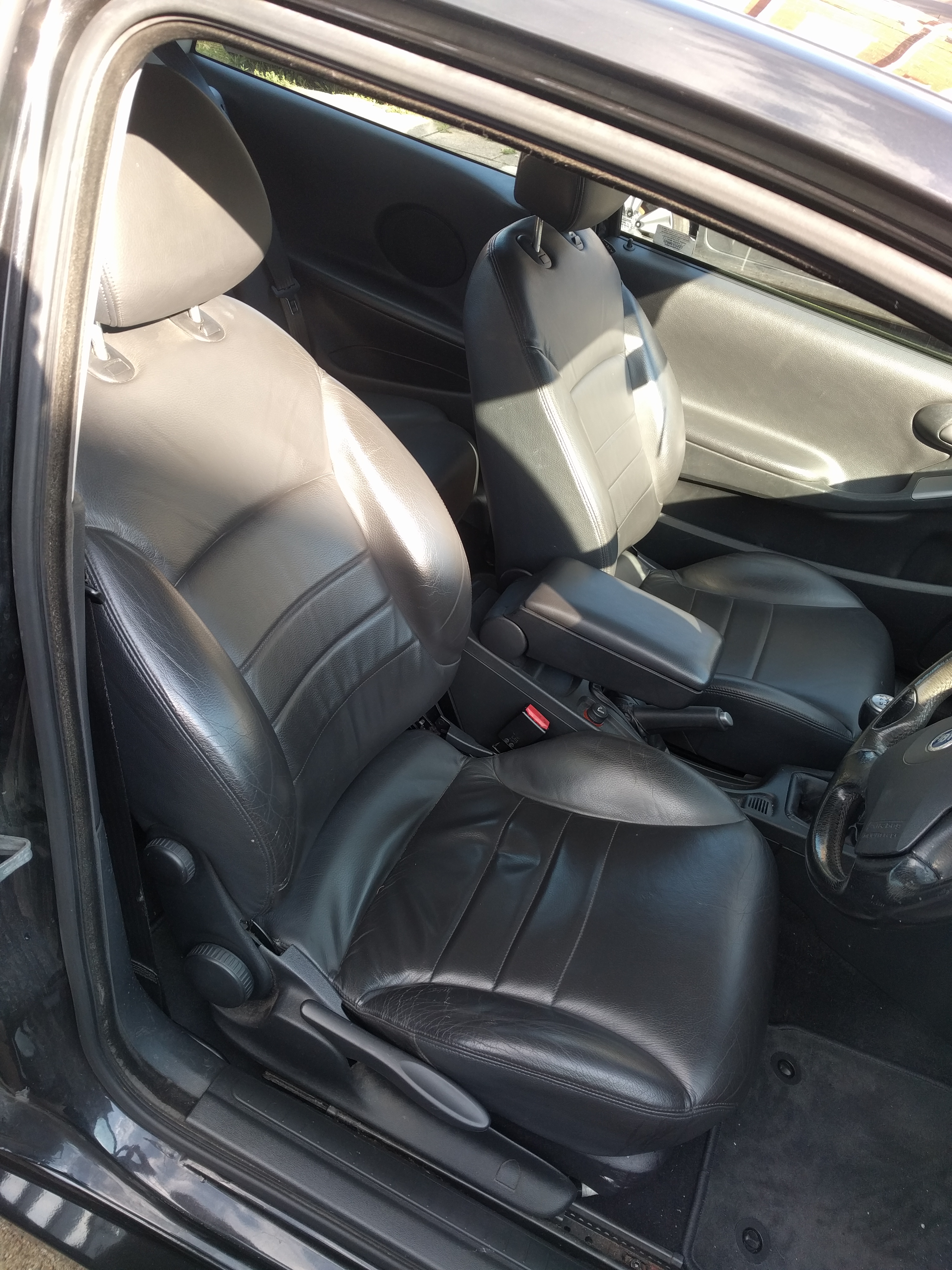

Finally got round to taking a couple of pictures of the leather install. Still needs a proper clean and feed but it's either been chucking it down or baking sunshine - can't clean them effectively when they're too hot they dry too quick and it just makes it worse!"

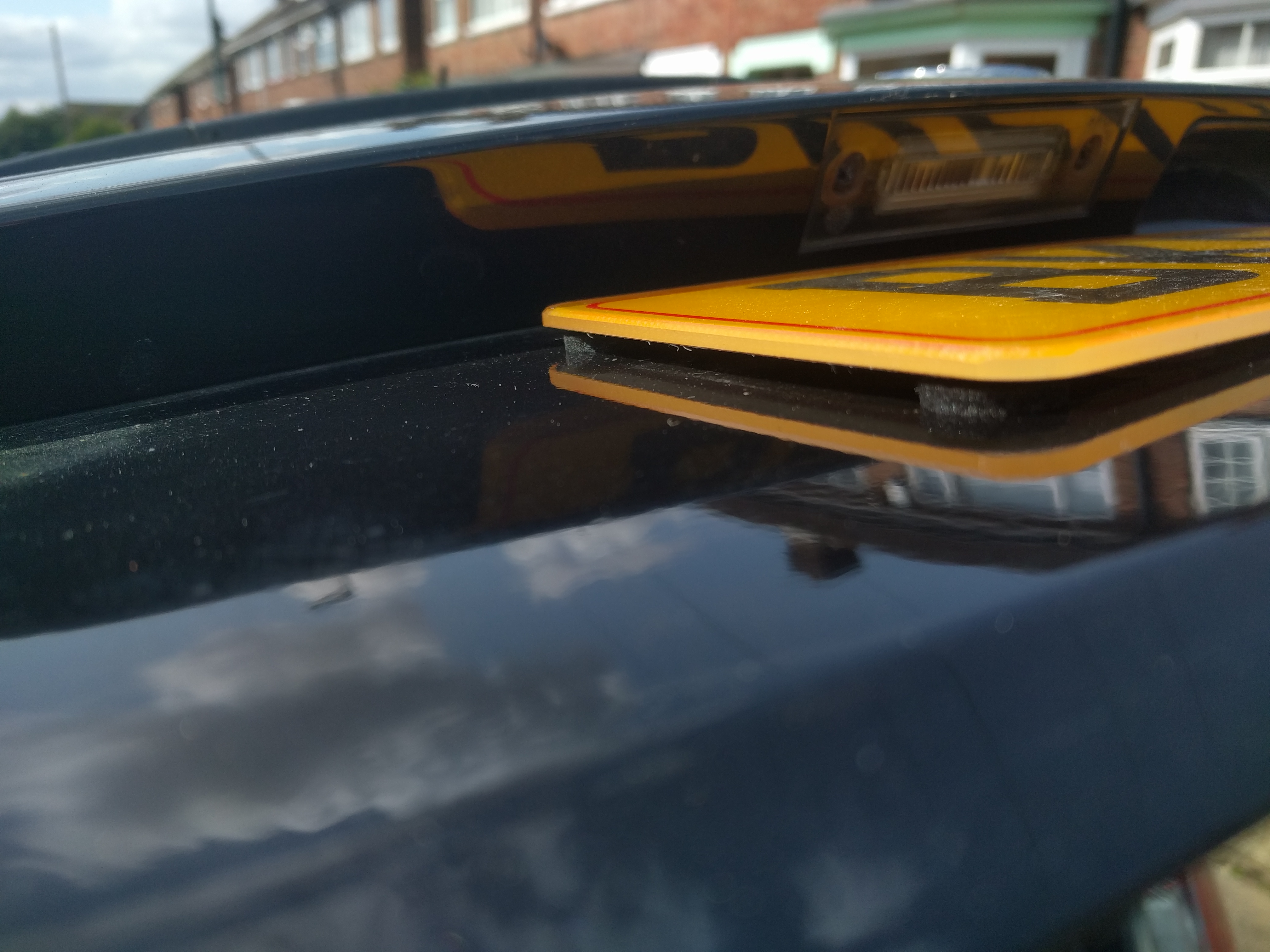

For a while now the rear number plate had been bothering me because at it's very extremes it was a little loose, so when closing the boot particularly would make a nasty rattling plastic on metal horrible noise. Made the car sound cheap and nasty when closing the boot. OCD I know....
So whilst in tesco on sunday I saw some little sticky fuzzy felt discs, like you're supposed to stick on the feet of wooden furniture to stop them damaging your hard floors at home.
I've stuck one of them under each corner and now, no more cheap rattle noise when you shut the boot. Hurrah!

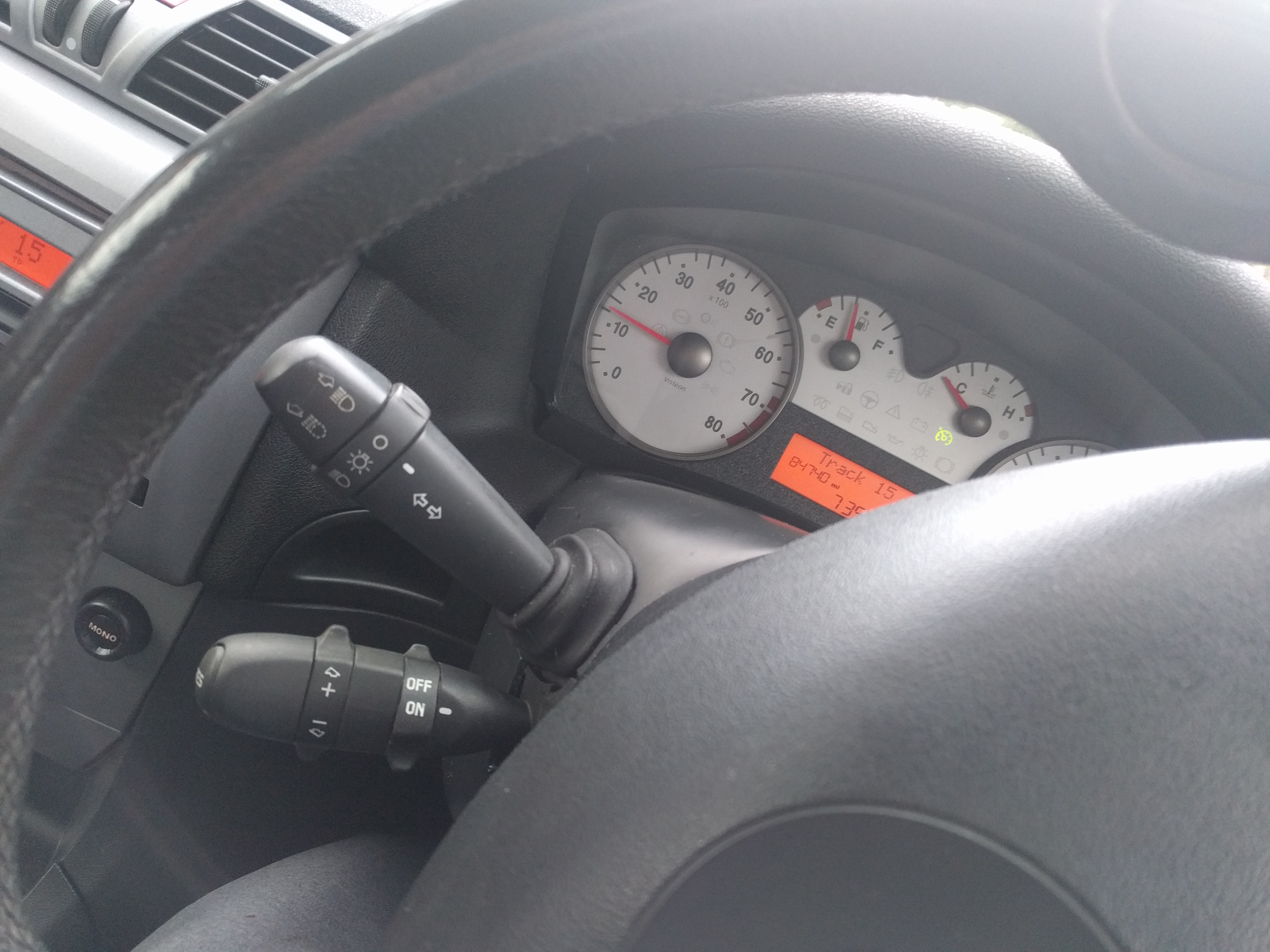

I'd mentioned elsewhere that it was my intention to get cruise control sorted this month.
I already knew I had the plug on the harness in the steering cowl, so was just a case of adding a cruise control stalk.
Acquired a stalk off an Alfa GT (147) and fitted that. Annoyingly it didn't come with the screws to fit, so it's just clipped in place at the minute. It's sturdy enough mind but still, would like the correct screws it secure it if I can find.
Still it's done!
