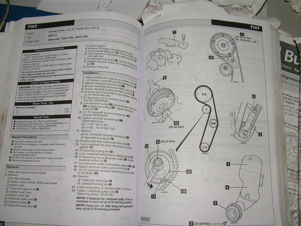

Can anybody share the timing belt replacement schedule for 1.4 evo engine. My car is 12 years young and has done 89000 miles. Now seems like an oil leak from the timing side. Planning to get it done along with timing belt replacement too. Any idea what will be the approx expense in UK?
Thanks in advance.
