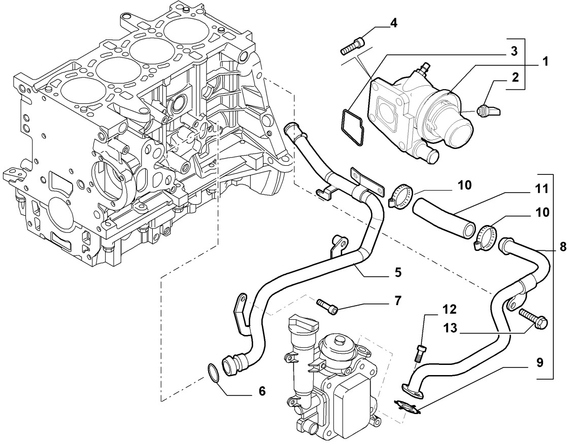

Hi gang,
My heater is at best blowing out warm air even after a good run and temp needle is normal.
My guess is the thermostat but can anyone tell me where it is located and is this a DIY job please?
Thanks in advance Noony
Thermostat is "1" in the above picture, it's on the gearbox side of the engine. I've never done one on a 1.3, but I have on the 1.1 and 1.4 petrol engines and it's an easy DIY job. Have a look through the guides section for a thermostat replacement, the principle is the same regardless of what engine it's for.
